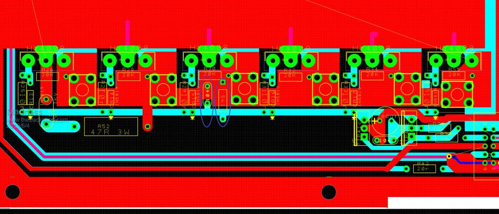

  johnmc said   Good day
The Madness 2018 power PCB I have, has 10R for the gate 20K for the gate to source
and no 104 cap. Is there multiple types of Madness power boards?
cheers john
Gidday John,
Only 2 types, the baby 4KW version and the 8KW. The 8KW as you have has 104 caps on the low side and 5K1 between the source and gate drive on high and low side before it goes through the 10R gate resistors.
This image is from a later version that I have not had made yet, the main difference is screw terminals for the negative input. The components are the same and in the same positions, I still have a number of the current version so won't be getting this new version for a while yet.

Thanks Madness
Found the 104 cap and 5K1 resistor

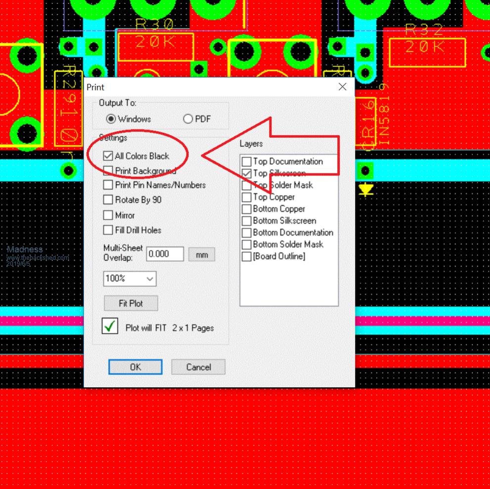

Hi Gary, how do you get that .gif image from your PCB layout program? I have tried to get a colour version of my PCB's printed from Design Spark but so far managed only B&W pictures which are useless.
Thanks.
Thanks.
The photo above was a screenshot that I cropped. You can print in colour by unticking the print setting that says print all colours Black.

Posted: 10:29am 05 Jun 2019
Thanks Gary, found that page, changed it to your settings and it worked a treat

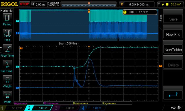

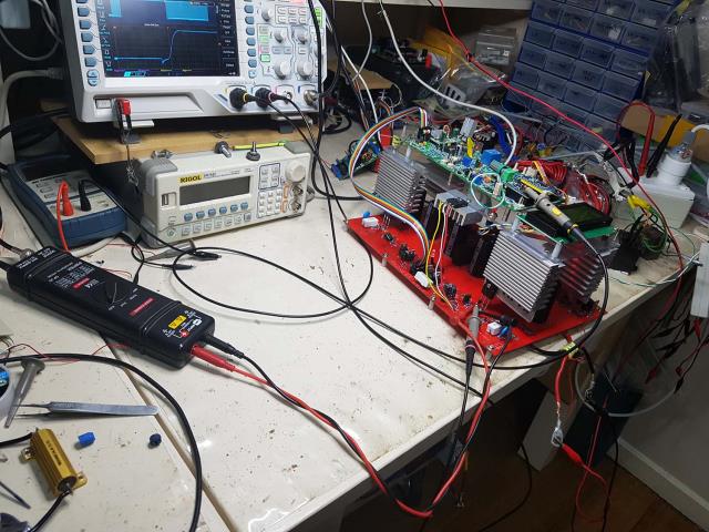

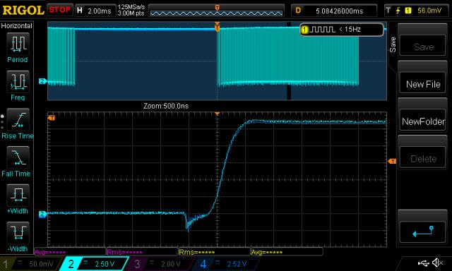

I just had a look at the high side gate voltage and current, in the middle of the 1/2 cycle, maybe about 5ms in from zero crossing.
I have approx. 0.4uH ferrite beads on the gate pins of both low and high side MOSFETS.
Other than that it is the normal test conditions (27.5V DC supply, 50uH choke, small toroid, "10" uF cap which is actually 6uF)
The power board is Madness' board, with one HY4008 fitted at each leg of the full bridge. 10R gate resistors, totem pole drive, 5KR gate to Source pulldown resistors.

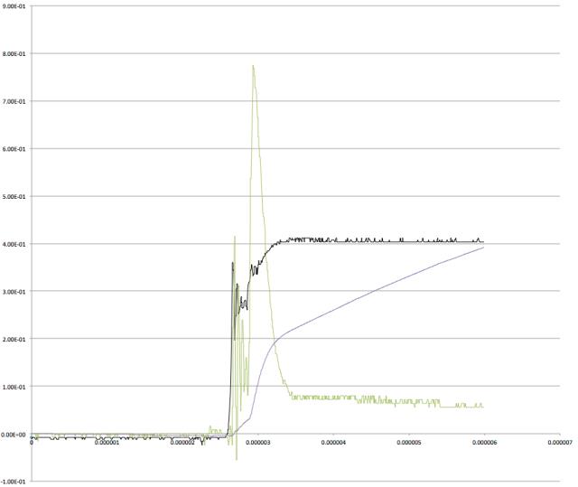

First, the DSO saw this:
Light Blue is Gate Voltage, DC coupled and referenced to DC ground.
Dark Blue is Gate resistor current (the voltage across the 10R resistor)
And we see non-optimal switching, with some oscillation.

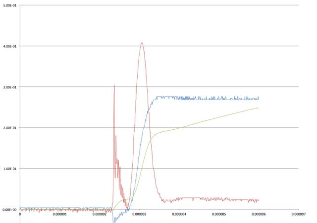

I obtained the values of this DSO capture and after a bit of Excel goodness
we have:
Black is Gate Voltage, Light Green is current and Grey is accumulated Charge
The left hand scale is correct for current, the peak is nearly 0.8A, and it's scaled for charge, 0.4 = 400nC
The time scale is in seconds, each marker = 1 uS.
The switch event starts at 2.5uS and is all over at about 3.2uS.
So it seems the HY4008 total Gate charge (190nC from the specs.) is achieved well after the oscillations.
2019-06-05_205516_NewFile1.xls.zip
Here is the low side switch event at about the same time in the 1/2 wave (5mS)
Note the lower current.
and
(different colours but we can deal with that..)
2019-06-05_211857_NewFile2.xls.zip
It looks rather different, don't you think?
The gate voltage clearly starts at some negative value (good, I like that for shoot through control) and powers up about as fast as the high side.
Fuel for discussion.
And this is by no means a critique of Madness' power board. I think it's a great board and I am likely to power my home by it in the near future. The ferrite beads are not part of the specified build and are simply present at this moment in time.
I am exploring the effect of things I can do to the board.
Edited by poida 2019-06-06

Good work Poida, want to make sure I understand this setup.
Are the 0.4uH ferrite beads discussed here used in a normally configured Madness board or is this something recently added to the gates for evaluation ?
If recently added, are there wave-forms minus beads which hopefully you could probably point me to them from a previous post somewhere ?
Can you also confirm that there are no beads for these scope shots on the Drains ?
The red spike at the beginning of the second graph is a surprise - havent figured out what is causing that yet. I assume it coincides with the turn off of the upper side FET ?
Cheers Mike

Mike, the test used the ferrite beads, placed on both low and high side gates. They are not part of Madness's build.
Tonight I will do the same tests with no beads fitted. If I recall, the beads of this size don't do much in this situation.
And I will replace the larger beads on the Drains of both high and low side which gave me the cleanest switching to see how the current looks.
In both cases I will include both gate voltages, so as to show if one (voltage) is effecting the other's current.

Before you do the new tests can I ask for another test in its current setup please?
As per the last graph, trigger off anything - but not the red trace, to get about the same picture.
Then place both ends of the differential probe onto each end of the gate resistor at the same time in turn (input to diff probe shorted) - I believe that is where you took the trace from.
I would not be surprised to see some/all of that glitch still there. It wouldn't be the first time I have gone chasing something that wasn't really there and was a measuring technique issue.
It will be great not to see it still there though, as it means the probe rejects the common mode noise very well and we are looking for something that is real!Edited by wiseguy 2019-06-07
Cheers Mike

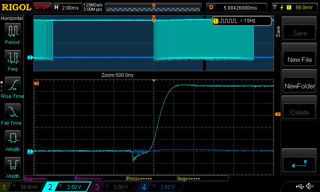

poida
Joined: 02/02/2017
Posts: 1515
Posted: 08:38am 06 Jun 2019

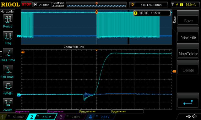

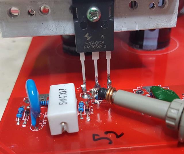

Wiseguy, here are a few DSO captures.
Light Blue is low side gate voltage.
I obtain this with probe technique using a 1cm wire soldered to the gate end of the 10R resistor, and another 1cm wire, soldered on the DC ground lead of the 5KR pull down resistor with a coil. I push the probe into the coil, and the probe tip goes into a tiny ring on the end of the gate wire.
This gives me high quality signals which I accord a lot of confidence that they mean
something.
The diff. probe technique is very, very dodgy.

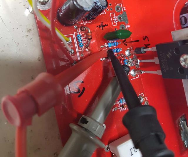

and the common mode test you wanted
But the results speak for themselves.

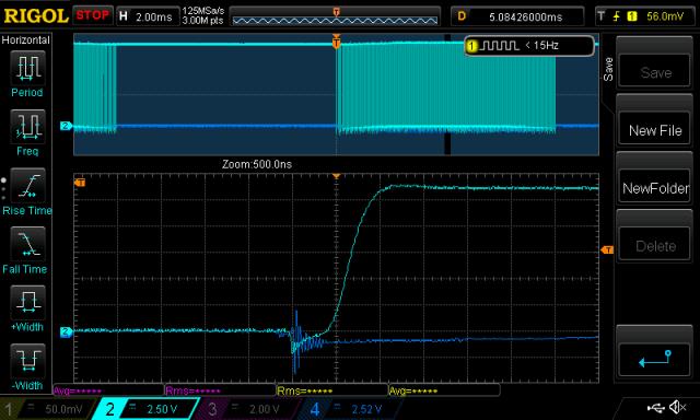

Dark Blue is from the Pintek DP-25, at 20x.
Here are the two samples, one from both clips on one end of the 10R
and the next with both clips on the other end.
and
Here I show the proper gate voltage, with good probe tech, on top of
that which I get from the differential probe with the clips on each of the 2 wires
There are differences but it's not too bad.
For sure there will be EMI everywhere.
I try to concentrate on the gross issues and I feel I can easily reproduce them
upon request.

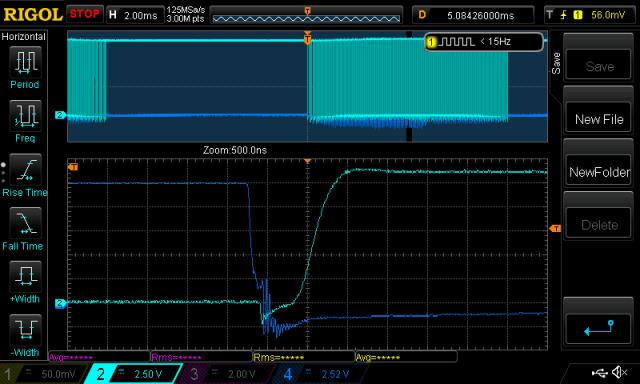

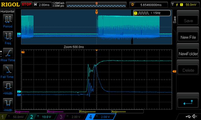

Lastly, here is the low and high side gate voltages, to show the high side's behavior during that curious negative dip in the low side Vgs.
Dark Blue is high side, Light Blue is low side.
All high side measurements use the DP-25.
This is the same thing but with both high side leads shorted on the gate end of the 10R resistor.
I suspect better results could be obtained from the DP-25 with a custom shielded probe built from a cheap CRO 10x probe and 2 banana plugs. Twisting the two leads together helps a bit, but things could be better.
Edited by poida 2019-06-07
Posted: 11:14am 06 Jun 2019
