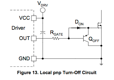

Did you see my post about the local pnp turn off circuit,  really good for dv/dt induced turn on.. the app note puts it best, but can be easily implemented on the ozinverter/madinverter boards..

  noneyabussiness said  Did you see my post about the local pnp turn off circuit,  really good for dv/dt induced turn on.. the app note puts it best, but can be easily implemented on the ozinverter/madinverter boards..
No, don't think I saw it. Can you point me to it please?
noneyabussiness
Joined: 31/07/2017
Posts: 527
Posted: 09:07am 17 Oct 2019
Ok , pics are not working for me for some reason,  its figure 13 on Texas Instruments app note SLUA618A... it will pull down individual mosfets to ground AT the source pin, so as to avoid the driver to mosfet gate inductance... just a thought...
I think it works !!

I think I will try this and report back the before/after.

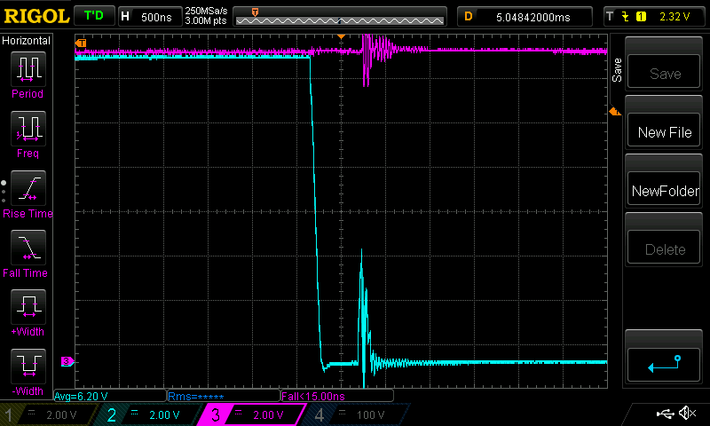

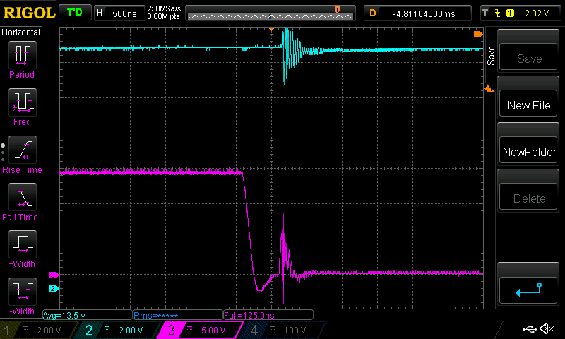

ok, here is what I get.
I am now using the powerjack power board, with custom modules for each of the 4 legs of the bridge. Thanks kentfielddude for making these available and Ben & Amber for sending me some of the small boards.
The test situation is:
a powerjack power board, driven by a nanoverter, with the IR21844 gate drive IC.
On one 1/2 of the bridge, we have 4.7R gate resistors, with 20K pulldowns.
One HY4008 per leg of the bridge.
All 4 legs have a 220R and 104 monolithic cap snubber.
The test 1/2 of the bridge has the modified low side with a PNP turn-off, and a normal high side (4/7R gate and 20K pulldown)
All this into my standard transformer and load.
I have the capability to see what "normal" is and what "the test condition" is, side by side.
In the following, Pink is the test condition, i.e. PNP pulldown
and light Blue is "normal", i.e. 4.7R gate and 20 K pulldown.
We only look at the gate voltages about in the middle of a 1/2 sine wave.
(one 1/2 sine wave is active while the other is just pulling current to DC ground.
So the test 1/2 bridge is active for one 1/2 sine wave, then the "normal" 1/2 bridge is active. It's a convenient test setup)
Here is the normal 1/2 bridge, under 200W load.
There is some shoot through and the low side gate is pulled up into conduction.
And when this happens, all hell breaks loose and we have oscillation and coupled responses of various components.
Now look at the PNP turn-off low side gate.
Less ugliness but not great. I would call it an improvement.

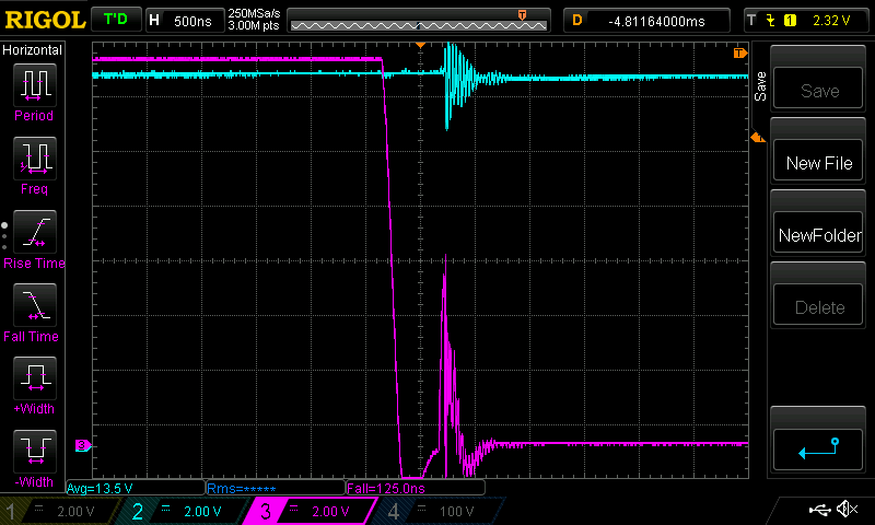

In this test case, I want to bring to our attention what I see as a primary issue
that needs to be looked at:
Out of specification gate drive output voltage levels.
The IR21844 along with many other gate drive chips does not allow it's output
to go below ground by much more than about -0.3V
This is where the output drive stage of the IC will start to have a very bad day and just short to ground or Vcc or something.
Here is clear evidence that the low side MOSFETs are pulling the IC gate drive outputs below -0.3V, in this case well below, down to about -2.5V
I can not expect an inverter to run for long when this is happening.
(of course, I need to carefully verify this by probing AT THE IC PINS with good
probe technique. I have done this in the past and seen insignificant variation from what I probe and measure at the MOSFET Gate and Source pins. There is a difference, but not much. So what we see here is close to what the IC output pins see.)
Pink is "normal" 1/2 bridge low side gate voltage.
So, when does the low side gate get this unwanted pulse of voltage?

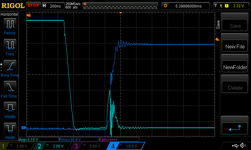

When the low side MOSFET Drain rises very quickly, that is, when the high side gate switches ON and pulls the low side Drain (and high side Source) up to DC supply voltage.
Lastly here is a capture of the low side gate voltage and the low side Drain voltage.
We can see that the gate voltage pulse occurs when the Drain rises a large amount quickly.
Light Blue is the modified (PNP turn off) low side gate voltage
Dark Blue is the Drain voltage, driven by when the high side MOSFET switches on.
The low side gate pulse coincides exactly with the rapid voltage rise due to the high side switch ON.

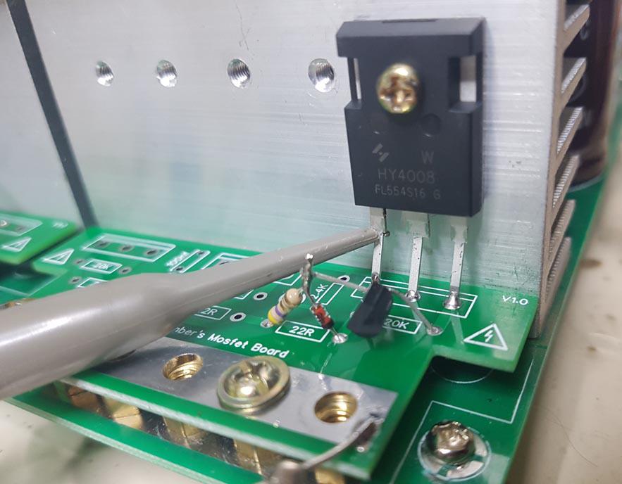

Here is the test setup, for the low side PNP turn off design.
I used a BC557 PNP transistor. No idea if it's good enough for the test or not.

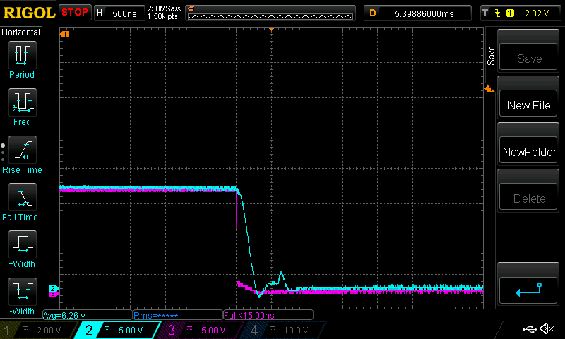

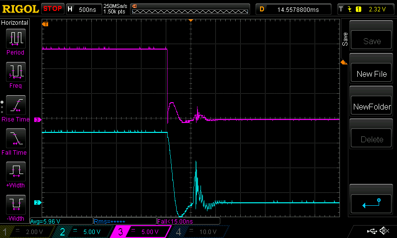

further to the problem of negative gate voltages appearing at the gate drive IC output pins:
This is a capture of the low side gate voltage (Light Blue)
and the gate drive IC output (Purple)
when using a Madness power board with it's totem pole transistor gate drive.
This is about the same position in the 1/2 wave output.
what I see here is normal low side gate voltages, sometimes below zero, and always having some dv/dt or di/dt induced shoot through.
But, and this is most important in my view, there is little or no negative voltages brought back to the gate drive IC output pins.
This is a good result of the totem pole drive, which takes a signal but does not drive anything back along the signal path to the drive IC.
I like very much the performance of Madness's power board.
I think the very fast fall time of the gate drive IC output is due to it not having to drive a MOSFET. It drives instead the two base pins of the totem pole transistor circuit which probably has a quite low capacitance.
We can then see the gate voltage (the output of the totem pole drive) follow a slower path due to the capacitive loading due to the MOSFET's gates and the transistor's switching speeds.
Oh no. not again. I have made a mistake.
I said earlier that these negative voltages see their way back to the drive IC output pins.
No so.
Here it is and it's no problem.
Purple is IC output pin voltage.
Light Blue is low side gate voltage.
Nope, no problem at all.
It was a case of If I recall Incorrectly.....
Edited 2019-10-19 19:58 by poida

  poida said  Here is the test setup, for the low side PNP turn off design.
BC557 has a peak collector current of 200mA & continuous 100mA.
I always use the PN2907A for this, continuous collector current of 800mA @ only 3cents ea from E14. They perform well in this application. Note E & C Pin out is different (transposed)

Poida, try using a pnp with more current capability, you want to lower the impedance across the gate-source junction such that the gate voltage cannot increase. Keep the leads connecting to the mosfet really short eg 5mm.
As it is the dv/dt rise time of the upper mosfet causing this, have you tried increasing the gate resistor slightly of that mosfet; this will slow it down a bit, lowering the rate of voltage rise on the lower mosfet drain. Try 10R, I assume you are currently using something less than that.
The  220R and 104 monolithic cap snubber may not be the correct values for your setup, leave them off, measure the actual frequency of the oscillation and work out the correct values.
Mike
Posted: 10:28pm 19 Oct 2019
The 2N2907A is probably a pretty good choice for this. Its fast with a fairly high current rating, but the gain is not that high, and gain is going to fall even further at full rated current.
I still believe a high current mosfet driver such as the TC4452 would be a better choice than a bipolar transistor. Gate series resistor is a compromise between speed and excessive ringing. Layout is critical.
