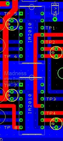

Can you get it running with 4 FETs, no caps, a series resistance and no load? When you do please post CRO shots of the 8 test points below. Ignore the IR2010 the pins are the same as IR2110.

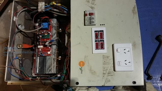

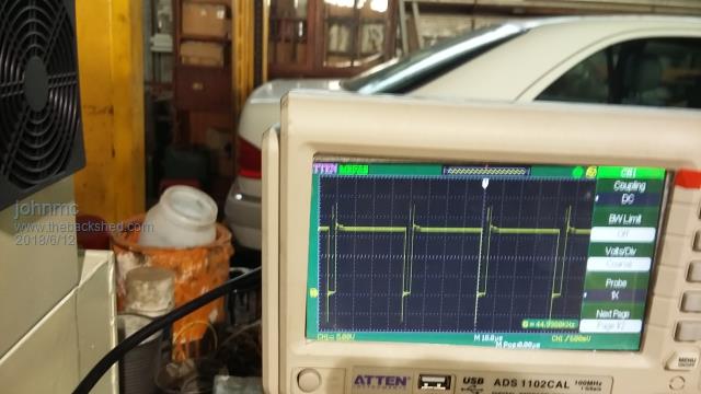

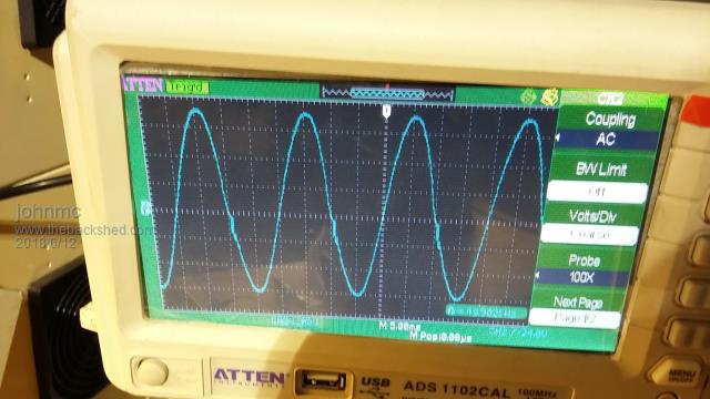

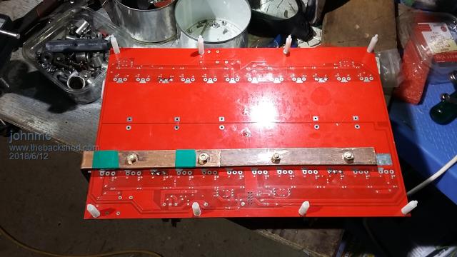

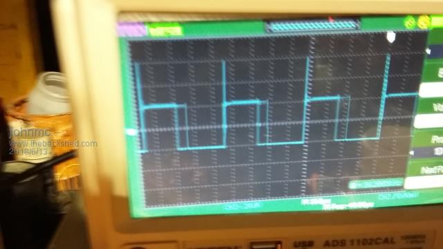

The latest inverter build with madness power and control boards with no large capacitor
The powerboard negative rail had copper bolt soldered to the PCB
The 23.5 khz signal has spike overshoot
Is this a product of my scope as it does not appear to affect the output sinewave?
The first build with madness new boards the power fets on the powerboard blew on startup.
the fault was, a dodgy transistors (locally expensive) in the totem pole .
NO damage to the control board
Replaced with cheap transistors
Await the dreaded startup with full complement of Fets and Capacitors
cheers john

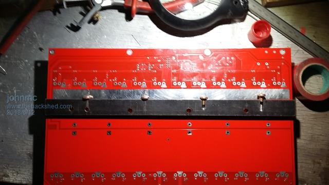

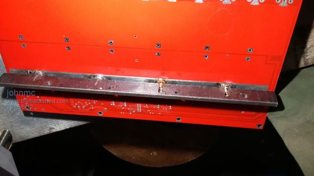

Posted: 01:05pm 12 Jun 2018
because of the history of Inverter blowups almost always on start up after overload or initial startup or the dreaded reset button.
I have tried to make removing the powerboard as simple as possible
All the connections to control and power board have been brought to the top for easy access
cheers john

If you test with no big capacitors and via a resistance (I use 2 33 Ohm 10W in parallel) you should be able to test with no blowups at all. The MOSFETs can't draw enough current to harm them with the resistance in series. I assemble the PCB initially with just 4 MOSFETs and not connected to the toroid and do a test of the signals then. After that I fit all the MOSFETs with heatsinks, still without the big caps and connect it to the toroid. You won't be able to get full AC volts but by adjusting it down the inverter will run via the resistance with no load. This gives you the chance to check the waveform is good without risk. Last few I have assembled worked right away, one from that last batch of PCBs that yours came from is running our house for a few weeks now. Those extra steps may take a bit extra time but I think a bit more time spent confirming everything right is better than having a blowup and going back to square one.
I know what you mean about bad components. A couple TIP42's I bought locally last year gave me trouble. I bought 100 MOSFET driver ICs recently and turns out they are all dead.

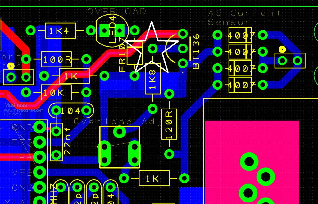

John, I have found a better way to reset the Inverter after an overload. Instead of grounding the 5W 120 Ohm resistor connect the wire to the 1K8 resistor as shown below. I have tested this when the Inverter is in overload state short this point to ground and the overload LED turns off and after 5 seconds the Inverter does a soft start. No need to turn off the power switch or anything else, just ground it as shown, the BT136 turns off, the EG8010 recognizes that the overload is gone and does a nice calm soft start. There should be no risk of a catastrophic blow up that a few of us have had doing a hard short. You can trigger an overload by connecting a 9V battery across the current transformer connector on the PCB if you want to test it.
Edited by Madness 2018-06-14

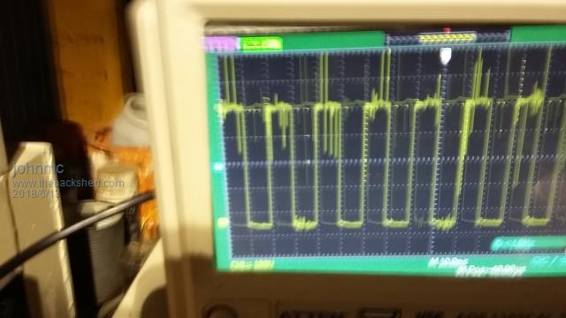

Test 6 all 24 FETS fitted no capacitors,
15 ohm resistor in series with 50 v battery supply
No toroid fitted in the following pictures,
Picture of powerboard low side Fet output
toroid low side Fet output
Picture of powerboard high side Fet output
Has any one taken pictures of the powerboard with no toroid as there stil appears to be too much hash and as I have now destroyed 170 Fets I am going to be more cautious .
