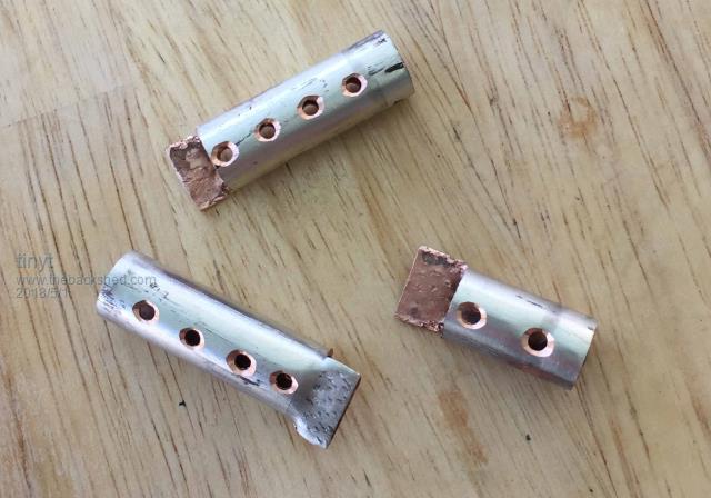

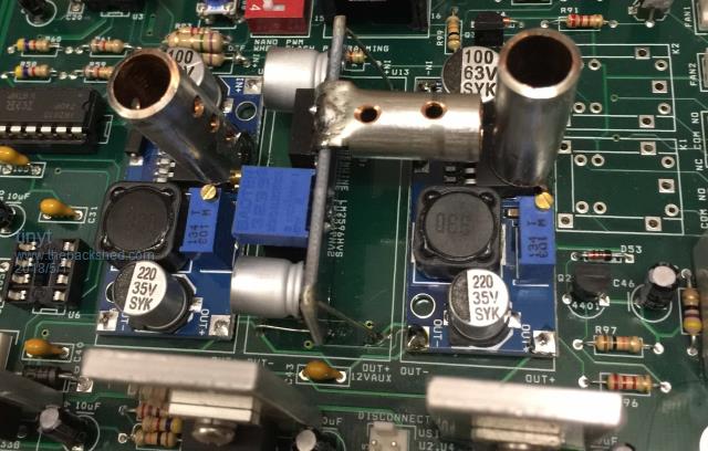

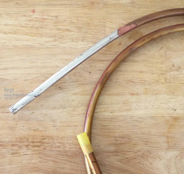

I finally finished the roof install of my solar panels. Now I can go back to the inverter. I found a leftover 3/8" dia. copper tubing for the DC-DC heatsink. I pre-tinned a section:
Then I fabricated the heatsinks.
And soldered them on the LM2596HVS tabs.
Again using a thermal probe on the hottest LM2596HVS, the temperature dropped by 10 deg. C. But when I get the better DC-DC converter that Madness found, I will replace the LM2596HVS pcbs with them.

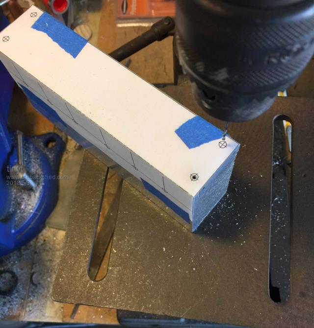

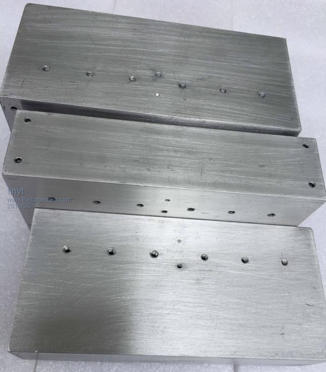

Worked on the heatsinks.
Drilled pilot holes first:
Then used correct size drill and then tapped the holes:

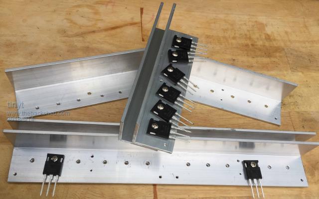

An alternative to buying or re-using real heatsink is to buy aluminum angle bar and fabricate it. This is 1.5" x 1.5" x .125" angle bar purchased from a local home buider store (Home Depot). I think it has enough mass to absorb the heat from the mosfets and enough surface area to dissipate to surrounding air.
I am going to try this first. If it is adequate enough, the re-design of the PCB will be smaller since I can move the heatsinks closer to the large capacitors.
Posted: 04:04pm 13 May 2018
tinyt, you run a risk with these angles in my experience. I have experimented with 2" x 2" x 0.25" alu angle at the beginning and still managed to blow Mosfets. These things have two *very* tiny (hair size) wires inside from the drain leg to the substrate.
There is no way these could carry the quoted amperage.
So, it is essential that any heat build up is prevented by *very* good heat sinking.
I use no insulating washers either for that reason.
Your angles might work for tiny loads, like a couple of hundred watts but if you plan to switch two or three kilowatts suddenly on you need a beefy heat sink with a large fin area and a thick base of at least 5/8" or better 3/8" thick.
Actually, you do *not* want the heat sinks close to the large capacitors, these capacitors live a lot longer running cool. I have mounted my capacitors on the opposite side of the PCB for that reason. This also made laying out the heavy current tracks easier.
Talk to your local solar installers and see if they have a junked grid tie inverter. You can salvage a very decent heat sink from even a small 1KW unit and a brilliant one from a 3KW inverter.

Thanks Klaus. I will try it on small loads then. What mosfet part numbers were you using during your experiment?

With no load at all you can run the inverter with no heatsinks at all. But this is only for initial testing and providing everything is running correctly, even leaving out the primary choke would cause overheating like this.
I agree with Klaus any decent load and you are going to have hot MOSFETs. You can try it with what you have there and see what happens. If you can gradually increase the load while monitoring the temperatures you will soon see what will happens.
The other heatsinks you have been working on will have probably close to 50 times the surface area.

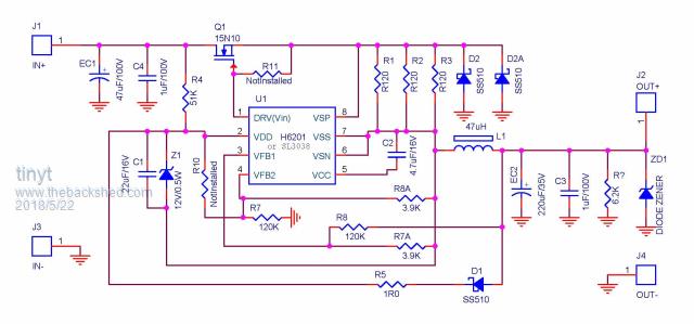

  Madness said   There is 5, 9 & 12V versions, I have ordered several voltages to compare for exactly that reason as I want 18V for driving MOSFETs.
A low cost isolated DC-DC converter would be good too but they seem to be very expensive.
Hi Madness,
I received my 4 pcs 12V units and the 8-pin IC has its markings scraped off on 3 of them. Maybe they forgot to do it on the fourth one. First line is marked SL3038 and second line is marked 1803 (maybe date code). Was not able to get SL3038 data sheet from the web.
Tested one with the power supply at 63V. No load output is 12.45VDC. When loaded with 3 fans, the output dropped to 12.19VDC. Current draw of the 3 fans is 0.63A (7.67 watts). Current draw from the power supply is 0.14A (8.82 watts). Touch temperature of components is just barely warm.
There are two resistors with silkscreen R7A and R8A. I assumed they are for output adjustment. Both of them are marked 3901 (3.9K ohms). I changed R7A to 2.0K and the output became 20VDC. I was happy.
Then I placed a 55 ohm load (about 0.36A or 7 watts). Monitored the output, turned on the 63V power supply. No smoke but the DMM showed some reading, I am guessing 20, then quickly settled to 6vdc. Power supply current display is zero or below its range. Maybe wrong hack. Going to sleep now, too tired from bathroom re-modeling.

  tinyt said   Thanks Klaus. I will try it on small loads then. What mosfet part numbers were you using during your experiment?
No problem. I use HY4008's.
As mentioned, these Mosfets have tiny internal connecting wires and cannot tolerate a marked temperature difference between its case and the heat sink. The wires evaporate and the case explodes. You guess how I know that .
Any heat needs to be sinked away as fast as its generated, so no hot spots occur. That requires a thick base heat sink or a fan going flat out when heavy currents are switched.

On the 90V input DC-DC I am experimenting to raise the output to 18VDC: The first of the four, I changed only R7A and it failed when loaded. The second of the four, I changed R7A and R8A and it also failed when loaded. The third of the four, I was poking around with the DMM probe and damaged it. I was left with one 12VDC output.
So I asked the vendor if they can make an 18V version, after several messages, they said they can only make 17.6VDC and not to exceed 30 Chinese watts, I ordered. By the way they increased the price now from $5/2pcs to $6/2pcs. Will see when the part comes in.
Meantime I did more web search and found a schematic that is very close and made one with values changed for the ones I previously odered. Maybe I should have changed R5 and ZD1 also when I was experimenting. I don't know if this will be useful to anybody else, but here it is.
