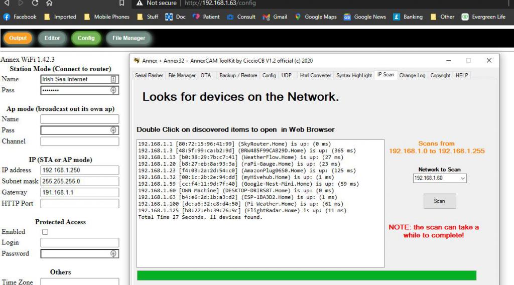

I'm wondering if there's something wrong with my ESP

It might not be anything to stop it working, but your gateway is wrong I think. It can't every find the gateway at 191.168.1.1 , should this be 192.168.1.1
