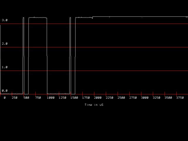

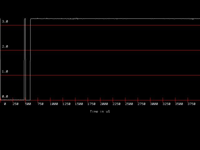

  KeepIS said  Actually I think this might be DS1820 The dev markings are mostly worn off and it was the result of the Test app that made sense of what was left on the case Mike.
These screens are with the DS1820? device mentioned above, using 800 ms conversion time stops 1000 error. Result multiplied by 8 as noted by Jim in an earlier post, gives the correct temp to +- 1/2 a deg.

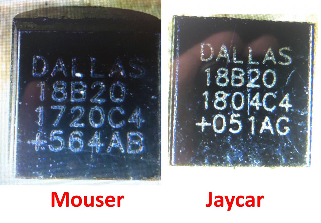

I went and ordered some "DS18b20" devices and found the following
The 2 I bought from MOUSER.COM proved to be genuine.
I bought one from Jaycar Electronics which is mounted on a small PCB substrate and whilst both read a temperature and responded as expected when I held a soldering iron near them the Jaycar module comes up as a FAKE.
Stay away from these Jaycar Modules
Now when I run the tests, the fake returns a value in 232 ms whereas the genuine was 692ms (I think from memory)
However there was a temperature difference of approximately 2 degrees C (fake was lower) between the 2 just measured at ambient room temperature (fake read 24.5 the genuine 26.5).
I will run some tests with both bonded together so I should be able to see the variations at various temperatures.
But the difference is quite pronounced and I pose the argument that you should not use the fakes unless you have calibrated against a known source but even then how reliable are they?

With the Jaycar modules, the "fake" claim comes from the serial number not complying with known ranges.
It is possible that Maxim have started using the high value serial numbers.
So far, I know that the one I have correctly changes between 10 and 12 bit resolution and the time taken for each resolution is correct.
The only chips we have had that can't be read with the CMM2/micromite code are the ones that started this thread. I would love to have one of them to play with but too far away...

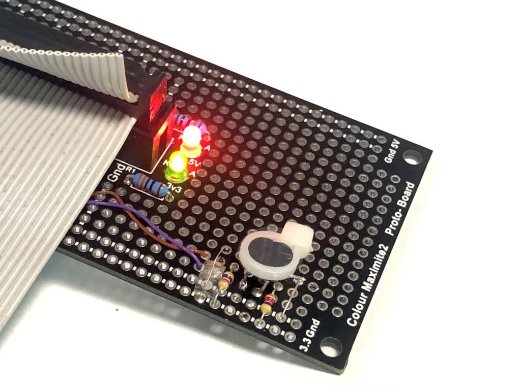

I have done my test with the 2 types bound together with a small cable tie.
The Mouser unit on pin(35) the Jaycar on pin(37)

This is how I tested them.
This is the markings for each, both appear to be laser etched.
