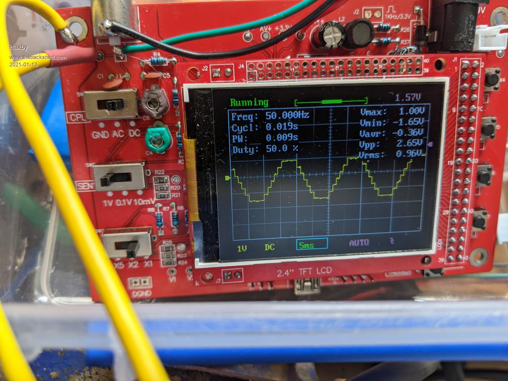

Could the toroid cores have become permanently magnetised?
Here was the working trace with 2 inverters, no load, 140vdc. I can see an offset from zero. Is that a clue?...
Haxby
Joined: 07/07/2008
Posts: 427
Posted: 01:34am 13 Jan 2021
In the last test, I still had 5 ohms in series with each of the two transformers. I would have thought that would be enough to save the IGBTs...
Posted: 03:28am 13 Jan 2021
Ah yes, that inverse diode is extremely important.
That last waveform looks o/k.
Don't worry about the ragged looking steps, they always look like that until you have all four inverters going.
The reason being, that the transformers are trying to switch a current that is stepping up and down.  Inductive components don't like instantly changing current.
When all four inverters are running, the current in all of the transformers will be a nice smoothly changing sine wave.
All four transformers will be very happy, and all the waveforms look a lot cleaner and much nicer.  Its an amazing transformation.

  Haxby said  In the last test, I still had 5 ohms in series with each of the two transformers. I would have thought that would be enough to save the IGBTs...
Without the inverse diode, there may have been a very destructive back emf which may have been high enough to break down your IGBT.  The inverse diode clamps the flyback voltages so they can never go below ground, or above the dc supply.
Without that diode the IGBTs don't stand much of a chance, even with a low dc supply voltage. A series resistor is not going to help, as its an overvoltage spike.
