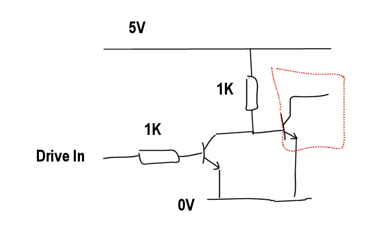

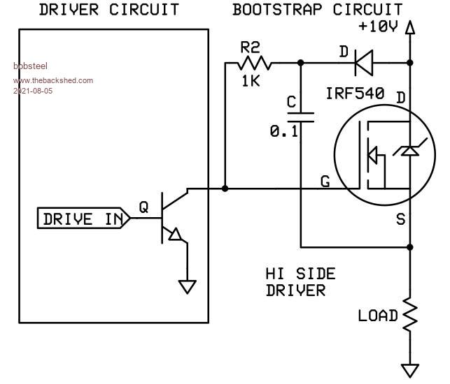

OK Can I get some advice please . Going back a bit I settled on a circuit and its result inverts the signal so its off when it should be on . etc So whats can i add to invert it again so I don't have to convolute the running program . Here is the circuit again.
This is nuts and volts circuit and i have 28 volts on the top and I'll have 3 drive pins to 3 of these circuits on each of 20 boards so just the minimum of components .
Edited 2021-08-05 18:19 by bob.steel
CaptainBoing
Joined: 07/09/2016
Posts: 2171
Posted: 08:47am 05 Aug 2021
personally I don't see any problem with having "active LO" signals (which is what you have above).
It can be inverted in the software easiest or if you want a hardware solution, just put another transistor on the base of Q as shown below (your existing Q is in the red box) to act as a simple inverter. Any small signal NPN will do for the two transistors - if you have old stock of BC107 or similar, use them here and give the old boys purpose. 1K will limit drive current to 5mA which should give a good solid turn-on
other ideas do exist...
Now when your signal goes high, new-Q turns on and connects the base of Q to GND - turning it off. When your drive goes low, new-Q turns off allowing the base of Q to drift rapidly up to 5V turning it on with some gusto.

Posted: 10:11am 05 Aug 2021
G'Day All
I hope that DRIVE IN is via something like 10k.
Then remove that signal from the Arduino pin and connect to +5V.
Then connect the emitter of Q to the Arduino pin. (after disconnecting GND.)
It might be a good idea to increase R2 a bit to reduce current in Arduino pin.
You now have a common base circuit.
Peter
CB does EBay sell gusto?
P
Edited 2021-08-05 20:14 by PeterB

PeterB
Joined: 05/02/2015
Posts: 669
Posted: 10:29am 05 Aug 2021
Do you agree that my humble idea would work? I'm afraid that I am losing confidence in my hardware skills.
