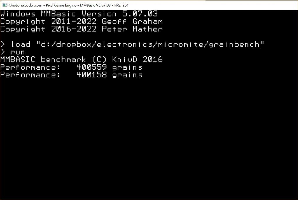

More progress

  matherp said  More progress
What did you do ?
The current 5.05.01 DOS version runs 123570 grains on a i9 (absolutely not the slowest machine). 3x more performance. WAUW...

  Quote  What did you do ?
As they say in the song "It's a kind of magic"
Another performance data point - Solar Eclipse calculation
MM+ @ 100MHz 121.75 seconds
PicoMite @ 252 MHz 35 seconds
CMM2 7 seconds
MMB4W 0.4 seconds
