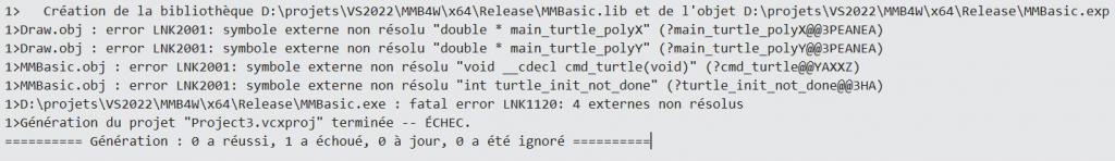

Hello Peter
I just get your beta 0 from github and try to compile , they are 4 errors , when i tried to compile the alpha version everything was OK.
Here the log :
I use VS2022 like you.
Cheers.

Posts: 11818
Posted: 05:12pm 05 Mar 2022
V5.07.03b3
MMBasic.zip
Should fix most (all?) of the bugs identified above + some others not reported including a complete replacement FFT module (volhout please test)
