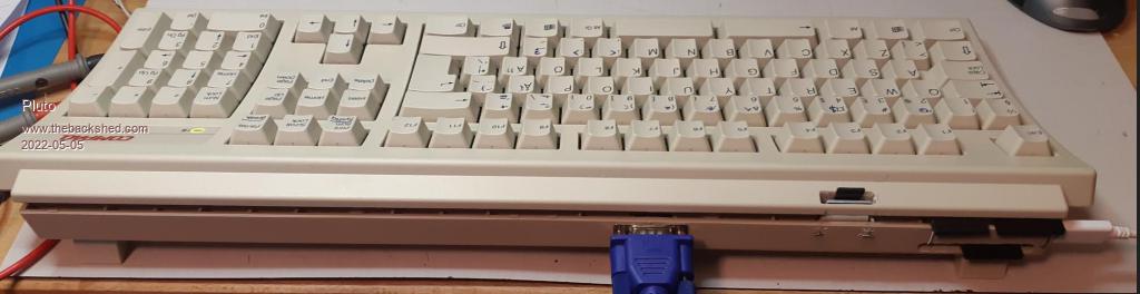

This is my latest version of PicoMiteVGA. Quick and dirty, but quite handy despite the quite heavy keybord from an old COMPAQ. (Still plenty of room for future add-ons). I thought it was better to have the grandchildren (3 and 5 years) hammering in readable and non-readable text on this thing than using my laptops or desktops. Furthermore I think they need to get gradually used to MicroMite Basic
PicoMite to the right, VGA connector in the center and SD-card in between. RTC inside.
Female connectors on the available ports directly soldered on the Pico module. Circuits for keyboard and VGA built on prototyping PCB. All according to the guidelines in the manual. Works perfectly.
Unfortunately the Swedish/Nordic keyboard is not yet supported by the PicoMiteVGA firmware. Some keys are now pen-labeled with corrected characters.  I hope that our keybords will also be supported some day.
/Fred

Nice looking. Congratulations.
In this post , matherp said Swedish keyboard for MMBasic for Windows was supported. Maybe if you can confirm that your keyboard works in MMB4W, then support for that keyboard might be added to the Picomite.

Peter M has successfully implemented Swedish (SW) keyboard in MMB4W, but as far as I have tested and tried it is not yet available in PicoMiteVGA.
Btw: For the keyboard levelshifters I have used Si2302 N-channel mosfets. SOT-23 soldered to tiny adapters before attaching to the prototype PCB. As i found these working on my first proto, i did not bother to test anything else. (>90pcs still on my stock, $3.30/100pcs).

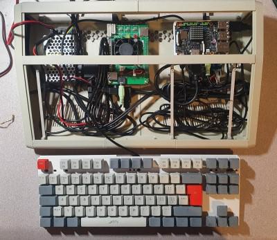

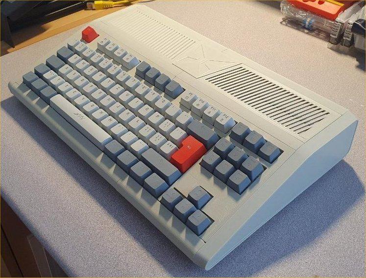

Andrew Mathieu did its own adaptation of Lee "Legion" Smith 3D printed case.
Files on Thingiverse
  Quote  The parts are split so they fit on a 230x230mm print bed and with that the side pods have to be printed 45° diagonally. Without splits the largest piece would be 380x225mm (base plate). The overall size of the case is 395x240x65mm. You need to find a suitable ten-keyless keyboard to integrate. The stands I've modelled fit the Xtrify K4 keyboard which is available in a retro colour scheme.
Posts: 9407
Posted: 08:13am 07 May 2022
That's rather nice. :)
