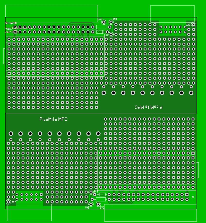

Posts: 9027
Posted: 09:12pm 09 Jun 2022
Just been playing with the design of a serial interface board.
As I might be using COM2 for the UART bus, I've multiplexed COM2 into two ports, using a GP pin to switch between them.
One port is RS-422 5V (4-wire) as I know Craig likes these. :)
The other port has parallel connected connections: RS-232 5V and RS-485 half-duplex 5V.
The RS-232 has an AUX terminal, which is switched by the same signal as the RS-485 DE/RE.
I'm not sure exactly what this board could be used for as it's a serial interface on the end of a serial interface, but there must be something. :) At the very least it could probably have a HMI hung off it (although the master has bluetooth now).
EDIT:
And now, a "sea of holes" board that includes the following:
.. A plug-in PicoMite
.. 10-way plug-in terminal block
.. Connectors for the base board - with the standard PicoMite pins connected
.. 5 LEDs on GP0-GP4
.. No ground plane on eithe side of most of the user area
.. No holes specifically dedicate to GND or supplies - that's up to the user. If I include them they *will* be in an inconvenient place for someone. :)
Edited 2022-06-10 19:49 by Mixtel90

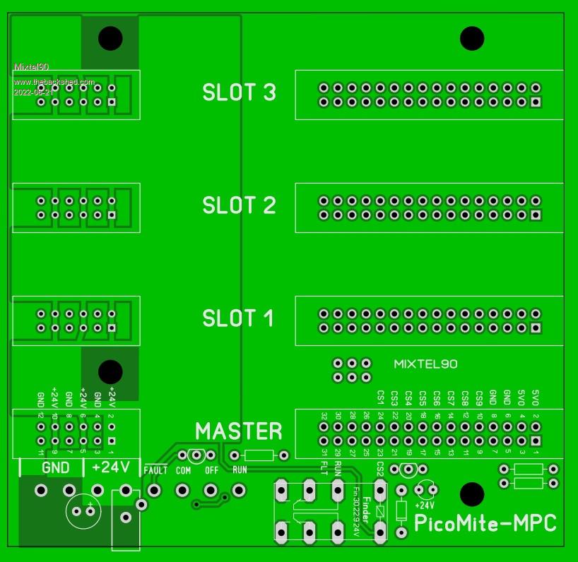

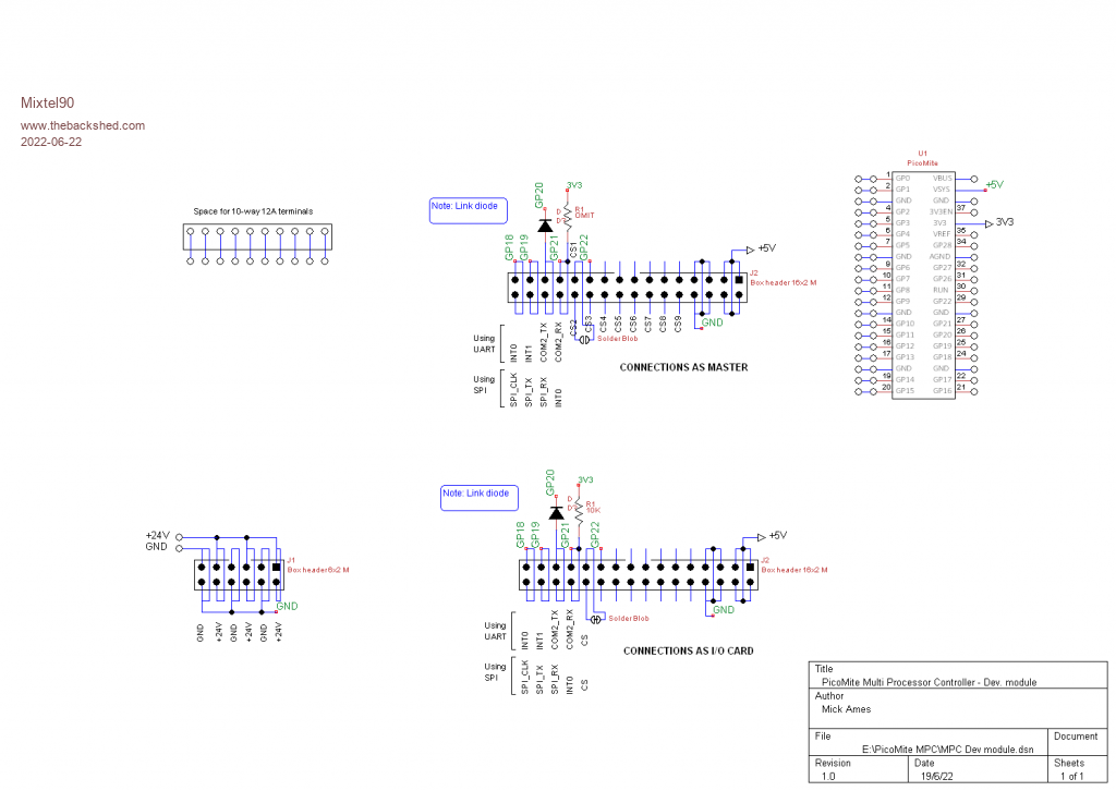

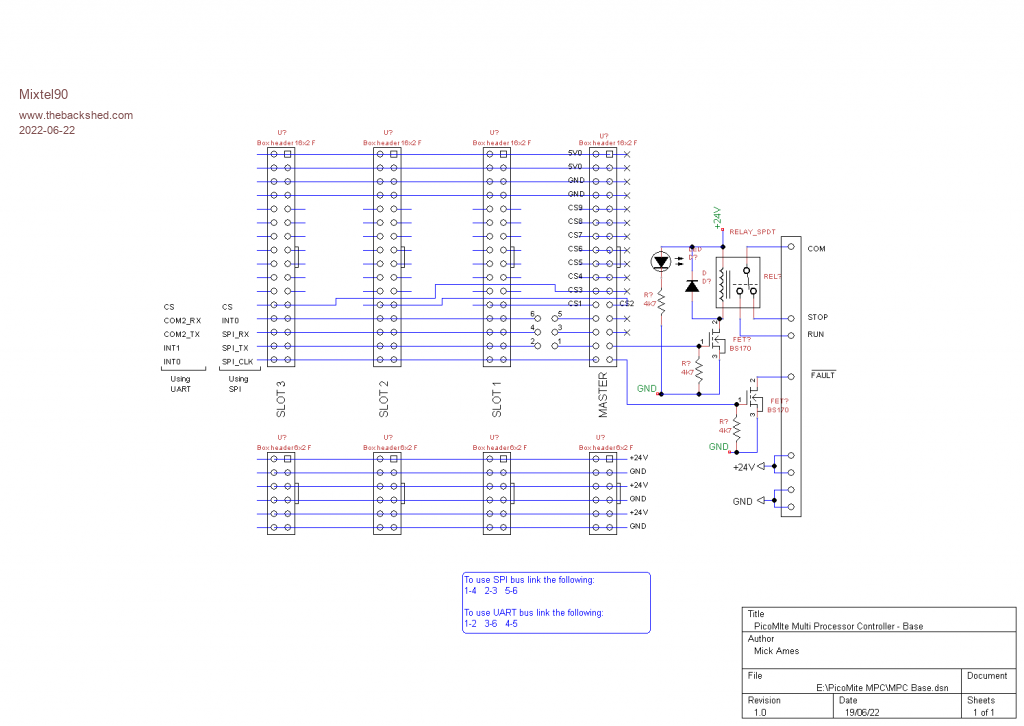

Posts: 9027
Posted: 09:46am 17 Jun 2022
This isn't dead yet. :)
I've made changes which should allow a development system to be produced easily.
1.
The base has changed, allowing the Master to be connected to the bus as either a SPI or a UART system. This is done by soldering a couple of wire links in, so those could be pluggable on a development system. The Master would have the required pull-up resistor on a UART system.
2.
The "sea of holes" board is more sophisticated now (and is called the "development module". The LEDs are gone, to give more usable area. There *are* some power and GND holes now, but they shouldn't be in the way. Pins on the PicoMite are connected to the adjacent holes both outside and inside the socket area, so are easy to put resistors, for example, directly onto the pins or to probe them. The board can, with not too much messing about, be made into a Master, although it would need a bit of wiring to use it for a full bus as 9 wires have to cross the Picomite from one side to the other if you want to do it properly.
It should now be possible to chop the base into a 3-slot board very easily. Then you could order just 3-slot boards (98mm x 100mm) and development modules (100mm x 100mm for two) to start playing. You would get 5 bases and 10 development modules (after sawing them up). Initially I'd simply power the main bus at 5V instead of 24V and link it on the Master instead of having a 5V regulator. It only affects the I/O and makes it much easier to mess with. To make this nice and easy, the base can now accept a 3.5mm barrel jack for power, together with a local electrolytic capacitor. These are fitted in the area normally used for the base terminals. You lose the terminal for the /Fault output, but that's are of little use in the initial stages and you can always dangle a LED and resistor if you need it. A fully equipped dev system would have one master and three slave boards, so you'd have enough PCBs to make two full systems, with 3 spare bases and a couple of spare slaves.
If there's any interest I'll post pictures/files/whatever for this basic system, although I've not done any schematics or documentation yet and things may still change.
The initial idea would be to get the master-slave comms working, with no real need for I/O apart from putting some LEDs on to monitor what's happening. With the comms working certain protocols have to be sorted out, such as slave scanning on boot and the slaves returning their type and number of registers etc. so that the master knows how to use them. I envision this as being a set of standard SUB and Function blocks, a set for masters and a set for slaves - no matter what type. This would give a standard framework to be used for building a complete system.

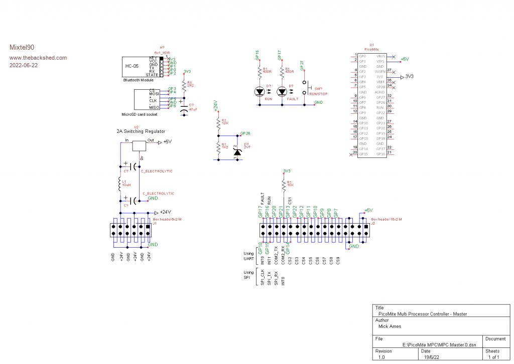

Posts: 9027
Posted: 01:38pm 21 Jun 2022
Pretty, but I'm not in competition with them. :)  This is for *my* entertainment. lol
Why use another board when my design is better, more flexible and cheaper, Craig?  :)
The base can have up to 9 slots for I/O modules plus the master.
Typically two I/O modules or masters fit onto a single 100x100 board. Cut them afterwards.
This is a master module circuit. I've done the board layout, but still a little undecided on how to lay out the reg and filter components.
Edited 2022-06-22 00:20 by Mixtel90

Posts: 9027
Posted: 02:29pm 21 Jun 2022
My idea is that on boot a standard routine in the master will scan the I/O boards to see what it has. Each board will return its type and how many registers it will require for talking to the master. This info will be compared with a list of I/O boards provided as part of the user program. The master will refuse to start if any board is wrong or missing. The register numbers are required if using SPI, as some boards may only need one or two command registers yet return a lot more values. Others may require a lot of setup info yet only return "Done" or "Fault number n".
I could have had many more I/O boards, but not within a sensible size. I'd already decided that the maximum length would never exceed about 200mm - it ended up at 210mm using a nice easy 20mm board spacing. :) Using SPI I'd need a CS pin for each board anyway, so 9 boards fits nicely.
Edited 2022-06-22 00:34 by Mixtel90

Posts: 9027
Posted: 04:12pm 21 Jun 2022
I made the system to work with either a UART or an SPI bus interface. I figured that if I made it SPI only and then discovered that it wouldn't work then I'd have scrap boards. :)  It cost me a connector pin and a bit of jiggery pokery, but it should work. You don't have to use CS either if you are using UART, but you need to give the IO boards addresses then.
In theory the dev board can be configured as a cut-down master, so it's feasible to just order 5 of each of those and the 3-slot base for experimenting. It'll cost as much for the connectors - and you need a few PicoMites too, of course.
If you really wanted to you could easily reduce this to just a couple of boards, but I don't think I'd consider that unless space was seriously tight. You could even run the master on its own (with something to bring the pins out to terminals) but it's a bit short of IO pins.
