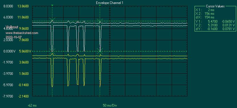

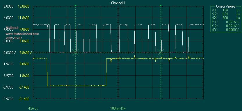

@Peter,
I have finally experienced the remark that Frank(N Further) made on the keyboard support. Not with his solar clock, but with the chess program.
I test this by pressing the NUM-LOCK key and check whether the LED turns ON and OFF.
I have not found a guaranteed way to reproduce it, it simply happens when the program is running. Could be working fine for few minutes, then simply no response anymore to the NUM-LOCK key. At that moment the keyboard is locked up for X time. Pressing <CTRL-C> can't stop the program anymore.
I started looking because I noticed that at a certain moment it looked like a different key was pressed (as if a glitch caused the bits to be shifted).
I tried hardware:
- waveforms are not different between working and non working keyboard. There are minor glitches, but these do not even come close to thresholds.
- I added 100pF and later 470pF capacitors to make sure the glitches where gone (but yes, that influences timing). To no effect.
- I changed the 4x10k to 4x3.3k for faster edges, no effect.
Is there anything I can do to help analyze ?
Attached is a scope picture of the original 1.4 board (with 10k pullups) on the 5V side. The PS2 clock is something like 16kHz.

Posts: 6253
Posted: 01:44pm 07 Oct 2022
  matherp said  Response to numlock is completely different to normal chars. After receiving the numlock keypress the code has to send commands to the keyboard to light the LED. This is done with interrupts off. The firmware holds the clock low for 1/4 sec and than releases it to tell the keyboard to initiate command reception. The firmware then waits for the keyboard to generate clocks which the firmware uses to clock out data on the data pin. There is a timeout for all this so it won't stall MMBasic but it is possible the keyboard itself gets itself into a mess.
As per a previous discussion all this is compromised by the lack of a true OC mode on the RP2040.
Given that the issues seen only happen rarely and only for some users/keyboards and is not reproducible it is not something I intend to pursue even if I knew how
The 1/4 second low does not happen. Not with a working keyboard, not when the keyboard is not working. Maybe that is compromised by the OC...
In below pictures, the trace "envelope" is shows. My scope cannot show the detail in this timebase setting. Each peak is basically a set of clock pulses/data.
You can see that the working keyboard (numlock working) has a set of 5 communication packets. But no CLOCK low 1/4 sec.
When the keyboard stops working, there are only 2 packets. In case the keyboard should generate the clocks..well..it does not...
Again, this is num lock behaviour, which is not the actual complaint, but a method to show it stops working.
Edited 2022-10-08 00:00 by Volhout
