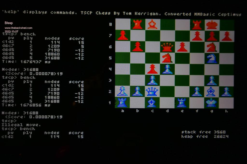

Posted: 06:45pm 06 Oct 2022
Because it was very straight forward, I've been able to test Martins 24 piece colour set. There are a few random black pixels on the left of all the castles.
Interestingly, using the 'bench' command, the moves it makes and the number of possibilities analysed are significantly different, from the version Peter compiled, but his version is the very latest and this was converted by Ceptimus 2019.
The timings :-
19    nodes per second MMBasic
34981 nodes per second compiled C.
Only a very slight difference then. ;-)
Regards Kevin.

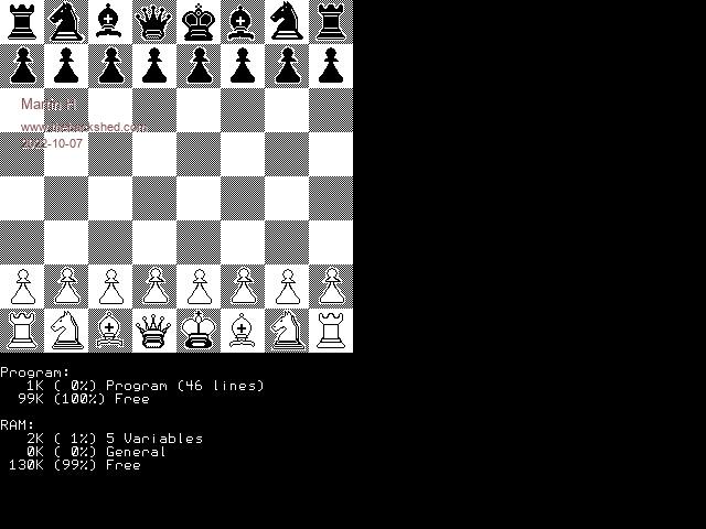

Posted: 07:40am 07 Oct 2022
So, here we have it
every Tile is stored as a single File in the "Tiles" Sub Folder
little Demo
'demo paint a Chessboard without using Memory for SPRITE/BLIT
'Tiles are loaded from SD Card, just when they are used
'Filenames are Color, Type, Background coded
'so
'"bpw.bin" is a Black Pawn on a with white Background
'"wnb.bin" would be a white Knight with black Background
' etc.
MODE 1
'create example board
Dim BRD%(8,8)
LN1$="rnbqkbnr"
'Rock.Knight,Bishop,Queen,King,Bishop,Knight,Rock
For y%=0 To 7
  For x%=0 To 7
  c$="0"
  If y%<2 Then c$="b"
   If y%>5 Then c$="w"
    Select Case y%
   Case 0,7
    c$=c$+Mid$(LN1$,x%+1,1)
   Case 1,6
    c$=c$+"p"
   Case 2 To 5
   c$=c$+"0"
 End Select
  stile(c$,x%,y%)
  Next x%
Next y%
Print @(0,320):Memory
'paint the Tiles
'Parameters f$ holds the color and type of the figure "bp" "wp".. etc
' if the place is empty F$ is "00"
Sub STILE(f$,px%,py%)
Local tl$
 'deside the Backgroundcolor
 If (px%+py%)Mod 2 Then f$=f$+"b.bin" Else f$=f$+"w.bin"
 f$="Tiles\"+f$
 Open f$ For input As #1
 tl$=Input$(200,#1)
 Close #1
GUI bitmap px%*40,py%*40,tl$,40,40
End Sub
the Files
demo.zip
  Mart!n
Edited 2022-10-07 17:45 by Martin H.
'no comment

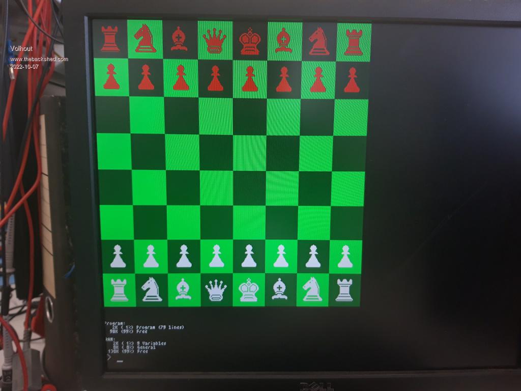

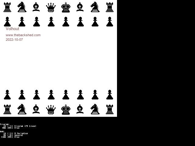

Posts: 6275
Posted: 11:23am 07 Oct 2022
Thank you Martin,
I have adapted your demo to use color in 640x480 mode.
The code is adapted to use 48x48 tiles (simply extended the 40x40).
I only used the white background/black piece tiles, the coloring is in the second layer (the TILE command).
You need 48x48 or 32x32 to do this in mode 1, since the background layer is in 16x16 blocks, called TILES....
'so
' etc.
MODE 1
Dim BRD%(8,8)
LN1$="rnbqkbnr"
For y%=0 To 7
  For x%=0 To 7
  c$="0"
  If y%<2 Then c$="b"
   If y%>5 Then c$="w"
    Select Case y%
   Case 0,7
   Case 1,6
    c$=c$+"p"
   Case 2 To 5
   c$=c$+"0"
 End Select
  stile(c$,x%,y%)
  Next x%
Next y%
font 8:Print @(0,400):Memory
save image "color"
'paint the Tiles
Local tl$,g$
 'always use the white background, black piece BMP
 if f$="00" then
   g$="Tiles\0"+right$(f$,1)+"w.bin" 'always load black piece on white field
 else
   g$="Tiles\b"+right$(f$,1)+"w.bin" 'always load black piece on white field
 end if
 'If (px%+py%)Mod 2 Then f$=f$+"b.bin" Else f$=f$+"w.bin"
 'f$="Tiles\"+f$
 'Open f$ For input As #1
 'determin the tile (tc%) and piece (pc%)colors
 if left$(f$,1)="b" then
   pc%=rgb(red)
 else
   pc%=rgb(white)
 end if
   tc%=rgb(green)
 else
   tc%=rgb(myrtle)
 end if
 open g$ for input as #1
 tl$=Input$(200,#1)
 Close #1
box px%*48,py%*48,48,48,1,rgb(white),rgb(white) 'make the tiles virtually bigger 48x48
GUI bitmap 4+px%*48,4+py%*48,tl$,40,40          'print the 40x40 tile in centre
'color the tile background and ink the piece
for dx%=0 to 2
 for dy%=0 to 2
   tile dx%+3*px%, dy%+3*py%,tc%,pc%
 next
next
End Sub
@Peter
Could you investigate whether it is possible to make the "SAVE IMAGE" also show the TILE color ? a SAVE IMAGE of above chessboard shows as black and white.

Posts: 12251
Posted: 12:17pm 07 Oct 2022
  Quote  Could you investigate whether it is possible to make the "SAVE IMAGE" also show the TILE color ?
If I did that then if you tried to subsequently tried to load the saved image it would appear all white
