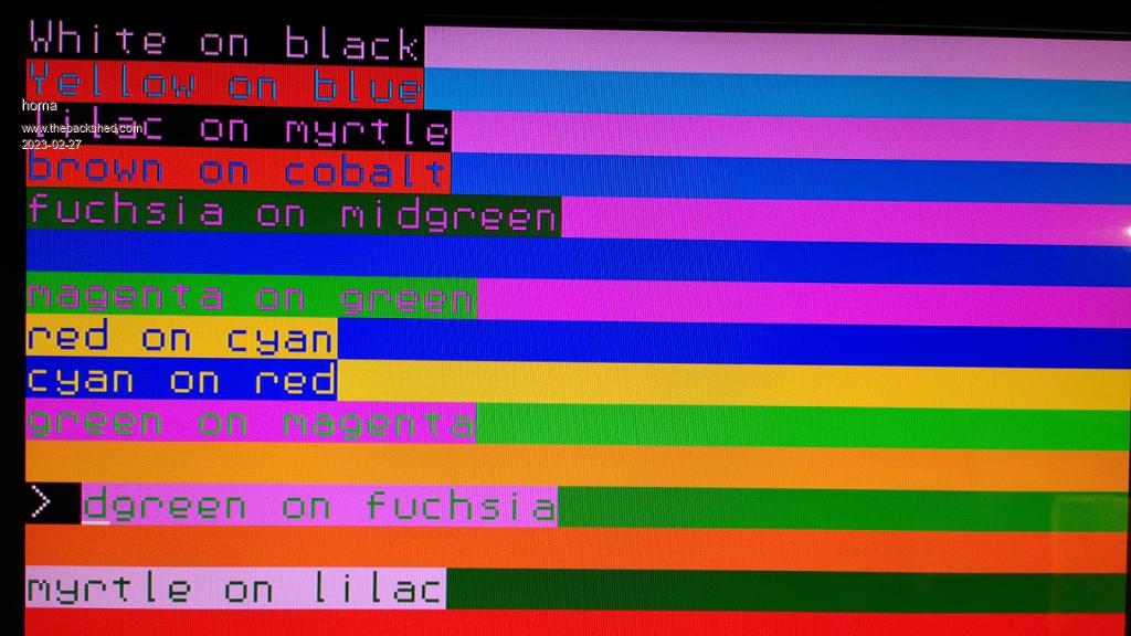

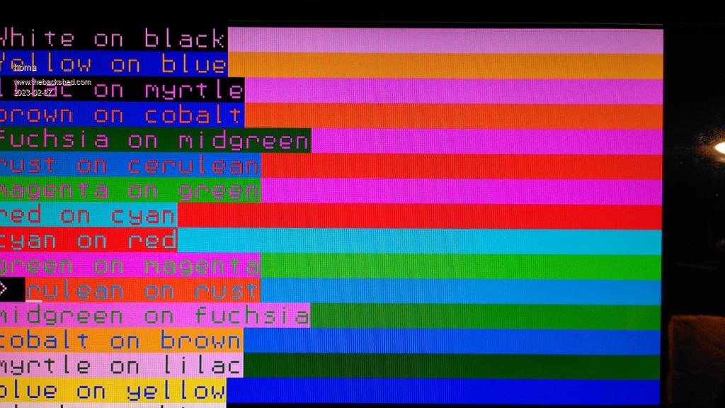

@peter:
i don't think so. See images attached, the first image is the version for PicoMiteVGAV5.07.07b25 (specifically for vollhout) and the second image is the latest PicoMiteVGAV5.07.07b25 (version2).
Matthias

Posts: 11827
Posted: 10:11pm 26 Feb 2023
Oops - sorry. posted the wrong binary
PicoMiteVGA.zip
homa
Joined: 05/11/2021
Posts: 685
Posted: 10:38pm 26 Feb 2023
thx   works
