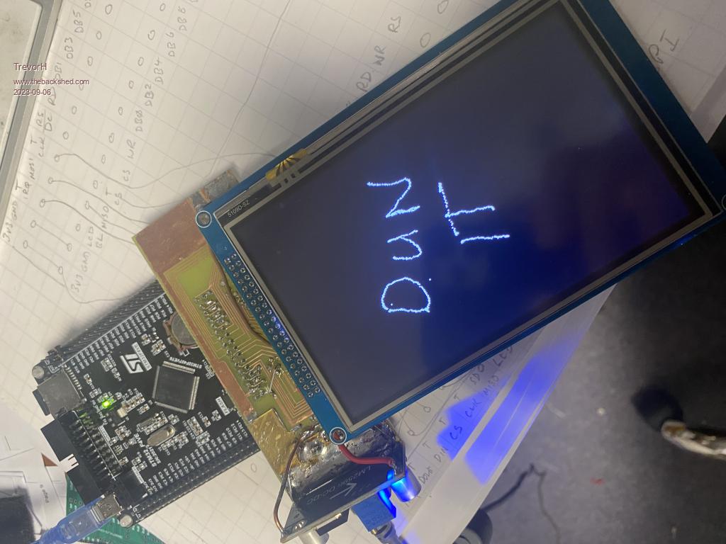

I have a result of sorts. With a separate 3.3v supply to feed the TFT, I still had the problem but I noticed if I disconnected the separate 3v3 the TFT was still lit but very dim. So the backlight was still drawing current from the armmite through the SSD1963 chip. To fix this I re-configured the TFT to "always on" for backlight and supplied the separate 3v3 to the LED-A pin. Now the TFT works fine with touch enabled.
I still have one tiny problem, GUI calibrate shows on screen and T-IRQ drops when screen touched but the test doesn't progress (stays on first test point). Will check touch wiring next.

TrevorH
Joined: 06/04/2018
Posts: 145
Posted: 02:31pm 05 Sep 2023
Fault on touch connections, I will try backtracking to SSD1963 PWM for backlight.
Sorry picture is upside down, I also swapped the linear Reg for a buck reg LM2596 which is much more stable than 7805. The 3v3 is from a ams1117 reg, 5v for 7" screens.
Must do a new shield with new psu requirements.
