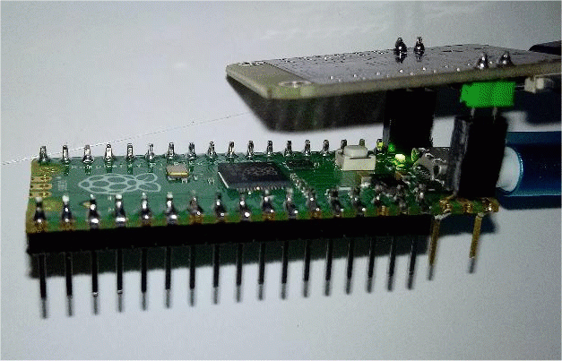

Ok, proof-of-concept for folder and file retrieval from github.
Here's an ESP32-S2Mini plugged into a picomite--pins 1 and 2 on the picomite connected to 14 and 13 on the ESP, and 40 (5V) and 38 (0V) to 5V and 0V on the ESP. Power supplied to the Picomite by USB also powers the S2Mini.
Of course, an S2Mini could be connected to picomite PCBs using other available pins, or to a CMM2 or an F4. This implementation is for github-based program files and folders, but similar retrieval is possible from other sources and, one hopes, from Docu-Wiki (although most of the FotS pages are not just program listings).
There's little error checking in this, and presumably, if useful, some sort of folder display such as Jiri's CMM2.fun NC program would be needed.
This would only be specifically useful for 'Mites for which there was not a PC handy.

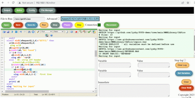

Here's what it looks like on the Annex side:

And the Annex code:
' getFilesJSON.bas
dim itemName$(200)
dim itemType$(200)
crlf$=chr$(13)+chr$(10)
qt$=chr$(34)
source$="github" ' http dropbox onedrive blob
url$="192.168.1.82/files/"
url$="https://github.com/lyzby/FOTS-demo/tree/main/MMBLibrary"
getType$="folder"
serial2.mode 115200,13,14 ' tx,rx
onserial2 getRequest
wlog "Waiting for input"
'gosub getRequest
do
loop
getRequest:
 pause 200 ' plenty of time to receive entire request
 sRequest$=serial2.input$
 i=instr(sRequest$,crlf$)
 if i>0 then
   sRequest$=mid$(sRequest$,1,i-1)
 endif
 wlog sRequest$
 if mid$(sRequest$,1,6)="GETDIR" then
   url$=mid$(sRequest$,8)
   sFiles$=""
   nFiles=0
   gosub getFilesJSON
   wlog "# files: "+str$(nFiles)
   if nFiles>0 then
     sFiles$=""
     for i=0 to nFiles-1
       sFiles$=sFiles$+itemName$(i)+","+itemType$(i)+crlf$
'        wlog str$(i+1)+" "+itemName$(i)+","+itemType$(i)
     next i
     print2 sFiles$
   endif
 elseif mid$(sRequest$,1,6)="GETFIL" then
'    wlog url$
   a$=wget$(url$,80)
   i=instr(a$,"Not Found")
   if i>0 then
     a$=mid$(a$,1,i+9)
     wlog a$+" "+url$
   else ' OK--strip off header
'      i=instr(a$,crlf$+crlf$)
     i=instr(a$,chr$(10)+chr$(10))
     if i>0 then
       a$=mid$(a$,i+2)
       i=instr(a$,chr$(10))
       wlog mid$(a$,1,i-1) ' first line
     endif
   endif
   print2 a$
 endif
 return
getFilesjson:
   a$=wget$(url$,80)
'    wlog "Returned :"+a$
   if source$="github" then
     j=instr(1,a$,"""tree"":{""items""") ' find start of array of files
'      j=instr(1,a$,"{""items"";[") ' find start of array of files
     jEnd=instr(j,a$,"}]")        ' find end of array of files
     if j>0 and jEnd > j then
       c$="{"+mid$(a$,j+8,jEnd-j-6)+"}"
'        wlog c$
'        wlog str$(j)+" "+str$(jEnd)
       for i=1 to 999
'          fname$=json$(c$,"items[i].name")
         fname$=json$(c$,"items.name["+str$(i)+"]")
         if fname$="not found" then
           exit for
         endif
         itemName$(nFiles)=fname$
'          fType$=json$(c$,"items[i].contentType")
         fType$=json$(c$,"items.contentType["+str$(i)+"]")
         if fType$="file" then
           itemType$(nFiles)="F"
         elseif fType$="not found"
           itemType$(nFiles)="?"
         else
           itemType$(nFiles)=ucase$(mid$(fType$,1,1))
         endif
         nFiles=nFiles+1
         if nFiles>199 then
           exit for
         endif
       next i
     endif
'      if nFIles>1 then
'        nFiles=nFiles-1
'      endif
 return
