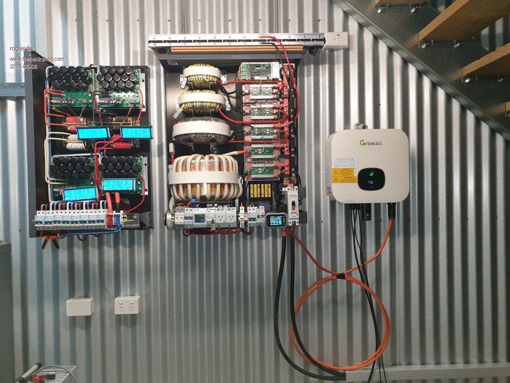

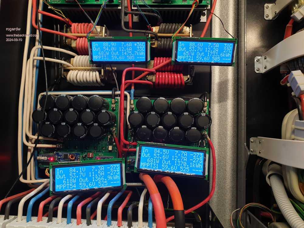

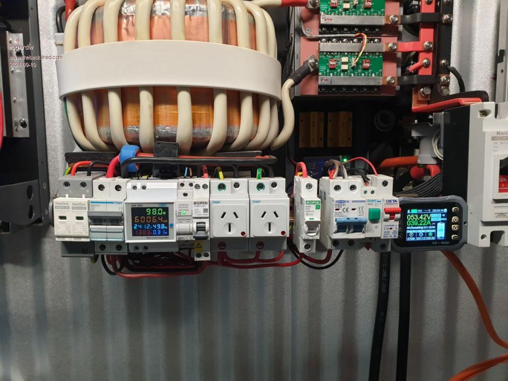

I thought it was time for a bit of an update after noticing the Warpverter clocked over the 6,000kWh mark some time today. It's been behaving well and I have just been leaving it alone.
It was officially installed on 6th of March, so it's been in action just on 6 months.
Still have to make a main cover for it and for the charge controller box too!!!
Combined, the 4 x MPPTs have clocked up 5,946.3kWh  ...  thanks Poida, Nick and Mike.

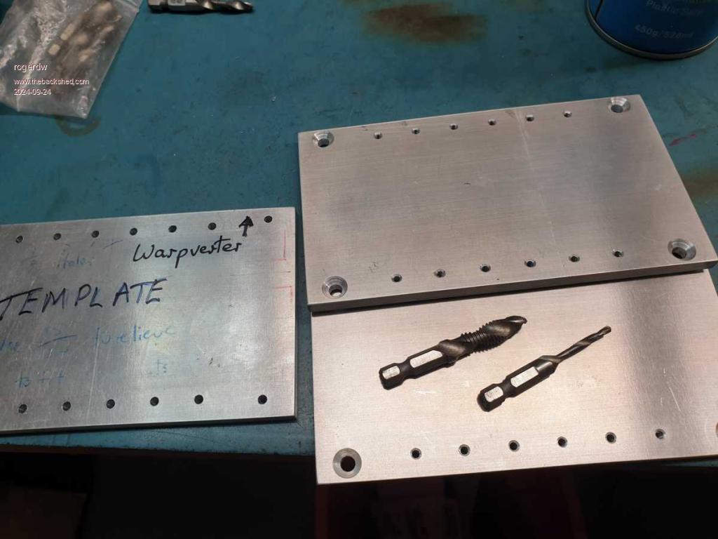

I've been a bit slack since having the Warpverter running but I had always planned to make a few spare modules in case of any failures. Of course that hasn't happened yet so I've made a start on a spare half bridge and a full bridge board.
For all the originals I used Wiseguy's idea of drilling a larger hole from behind to hold a captive nut to secure the mosfets  ...  but I've used (and broken) a few of the combined drill/tap/countersink bits in various other projects in the last couple years  ...  so I figured I'd try my luck with one on these 3mm threads.
I usually pre-drill the holes marginally smaller than the drill section of my tap bit so it has an easier time cutting  ...  and did the same with my aluminium backplates.
The bits are designed to use in an impact drill and fight their way through  ...  and they either make it or break off and remain stuck. Anyway, the tap worked perfectly and took only a few minutes to do 24 threads, Bit nerve wracking, but ended well.
The plates are 6mm thick and I threaded all the way through  ...  and if it had struggled too much, I figured I would drill up from behind so the threaded section didn't have to be the full thickness.
Not sure how I'd approach it if I was doing a full size heatsink  ...  maybe try and arrange the holes so I could do what I described in the last paragraph  ...  or stick to the old fashioned way  ...  slow and steady.
I also included a larger tap so you can see more clearly how they are designed.
Cheers,  Roger

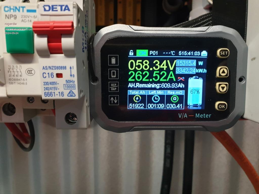

And just out of interest, I happened to walk past the system on Saturday and it was pushing 269 amps into the battery!!!
Of course I didn't have my phone with me and by the time I got back it was at 262. The battery had got flattened the night before because one of the girls had left a big heater on  ...  so was nice to see it fill back up smartly.

I'll have to test one of those bits, that speeds up the process enormously.

Yeah I was impressed with the bits too after I saw them used on you tube. I initially bought an $80 Frost set from Bunnings  ...  but after I broke a couple learning to use them I bought some cheapies off ebay  ...  and they have performed exceptionally well.
The first dozen holes I did on these plates I didn't stop to clean off the swarf  ...  and those took all of about 30 seconds to do  ...  but a few times it got tight and the impact driver started hammering so I figured I shouldn't take chances.
