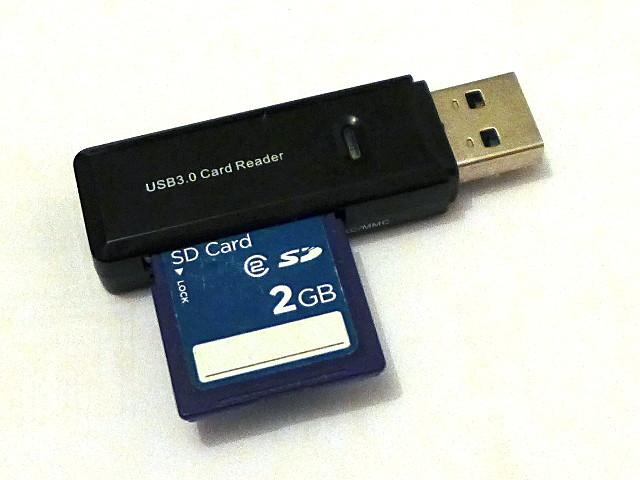

Posts: 2552
Posted: 12:50pm 31 Jan 2024
hi Peter,
   an interesting idea came up in discussions:
given USB HOST mode being available, does the picomite even need to have an SD slot taking up 4 GPIO pins? instead, a USB to SD adapter could be used to gain the same functionality:
or even simpler, just plug in a USB flash drive - so the SD card slot on the front of a picomite would be replaced with a USB socket with a stumpy USB flash drive plugged in. as an added bonus, this would also mean users would no longer need to find an SD to USB adapter if they wished to plug the flash storage into their PC.

Posts: 6171
Posted: 04:15pm 31 Jan 2024
Supporting keyboard, mouse, controllers (hid) is completely different from memory devices.
I guess we will loose all flash slots when these libraries are added.

Posts: 2552
Posted: 04:30pm 31 Jan 2024
  Volhout said  Supporting keyboard, mouse, controllers (hid) is completely different from memory devices
valid point - does anyone know what the code overhead for including MSC support in TinyUSB is? i'm picking it will not be enormous (<50k), and the cost may well be worthwhile when compared to gaining back 4 GPIO pins and achieving potentially better flash storage performance.

Posts: 9202
Posted: 04:58pm 31 Jan 2024
Why mess about? There's no OS anyway - you can't make the most of any drives.
Use 16MB of flash (the maximum that a RP2040 can handle) and even drive B: is optional.
Be careful not to lose what the PicoMite is good at by overloading it with stuff that might cripple it. We keep losing flash slots, for example, but there is *no possible* replacement for them as there is no CHAIN command.
Edited 2024-02-01 02:59 by Mixtel90

Posts: 2552
Posted: 05:17pm 31 Jan 2024
  Mixtel90 said  Why mess about? There's no OS anyway - you can't make the most of any drives.
well, there seems to be considerable enthusiasm in this thread for Peter's success with sony PS3 and PS4 controllers, along with USB mouse, and quite a bit of excitement when No0ne got USB keyboard support working.
beyond that, having MSC replace SD cards seems like a relatively small step with a good return - especially considering the sporadic issues raised over SD cards not always working reliably for some folks.
i am quite confident that the picomite will nicely survive any move to a unified peripheral bus.
