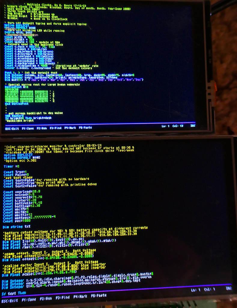

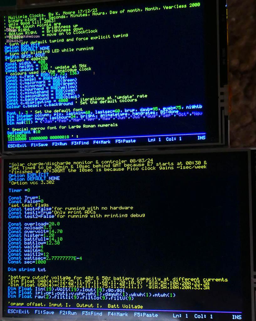

Bleep
Joined: 09/01/2022
Posts: 860
Posted: 04:09pm 20 Mar 2024
Hi everyone,
I now have the 4" ILI9488, here are some photos, compairing it against a 3.5" at Font 7 and Font 8, then a video, showing the editor page and line scrolling for speed of operation, with Peters new improvements. :-)
I would say using Font 7 is very usable the edit screen is 38x81 and Font 8, for me, not at all bad, the edit screen is 51x121.
Font 7
Font 8
Link to a video showing the 4" ILI9488 in use, for speed of operation Font 7.
Looks very good to me.
Regards, Kevin.
