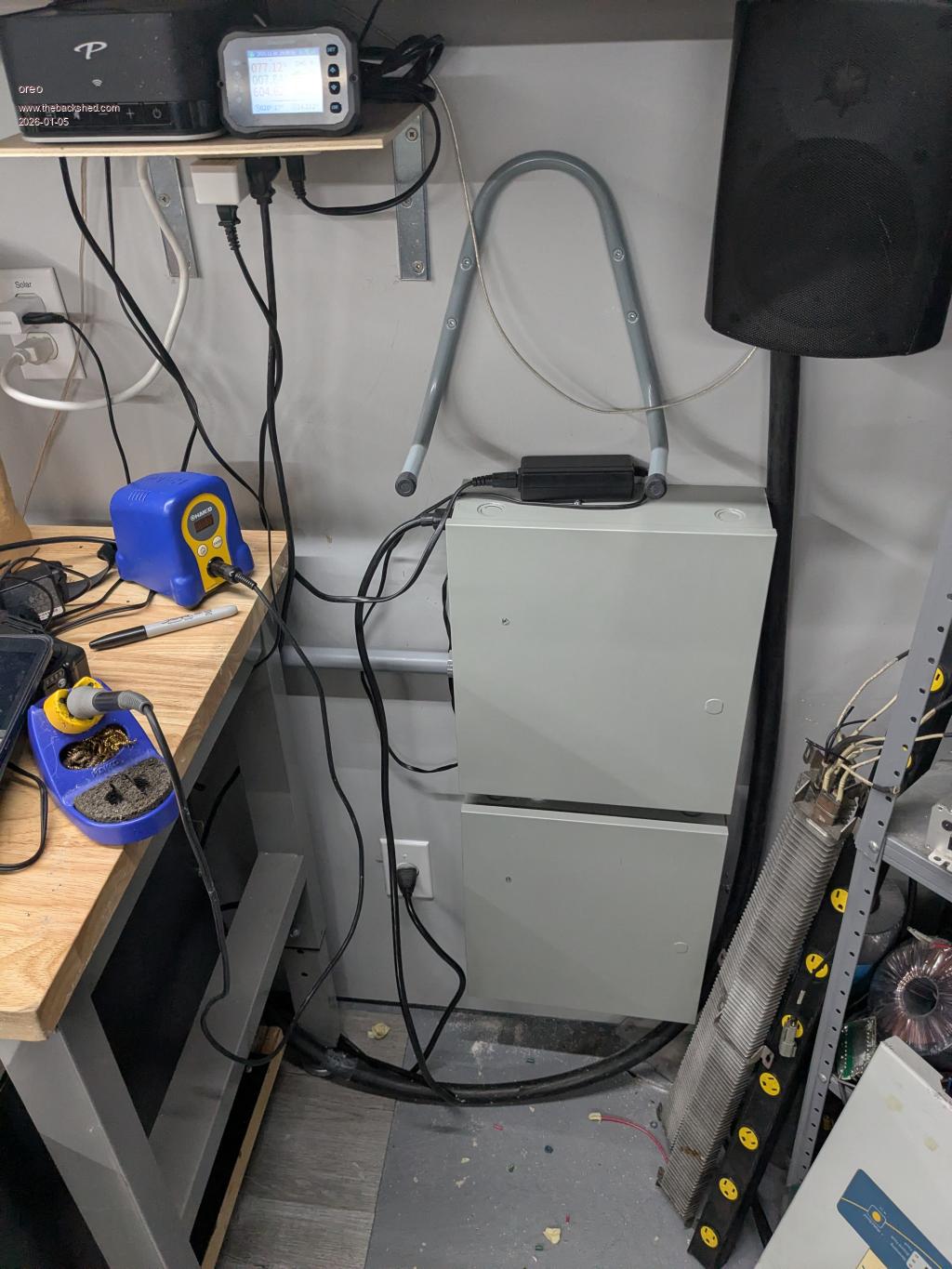

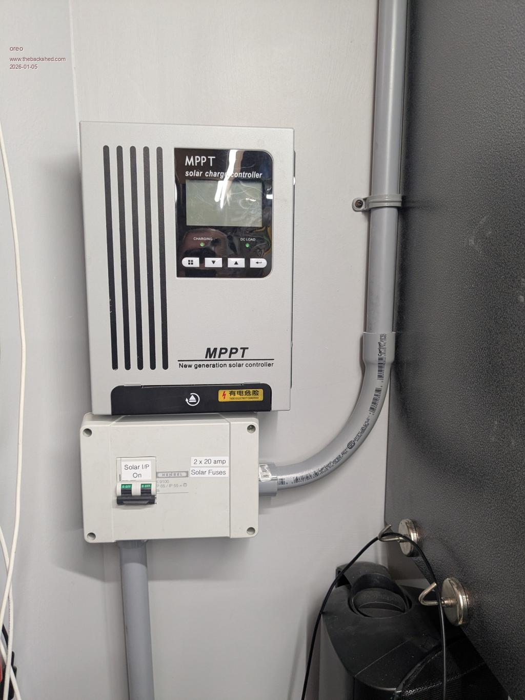

I did a bit of work in December on the system, mainly because I got my hands on a few more batteries on the really cheap.
I was not planning on expanding the battery, but you know how these things go.
So right now I have 2 batteries, one with 26 internal 36v packs and one with 20 internal 36v packs.
On top of the smaller battery, I have the MPPT and battery charger mounted.
So the plan was to relocate these 2 items, so I could add another 6 packs to the 20pack battery.
Moving the MPPT was fairly easy, as I just moved it to the wall.

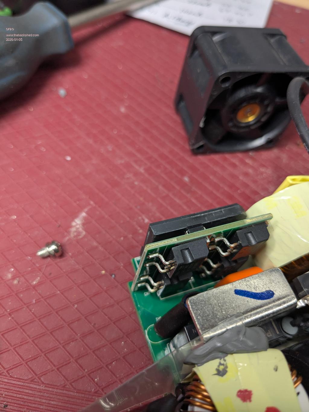

Rather than just move the charger, I decided to upgrade it.  Theoretically, my previous charger should
have been able to charge at 25amps (~1950w), however it used 2 12.5amp 54v power supplies in parallel,
and each supply tended to hog all the current, and then shut down.  I jury rigged it by putting some resistance
in series with each power supply, but every once and a while they did not play nicely.  This led me
to reduce the current to about 20amps.  On top of that, the efficiency of the setup was not ideal, due to
this resistance and also the fact that I had a diode array in series with the supply to stop back flow of
current.  This array had a drop of about .68v across it.
So I ended up replacing the 2 12.5a 54v power supplies with 5 12v power supplies.  (2 are SUPERMICRO PWS-1K02A-1R
and 3 are HP HSTNS-PL29)  I also purchased another Mean Well HEP series 24v supply, with adjustable current limit,
however this was a 13.3 amp unit to put in parallel with the 25amp unit I have.  In all, this should theoretically
yield close to 3kw of charging power.  I replaced the series diode bank with more V40100C diode pairs to drop the forward voltage to .40v.
One of the problems with using these cheap 12v power supplies, is that as supplied each connects the -ve rail
to the ground pin on the AC and they have many capacitors between the -ve terminal, and the live AC for noise suppression.
When you string a bunch of these power supplies in series, even with their AC ground pins unconnected,
there is quite alot of AC being injected into the dc by all those capacitors in the group of supples.
So I opened up the supplies and removed the capacitors.
Some of these supplies are 96% efficient, and I see they are using FET's to reduce the forward drop on the AC side bridge rectifier.  Very cool.
Anyway, I mounted these supplies in some boxes I got off marketplace, and mounted them on the wall.
I still have work to do here, as the 13.3amp supply has not arrived, and I want to add more functionality to the charger.

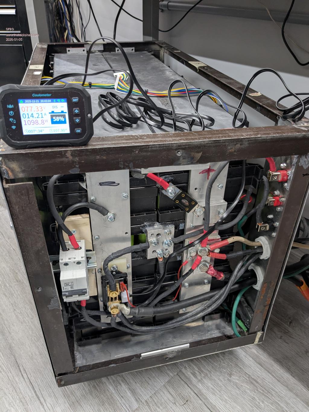

So now the top of the battery was clear, however I had added items onto the battery in a hodge podge manner and had wires entering the battery on 3 sides.
So I took to opportunity to improve this by both increasing wire sizes and moving all entry into the box to the rear of the battery on a separate panel.
I also changed out the couloumeter to a Junctek KM110F which has wireless, so I can view the battery condition anywhere.
This is what it looks like now.

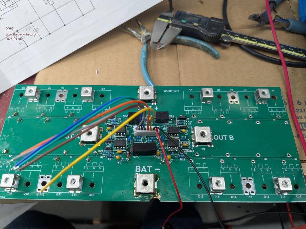

Everything seemed to be working well, and I was getting ready to install 6 more battery packs on the top of my battery, when the inverter popped.
I was in the basement at the time, and there was no change in noise level or anything, just the breakers on the batteries and inverter tripped.  It was in the middle of the day, so there would not have been much of a load on the inverter.
In testing I can only find that Q5-Q8 and Q13-Q16 have failed.  The little power supplies and driver transistors are ok.  I am thinking of using my back up board as replacement rather than fixing this one..  I can't see any other issues at this point.  Thoughts on what else to check?

Replace the gate resistors, they can be compromised, I had that issue after the old changeover ATS I was using arched Mains AC to Inverter AC and took out a few FETs.
I hope you can find the cause as this really should not happen with this inverter unless something like a flaky component failure or other external device fault.

  KeepIS said  Replace the gate resistors, they can be compromised, I had that issue after the old changeover ATS I was using arched Mains AC to Inverter AC and took out a few FETs.
I did measure them, but you're right they're easily replaced.

Since you are not using the typical 48V battery bank with the HY4008/HY5608 setup ...
Did you ever check the gate drive waveforms?  Just to rule out potential anomalies that could have degraded the MOSFETs over time.

  analog8484 said  Since you are not using the typical 48V battery bank with the HY4008/HY5608 setup ...
Thanks for the suggestion.  I believe I did check the waveforms when I first got things running, because the power draw was a little more than I was expecting.  Of course this is a while ago, so I don't remember details exactly.
At this point, I have a few parts on order from Digikey, so I can complete the build on 2 complete sets of boards.  This way I will have 2 complete running sets of boards to play with/compare.
Once I have these boards running, I should have some time to review everything.

-the 8 Fets (Q5-Q8 and Q13-Q16) were blown, so I replaced those and the the inverter ran.
-I then also replaced the driver transistors, gate resistors and thermal pads just because.
-I had a spare power FET and aurduino board mostly built, so I completed those and
made another aluminum mounting plate for the power FET board.  These new boards were
installed into the inverter, and the old ones kept as backup.

Not sure how hot the inner windings might be getting.
I think on the next transformer, I will bury a temperature sensor.
So I had decided a while ago that it was not cost effective to add capacity to my current battery bank
(currently about 14kw using 24pcs of 36v packs using A123 26650 cells).  Batteries are expensive and 14kw gives me about 1 days storage.
Then I saw this marketplace advert.
So yah, I had to pick up some.
I spoke to the people giving away the batteries, and they said that they had over 1000pcs in stock and they were not selling.
 Apparently they are expecting to get some all electric busses in for tear down and will soon have better batteries to sell (these batteries are out of hybrid busses)
