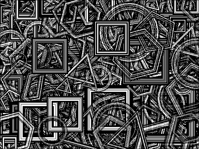

Black and White Infinite Art Cubism
MODE 1
 Q=Int(Rnd*5+3): If Q=7 Then Q=30
 A=Rad(360/Q): S=Sin(A): C=Cos(A)
 X=Rnd*MM.HRes: Y=Rnd*MM.VRes
 R=Rnd*(Sqr(Y+X)/20)*40+16
 For L=-R/5 To R/5
   N=(Abs(L)<R/8)*Int(Rnd*2)
   U=R+L: V=U
   X1=X+U: Y1=Y+V
   For I=1 To Q
     T=V*C-U*S: U=V*S+U*C: V=T
     X2=X+U: Y2=Y+V
     Line X1,Y1,X2,Y2,,N
     X1=X2: Y1=Y2
   Next
 Next
Loop While Inkey$=""

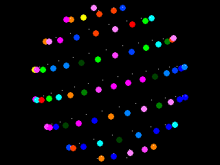

3D DISCO BALL
MODE 2
FRAMEBUFFER CREATE
FRAMEBUFFER WRITE F
 CLS
 t=Timer
 n=7
 r=n*16
 tr=t-n*50
 ra=tr/1234
 rb=tr/2345
 For a=0 To Pi Step .39268
   For b=0 To Pi*2 Step .8-.6*Sin(a)
     o=Sin(a)*Cos(b)
     k=Sin(a)*Sin(b)
     e=Cos(a)*Cos(ra)+k*Sin(ra)
     x=(o*Cos(rb)+e*Sin(rb))*r+160
     y=(e*Cos(rb)-o*Sin(rb))*r+120
     If Cos(a)*Sin(ra)-k*Cos(ra)<.05 Then
       C=Map(Int(Rnd*14)+1)
       Circle x,y,4,,,C,C
     Else
       Circle x,y,1,,,Map(15)
     EndIf
   Next b
 Next a
 FRAMEBUFFER COPY F,N,B

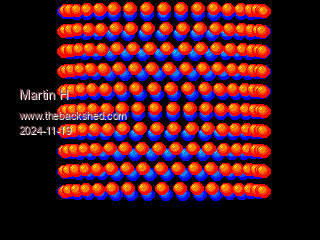

  Martin H. said  a litle animation inspired by the planet 9 demo
With small change it also runs on Game*Mite or any other Pico with LCD
FRAMEBUFFER create
FRAMEBUFFER write f
a=100:b=3:xc=160:yc=120
For n=0 To 9:For i=n To 180 Step 10
t=(i+90)*Pi/180:x=a*Cos(t):y=b*Sin(t):cl=(y<0):ball xc+x,n*20+yc+y-112,cl
Next : For i=170+n To n Step -10
t=(i-90)*Pi/180:x=a*Cos(t):y=b*Sin(t):cl=(y<0):ball xc+x,n*20+yc+y-112,cl
Next :Next
Blit 0,0,0,200,320,20:Blit 0,20,0,0,320,220:FRAMEBUFFER copy f,n:Pause 20
Sub ball bx,by,cl
For d=6 To 1Step -1
If cl Then :Color RGB(255,255-d*42,0):Else :Color RGB(0,255-d*42,255):EndIf
Circle bx+d/2,by+d/2,d,d
Next
End Sub

cool. needs mode 2 on hdmi pico 2. very fast animation, like 3d a bit!
Posts: 2807
Posted: 06:16pm 28 Nov 2024
3d disco ball rotataing x axis and y axis same time?? maybe?

  stanleyella said  3d disco ball rotataing x axis and y axis same time?? maybe?
Yes, its axis rotates in three directions, but the ball itself does not spin.
Don't you have anything to see this on?

  stanleyella said  cool. needs mode 2 on hdmi pico 2. very fast animation, like 3d a bit!
Yes, Mode 2 was included in the original listing. The pseudo 3D visualisation was inspired by the old Amiga demos.
The slight offset when drawing the spheres results in the rotation that occurs when simply scrolling up

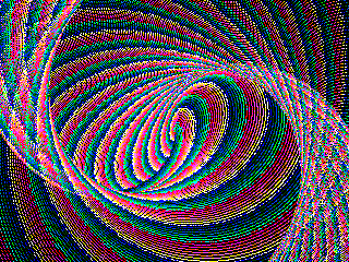

Attracting Star Whirlpool
MODE 2
Dim integer cm(15)=(0,14,0,7,0,0,6,0,0,4,0,0,2,0,0,0)
Colour Map cm(),cm()
Q=.375
For E=1 To 40 Step .025
 R=E*E/4:T=R/99
 s1=Sin(T):c1=Cos(T)
 N=5+R/1:A=-Pi*2/N
 S=Sin(A):C=Cos(A)
 X=0:Y=R:I=Rnd
 For L=0 To N
   I=I+1 And 15: If I=0 Then I=1
   Color Map(I)
   Pixel 160+X*c1*Q-Y*s1,120+X*s1*Q+Y*c1
   x1=X*C-Y*S:Y=X*S+Y*C:X=x1
 Next
Next
 T=cm(1)
 For i=1 To 15-1:cm(i)=cm(i+1):Next
 cm(15)=T
 For i=1 To 15:Map(i)=cm(i):Next
 Map Set
 Pause 50

Posts: 2807
Posted: 07:08pm 30 Nov 2024
nice one javavi
make it go in reverse maybe?

nice! is pico and mmbasic brill?
looks like star trek ds9 wormhole :)

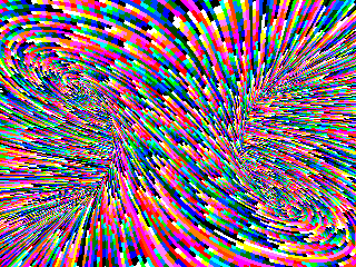

Toroidal Reactor   ITER
MODE 2
Map Reset
For U=0 To 159
 x1=U/128-1.25
For V=0 To 239
 y1=V/128-1
   X=0:Y=X:Z=-2.4
     k1=Sqr(X*X+Z*Z)-2
     d1=1-Sqr(k1*k1+Y*Y)
     X=X+x1*d1:Y=Y+y1*d1:Z=Z+d1
   Loop Until d1<.005
   v1=Atn(Z/X):u1=Atn(Y/k1)
   sColor(): Pixel U,V
   v1=3.13-v1
   sColor(): Pixel 319-U,V
 Next
Next
Sub sColor()
 p=Sin(Int((u1+v1)*40)*99)*98
 c=15 And ((u1-v1+p)*24*Abs(Sin(p)))
 Color Map(c)
End Sub
Dim integer cm(15)=(0,15,7,1,0,0,0,0,0,0,0,0,0,0,0,0)
 T=cm(1)
 cm(15)=T
 Map Set
 Pause 50
Edited 2024-12-02 04:09 by javavi

that's impressive! thanks. I had to learn trig years after school. never used it until started using pics

Neat!   I immediately thought of "Wendelstein".
In my version, I save the image when it is created for the first time and load it when it is repeated. This is a bit faster - I'm so impatient!
I changed the rotating palette as follows:
Dim integer cm(15)=(15,14,13,12,11,10,9,8,7,6,5,4,3,2,1,0)
This makes the result more colorful.

  twofingers said  This makes the result more colorful.
MODE 2
Map Reset
For U=0 To 159
 x1=U/128-1.25
For V=0 To 239
 y1=V/128-1
   X=0:Y=X:Z=-2.4
     k=Sqr(X*X+Z*Z)-2
     d=1-Sqr(k*k+Y*Y)
     X=X+x1*d:Y=Y+y1*d:Z=Z+d
   Loop Until d<.005
   v1=Atn(Z/X):u1=Atn(Y/k)
   sColor(): Pixel U,V
   v1=3.13-v1
 Next
Next
Sub sColor()
 Color Map(c)
End Sub
'Dim integer cm(15)=(0,15,7,1,0,0,0,0,0,0,0,0,0,0,0,0)
Dim integer cm(15)=(0,1,2,3,4,5,6,7,8,9,10,11,12,13,14,15)
 T=cm(0)
 For i=0 To 14:cm(i)=cm(i+1):Next
 cm(15)=T
 For i=0 To 15:Map(i)=cm(i):Next
 Map Set
 Pause 50
