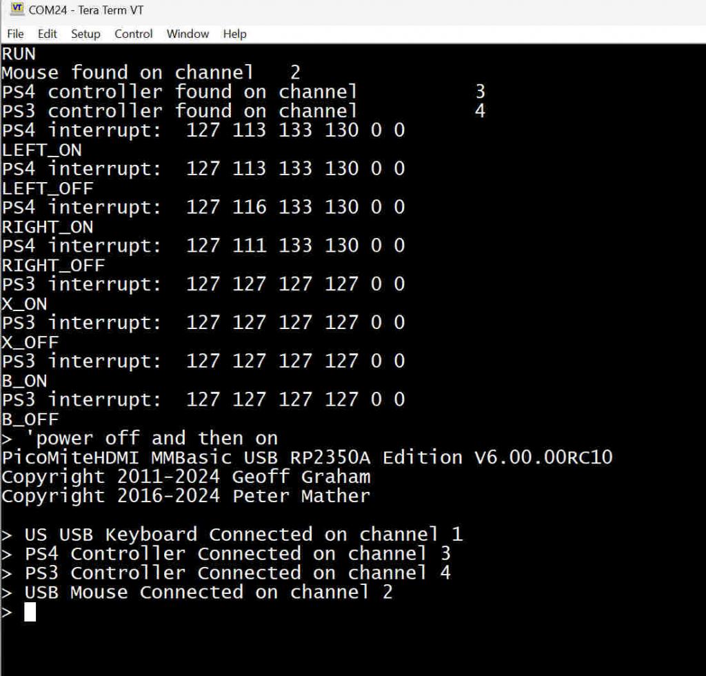

Does anyone have a program to test the inputs of a game controller?  I also am not sure how to program it yet. What manual is there at this time that would be best. Can I use any of the info in my CMM2 manual? Thanks.
Posts: 12110

Now I know I'm being a nuge but I decided to try out a few PS3 controllers I have and a PS4. All of my 3rd party PS3 USB controllers cause a boot loop and my original PS3 wireless on a USB cable causes a boot loop until I turn it on and shows as a PS3 on channel 3 but will not work in that test program.  No input is detected. My PS4 controller is 3rd party and is wireless and on a USB cable it causes boot looping. Do I need an original PS3 or PS4 USB version?  Thank goodness I got that Ali Express cheap generic SNES controller. Second question, are the analog sticks on the PS3 and PS4 readable by the PICO if I can find one that works?
maybe some of you can list some PS3 and PS4 controllers you have found that work on this board.  Thank.

Posts: 12110
Posted: 02:18pm 25 Oct 2024
  Quote  Also as above has anyone got either a PS3 or PS4 controller to work on this board?
Yes - both. If you are bootlooping you still have a power problem.
NB: the code I posted shows how to read the joysticks
