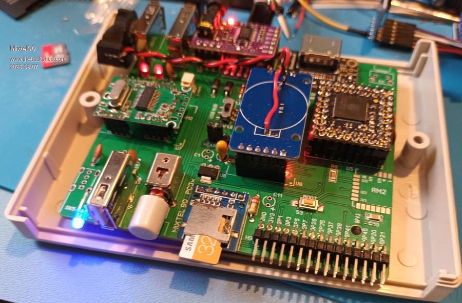

Oh dear. I hadn't spotted that. You can't plug the RTC in with the battery on top if you want to use the RM2015S enclosure. Options:
1) Use the RM2015M, which is easier to get but 50mm high. Price difference isn't much.
2) Solder the RTC module pins to the PCB without the sockets. Makes it very difficult to remove in future.
3) Remove the battery holder from the module and mount it off-board. There is plenty of space at the LH side of the box to stand it on its side, away from the RM2. I think it's possible to use double sided sticky to fasten it to a USB socket. I like this option.
PC3x UPDATE
Some of it's working with beta 2 now. SD card isn't yet, no idea why not. Audio is currently in progress - I'm trying to blob those horrible pads. RTC isn't keeping time yet because I've taken the battery holder off. USB seems to be fine with this wireless keyboard.
Installation using OPTION RESET PICO COMPUTER 3 worked first time. All I've needed to change was to change the keyboard to a proper one. ;)
The electrolytic caps are missing, as are the reset button and the USB fuse. All on order from Bitsbox so I'm not waiting for AE. I've no angled pins for the GPIO port yet either - they don't stock them.
SD card now working, woth 6.03.00 firmware. I've not done anything else other than change that and solder in the connector for the GPIO (I had enough 5-way that I bought for Elemento boards).
Audio is no use. Very loud and hopelessly distorted. No response to PLAY VOLUME. The links on the pads look right to me.
We have audio. :)
Back to the SD card. I has voltage (rather low though) and the pins have continuity to the PGA top-side pins.
Input voltage to the LDO is on the low side, output is therefore low and the output cal and SD card filter cap are both missing. It may have to wait until the new bits arrive.
Edited 2026-09-07 05:01 by Mixtel90

Pity about the audio. The 4 audio pins are floating, only used for mechanical support. I tested it from the jack output into 64R phones and a headphone amp (which I assume might be high impedance but I don't know). It could be that it feeds directly into a preamp stage.
One USB is missing here as I want access to the LED to sort out it's final height on the front panel.
I think the two ruby red LEDs are very old. We got them for a job at work but they didn't get used so I liberated them from the drawer when I left as the control panels section had already shut down then, they would only have got tipped in the bin.

Officially the chip is 1K min load on each channel, but the module already has 470R so I expected at least something reasonable on the phones. Output is stated as 2V p-p around zero so I also expected it to be loud, but not uncontrollable.
EDIT
All sorted! I had a bad solder blob. It had lifted the centre pad. A wire link fixed it. May this be a warning - to get good blobs drop the iron temperature to about 250C. :)
So, things to watch out for if you are interested in this design:
Be aware that the micro SD breakout board might be advertised as something different!
The GND pins on the USB=A sockets aren't connected on version 1.0 of the pcb! (There is a story behind this.) However they are easy enough to link to one of the shell pads.
Unless you take the battery holder off the module you can't use the RM2015S case.
Edited 2026-09-07 19:11 by Mixtel90

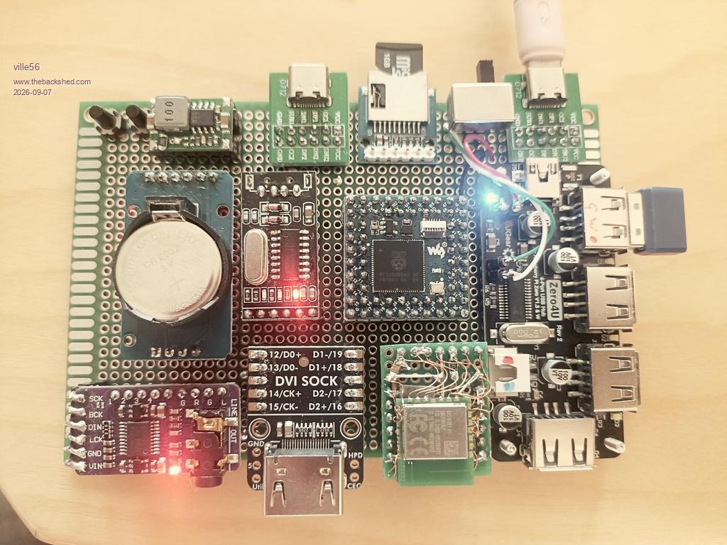

Posted: 09:19am 07 Sep 2026
it's ugly but it works ... even the WIFI "adapter" is working. The backside wiring is a rats nest with attention to the ground wiring. What is still missing is the 30 pin connetor for the IO pins. Will follow as soon as I'm able to "see" again. The wiring on the backside was a real strain to my eyes as my 3D vision slowly becomes very bad.
There is one minor problem left as the HDMI 800x600 has a lot of jitter on the image, all other resolutions do work fine. May be the monitor though.
Edit: It's definitely the monitor and it is with option resolution 720 only, strange ...
