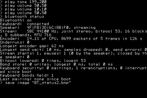

This is from the Milwaukee M12 Radio when working:
> bluetooth status
Bluetooth: on
Keyboard:  not connected
Speaker:   48:B5:A7:60:F1:91, streaming
Stream:    SBC 48000 Hz, joint stereo, bitpool 51 (of 53), 16 blocks, 8 subbands, MTU 716
Encoder:   15.5% of CPU, 7742 packets of 6 frames in 115 s
Underruns: 0
Longest encoder gap: 7 ms
Longest send wait: 61 ms, samples dropped: 0, send errors: 0
Stream starts: 0, pauses: 0 (0 by the speaker), closed by the speaker: 0
Bitpool lowered: 2 times, lowest 43
Bond store: 0 writes, longest 0 ms, total 0 ms
Keyboard security: 0 pairings, 1 re-encryptions since boot
Keyboard bonds held: 1
Last pairing: none since boot
Will post more diagnostic data in the morning as well if required.

Posts: 12051
Posted: 03:12pm 07 Oct 2026
Lyle
the report makes sense. The difference between working and failing comes down to when the stream gets started:
Plays: if something is playing when the M12 connects, the PicoMite starts the stream straight away.
Silent: if it connects while nothing is playing, the stream is set up but not started, because of the default OPTION AUDIO BLUETOOTH 60. It's only started when PLAY begins, which may be minutes later.
So the M12 accepts a stream that starts immediately but not one that starts later. On our side, the likeliest cause is a gap in the code.
The likely problem: the speaker closes the idle stream and we never reopen it.
Some speakers close a stream that has been set up but not started for a while, while keeping the connection itself. btstack reports that as a stream release.
Our release handler (BTAudio.c:641) stops the timer and counts it, but leaves our state at "open". Nothing re-establishes the stream.
When PLAY starts, bt_audio_service asks btstack to start the stream. The media channel has gone, so btstack refuses at once (avdtp_start_stream: no media connection).
bt_audio_service then falls through to throwing the sound away in real time, and does so on every pass, for as long as the speaker stays connected. That fits "won't play at all" exactly.
Two other possibilities:
The M12 refuses or ignores a late start. We don't watch for btstack's "command rejected" event. And if a start request is never answered, btstack's pending-start flag stays set and every later start is refused.
The stream does run, but the M12 doesn't play it. For example, it may have switched itself to another source after sitting idle. Nothing in our code could change that, short of AVRCP.
What would settle it: one BLUETOOTH STATUS taken while the M12 is failing (PLAY running, no sound). The counters reset at each STATUS, so it should be the first one after the failure.
STATUS shows Meaning
idle and closed by the speaker: 1 It closed the stream and we never reopened it (the likely case)
idle, Stream starts: 0, closed 0 It refused or ignored the start request
streaming, packet count rising, no send errors The audio reaches it, and the M12 itself stays silent
A second test would also help: start a file so the M12 plays, then leave it silent for over 60 seconds so we pause the stream, then PLAY again. If it plays, only the first late start fails, which points to the close.
A workaround the tester can try now: OPTION AUDIO BLUETOOTH 0. The stream then starts as soon as the speaker connects and is never paused, which recreates the case that works. The cost is that the encoder runs all the time, about 15% of the CPU at the M12's 48 kHz.
The rest of the working-case STATUS looks healthy:
48 kHz: the M12 runs at 48 kHz even though we prefer 44.1. Either it supports only 48 kHz, or it opened the connection itself and chose 48 kHz. Both are handled.
Bitpool: it dropped twice, to 43 at lowest, and recovered to 51. With a longest send wait of 61 ms the link is a little marginal, and the adaptation is doing its job.
No losses: no dropped samples, underruns or send errors.

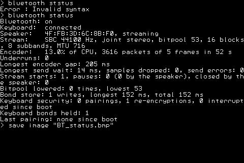

Bryan1
Joined: 22/02/2006
Posts: 2297
Posted: 11:07pm 07 Oct 2026
Ok so today's fun has started
flashed the last uf.2 posted and the first thing I do with a new flash

Also re-tested the AX1801 car stereo, this is still dropping audio briefly approx every 3 seconds. Car stereos might be a challenge as they are mostly configured to work as handsfree as well, not sure if this is a factor.
This is tested using PicoMiteRP2350BTH with ST7796S LCD panel attached, this works fine with the Bluetooth dongle and M12 speaker.
Regards, Lyle.
