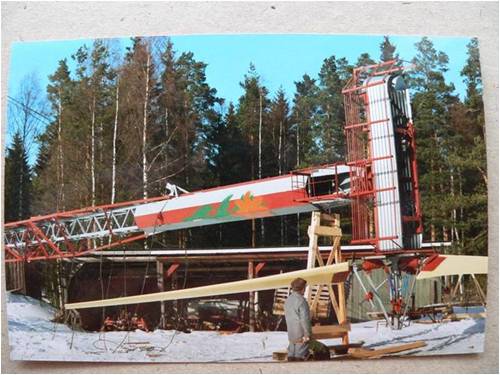

Posted: 11:37pm 06 Oct 2010
that anemometer looks very rugged Janne...i hope you get it to work the way you want
your projects page is an inspiration looking through it ...i particularly like this pic....
mind boggling ....
niall
Janne
Joined: 20/06/2008
Location: Finland
Posts: 121
Posted: 02:49pm 10 Oct 2010
Glad you enjoy the pics in my projects album. The big machine was quite impressive with the 12m blade set, but ultimately it was a failure as it was treaded with various kind of problems, most of them relating to the pitch mechanism. I do have a 2hr+ video where my late father discusses about the machine with lots of info about bigger mills in general also, but I'm having a hard time figuring out how to host the 2.5GB video file. If anyone has got any bright ideas about that, mayby drop me a PM?

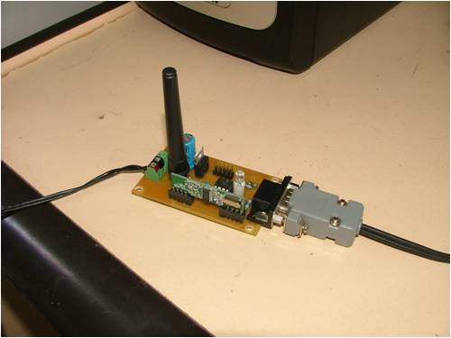

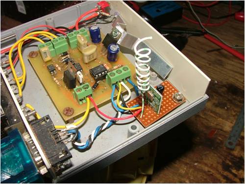

Posted: 01:39am 03 Jan 2011
With a bit of free time over the Christmas break, I've been working on a few changes to the PicLog. A few software updates, and going wireless.
Bought a couple of 433MHz wireless modules from Jaycar Electronics to try out, a transmitter and a reciever module, Link. Fitted the transmitter to the PicLog circuit board.
I curled up the aerial to reduce its gain, the reciever is only a couple of meters away. I used one of Petes logging circuit boards as the receiver.
With a few software changes to the PicAxe code for both modules, and a lot of help from Pete, I soon had the PicLog working wireless. Next I'll refine the code and document it onto the web site, along with details on wiring up the modules. It will be interesting to see what sort of range I can get with a standard dipole aerial, and maybe experiment with a yagi or old satelite dish.

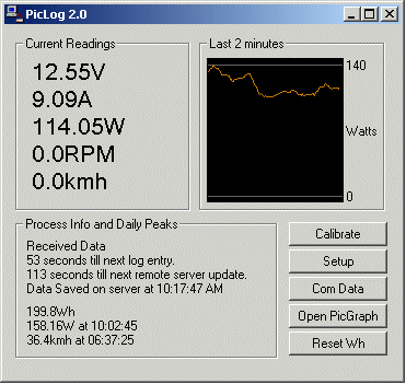

I'm working on a update to the PC software. A few more features, like daily peaks, and a running watts graph to add a bit of bling. This screen shot is the new software running on my Win2k server.
vasi
Joined: 23/03/2007
Location: Romania
Posts: 1697
Posted: 03:24am 03 Jan 2011
Hi Glenn,
Very nice project! About software, it is possible to add custom user-defined inputs?

The PC software is written in JustBASIC, the source is included in the download, so you can add as many functions as you like.
The PicLog uses a 08M chip, with only 4 inputs. There is no reason why you couldn't use a 20M chip or similar to get more inputs, just change the software to suit.
