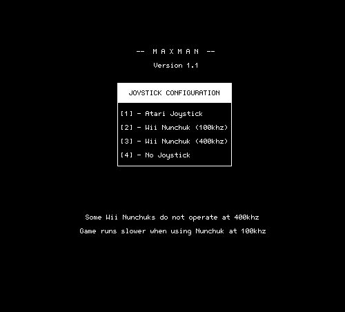

OK! We now have the Wii Nunchuk working with MaxMan!
The problem in getting the nunchuk to work was due to the speed of the i2c bus.
At 400khz, it just didn't work. Drop it to 100khz and it was fine.
I thought that the reason was that I used 10K pullup resistors on the data line so I changed these to 2K (as described in Geoff's manual) but this made no difference.
One trade off with the slower speed is that the reading of the nunchuck is slower so the game runs slightly slower when using the nunchuk. The Atari stick is as fast as the keyboard response.
If you have a nunchuk/maximite that works with the higher speed, just edit the line in BASIC to run faster.
Version 1.1 of MaxMan is almost ready. The only additions have been:
1) Faster key response on the "Insert Coin" game start prompt.
2) Wii Nunchuk support.
The game now currently supports Keyboard, Atari Joystick and Wii Nunchuck.
I will hold releasing version 1.1 till I hear from Geoff if there are any plans for a LOADBMP command in the next release of MMBasic.
If not, I will convert the screen to a large font and use that as a faster load technique.

I've also provided the selection of the nunchuk at either 100khz or 400khz. It appears that the genuine Wii nunchuk I have only operates at 100khz whereas some of the clones run up to the 400khz.
A bit of a bummer because at 100khz, it slows the game a tad.
The Atari stick is the best option for this style of game.

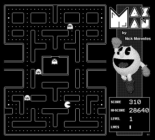

MaxMan 1.1 is here!
New Features over 1.0...
1) Fast key response at the "Insert Coin" prompt for the start of a game.
2) Slightly more aggressive ghost chase intelligence.
3) Support for Wii Nunchuk with 100Khz and 400khz IC2 transmission speeds.
4) Fast loading of game screen via fonts file!
This is the final version. Project finished. Enjoy!
Version 1.1 Download: 2012-04-04_060016_MAXMAN_1.1.zip
Edited by Nick 2012-04-05
