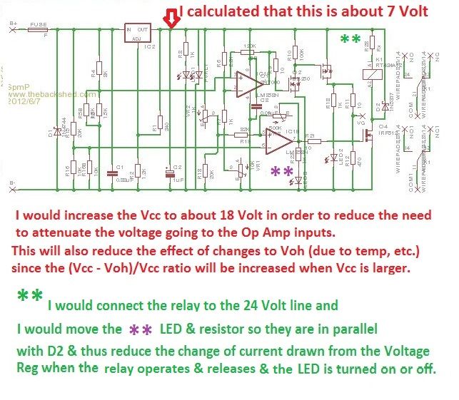

DeltaV is the difference between battery voltage with shunt load on or off. It was actually more like 1.75V
The timescael is 20us per dvision.

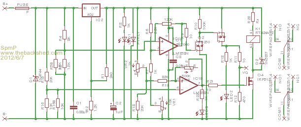

Here is the circuit on the PCB, I added another resistor in parallel in the bottom leg of the resistor divisors from Vb.
The shunt is connected as with the ghurd controller and is supposed to limit battery voltage. As I said, I will try the converse with the circuit in a diversion arrangement (switch panel on and off).

I have made some suggestions on your circuit below. I found some of the figures impossible to read.
You're operating the opamp on a 7 volt supply. This is unnecessarily low when the battery voltage is 24.
You will of course, have to change some of the resistor values.
