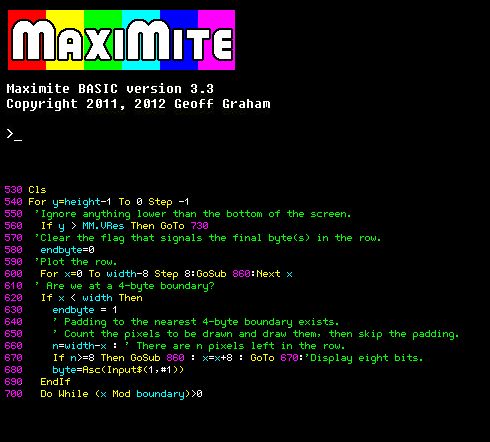

Here is yet another idea of how colour could be of benefit to the use of the Maximite.
Below is a mock-up screen of a sample program listing. Colour is being used to highlight line numbers and labels (purple), REMark lines (green), MMBASIC commands (yellow), variable (cyan) and everything else is white.
This makes the listing, especially a complex one, a bit clearer when using the maximite to program directly on.
This colour listing option should be turned off by default to the standard B/W text and be turned on/off by pressing a Function Key.
(The colour assignments shown are only a mock-up and could be better defined, but it's just done this way to convey the idea)

Nick,
That is just a perfect idea, and because the text is tokenized it should not be that difficult either.
Just brilliant!
edit: That should be possible with terminal mode too doesn't it. There are codes for color in the protocol.

A great idea... a few practical considerations though.
I thought of colour coding the text for the full screen editor but then I realised that the editor needs as much memory as it can get. As a result the editor now switches to monochrome when it loads (this frees up the memory) and then on exit switches back to whatever colour mode the user had set (there are four modes; monochrome, 2-bit colour, 3-bit and 240x216 3-bit).
I could colour code just straight LISTings on the screen but I am not sure that people use LIST much now that the full screen editor is available. Another factor is that the colour coding would only work if the MM was in a 3-bit colour mode.
