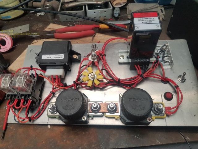

My banks in the motorhome (200 ah @ 12v winstons and 800 ah @ 24 v sinopolys are now over 3 years old.
At that time about all we could find for monitoring/protection were Junsi cell loggers, so the banks were set up using those as protection for out of balance cells.
One was set so if a Junsi alarm call for an over volt cell happened, a voltage stepper came into ply, sending a higher than programmed voltage (voltage sensing wires) to the Rich Supercombi power management centre. This made the SC think battery was over, so it told the 3 solar regs (all data cabled together) to stop charging. At the same time a water heating element was switched on to "pull back" any errant cell. After a set time, usually 5 mins or so (set by timer) it all reverted to what was happening before the vent. A counter told me how many times this had happened, or how much hot water I had !
Another junsi was set to set off a piezo alarm on high or low voltage.
The junsi only drew it's operating power from the first 6 cells, no problem for the 12 v bank, but 2 of them on 24/7 created an imbalance meaning you had to stop charging at a lower voltage and charge at a slower rate or 7 and 8 would run away.
Remember this was years ago and it was a real problem.
Now both banks are fitted with balancers, probably not necessary for the 12 v bank as they seem to stay pretty balanced anyway, but essential for the 24 using the earlier regime.
There has been call since then.
In fact the Junsi is disconnected, just plug it in occasionally to check, never more than 20 mv.Plug it in when travelling though.
However I have added a different level of protection.
On the battery positive lead I have installed 2 levels of protection, one is a high/low voltage cut out from VDO. The levels are adjustable and this drives a Gigavac latching relay. So if voltage goes past the high or low parameter the Gigavac "unlatches" and stays that way until I switch a current to it to "latch" it again. This way, if I am away the battery disconnects and stays disconnected.
I also have another high voltage only device driving a NO Gigavac contactor.
If the voltage goes over 30 this one drops out allowing the contactor to go to its normally open state. So fail safe is taken care of.
Why the 2 units ? It is electronic, therefore at some time in the future it will fail, maybe tommorow, maybe 100 years, I don't know when.
Also I use solid copper bars 4 mm thick to join my cells (64 in big bank) with no problem, been through a wide range of temps as well. I know the logic says you must buy expensive links but that is not my experience, the copper bar is many, many times cheaper than links.
Oh, and from my experience, with a balancer in place you do not really need much else. If I was to set up another system it would have a balancer and similar high/low voltage protection. These cells can take a lot of abuse, even if you had a single runaway it would not get to any dangerous area, if you have your parameters tight.
So, there you are, my current BMS, all off the shelf, anyone want to buy version 1 ?

Your gigavac latching relays aroused my interest as I was not aware of that brand.
However, on their website there seem to be only high voltage latching relays I could find.
What I would require; to replace the 12V 80A latching relays I had used with my 24V battery bank but are too low voltage for safe usage on the 48v bank; is a latching relay that could disconnect 150A @ about 56V DC.
This would be the worst case situation should something short out the bank while I'm away.
What rating is the relay shown in your picture? And where did you get it from?

Hello Klaus,
Gigavac is well known, they do make a great product.
My bistate (latching) relay is http://www.gigavac.com/sites/default/files/catalog/spec_sheet/gxl14.pdf
350 amps. Only listed as 12/24 v coil but I have found them to be very easy to work with and would not be surprised if they will make one with your required coil voltage
I brought direct, the guy you want to send an email to is Marcus, send it to info@gigavac.com and mark it for his attention and ask if they can make one of the above with your size coil, I would not be surprised if they say yes.
Not cheap but then what piece of quality equipment is ? About $200 by memory.
I have about 4 in my setup, I use 2 NC to divert 2Kw of solar to my hot water heating, through 3 pairs of elements, each a 12 and 24 volt in series.
1/2 an hour in the middle of the day gives me 50 ltrs of very hot water.

@ 3.59 volts they are all even
@ 3.61 volts they may not be, the full cells are starting to spike up. the manufacturers say there is some tolerance and it is dissipated as heat but I tend to read that as "acceptable cell degradation" to reach a cycle target number.
a standard constant voltage charger only looks at the average pack voltage so at 3 or 4 amps the first cell to hit 100% will shoot up in voltage in a few seconds, max out the 2 amp shunt and keep climbing till it triggers the shut off.
the more cells in series the more likely this is going to happen and the smaller the parallel cells the quicker the spike will be.
The cells are very well behaved when they are new, I have always expected to have to change the charging strategy as they age and develop some quirks but the oldest ones I look at are still below 2500 cycles and seem to work fine, no leaky ones, no hot ones so I have kinda given up, we check the cells with a multimeter once every three months, check the shunts for faults and cycle the contactors every month and that is about it.
Posted: 06:42pm 13 Mar 2017
A few seconds ?
That is terrifying.
If this is true, it needs a shunt regulator on each cell hooked up through an opto isolator for instantaneous charger shut down.
Not difficult to do, just difficult to believe because nobody else seems to need that.
I would have thought that voltage sampling of each cell every couple of minutes would be plenty fast enough to detect a charging voltage spike on one cell.
If the voltage rise is as explosive as you say, its not really a problem, if its real and expected.Edited by Warpspeed 2017-03-15
busman
Joined: 30/10/2016
Posts: 21
Posted: 07:36pm 13 Mar 2017
I am sure I have the most expensive pack of the people having this discussion, and a few years experience with my 2 packs as well.
These things are pretty tough, some of the mistakes made in the early days (like overcharging, flattening to 0 volts, dead shorting etc (in one case for 6 weeks)) resulted in bulged cells, but many of those have been rescued and are still in work today.
Everyone seems to think they are such babies, but that has not proven to be the case.
So very easy to want to protect your expensive investment, in a couple of years you might just be saying "why did I waste my time on that?" when I could have been fishing or whoring, whatever gets your goat.
In my experience it just ain't necessary and I have a pretty big investment in these things. If I thought it was the Junsis would still be connected etc etc, but they ain't, that must tell you something. You just do not need the level of information you guys are trying for, it can all be done pretty simply now with off the shelf stuff.
William
BTW we routinely see 100+ amps coming in from the solar and we can charge at 140 via the supercombis, without our latest steps, that was not possible
