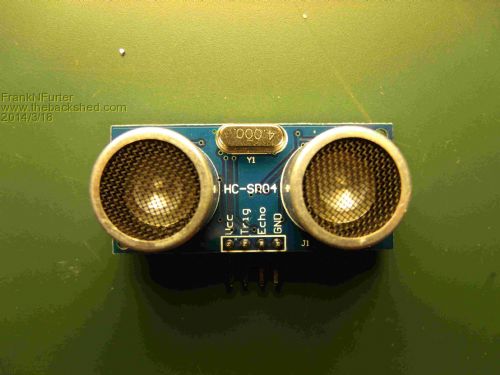

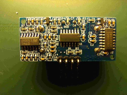

Hi!
My two sensors are looking similar at first sight to Pauls but they are a little bit different!
They work very well with MicroMite Beta 15:
"to near" => -1 (nearer than 2cm!!!) and "no object" => -1!
I am very pleased!!!
Thanks Geoff!!!

Frank N. Furter
Joined: 28/05/2012
Posts: 1185
Posted: 09:40am 18 Mar 2014
Hi White Wizzard,
here are pictures of my modules:
@Plasma: That's really a very interesting site!
Frank
Posts: 2998
Posted: 10:10am 18 Mar 2014
Hey Frank,
That is EXACTLY like mine. Thanks for just saving me the time to take photo's here!
As you say, a very slight difference from palcal's when you look closely at component positions.
At least we all have working programs thanks to Geoff's Beta 15.
I am still waiting for three more cheap HC-SR04s to turn up here. Hopefully they may be different again to these two types and will also work with Beta15.
Will update you again when they arrive. . . .
