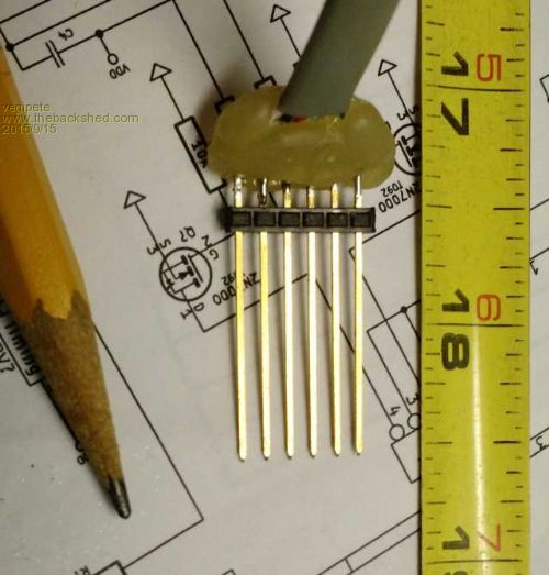

Here is the plug I use for programming:
The long pins (tape measure is inches) are key to providing springiness so that light sideways pressure lets each pin make good contact. Note also 6 pins! Yes, one of the PICKit pins is not connected, but I prefer all 6 pins because it reduces the chance for error.
Also, the choice of USB jack is evil. (That's just my opinion. ;-) It is not super easy to hand solder because the pins are part way underneath. Solder it on first, then check for shorts, before soldering other components.
