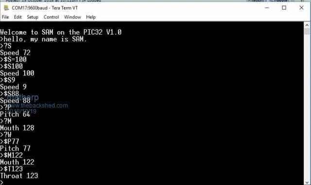

Here is a version that I think is much better, should run on any variant of MX150/170
2018-10-19_214652_23_TTS.X.production.zip
This has the following changes/features:
40MHz clock for better compatibility with MX150
Improved sound quality by synchronising PWM changes with the PWM output
Echos characters as you type them
Set speed, pitch, mouth and throat using the commands
$Pnnn
$Snnn
$Mnnn
$Tnnn
Read current values of speed, pitch, mouth and throat using the commands
?P
?S
?M
?T
  Quote  (Peter, you still have the wrong value for U1RXR in your code...)
No I haven't - 0b0010 = 2
Complete MPLabX project
2018-10-19_215022_23_TTS.X.zip

...setting and reading values doesn't work for me:
I send: $S100 for speed 100 ,get back "00" and SAM says zero, zero...
When I send ?S he says s...
Posts: 12186
Posted: 12:51pm 19 Oct 2018
  Quote  ...setting and reading values doesn't work for me:
You need CR after each command - no spaces, no LF
Here is a version that filters out invalid characters to make it a bit more robust. Invalid commands are just ignored.

Hmmm, I can read the values with ?P or ?S, but when I try to write $P100, SAM always says zero, zero...
I don't know if Br@y++ sends an LF, but the reading is OK now...
Posts: 12186
Posted: 01:35pm 19 Oct 2018
What about if you try
$P78
What do you get? All my testing is with teraterm which works perfectly
Frank N. Furter
Joined: 28/05/2012
Posts: 1186
Posted: 01:41pm 19 Oct 2018
SAM says "eight"...
I don't know what's wrong...
Is it possible that Br@y++ sends to fast? I type the text in one line and press send. Where ist the "7"?Edited by Frank N. Furter 2018-10-20
Posts: 12186
Posted: 02:04pm 19 Oct 2018
  Quote  SAM says "eight"...
Sounds like your terminal emulator is dropping characters or the internal clock on your MX170 is way off, I assume you get ?
"Speed 8"
Try this version and play with different values to see if it is always the 7th character that is dropped.
Is the speed changing as per the instruction?
2018-10-20_000259_23_TTS.X.production.zip Edited by matherp 2018-10-21

No change! Unfortunately it is not possible to set different speeds with Br@y++. With Terraterm it also works with me.
I think the characters get lost while the "$" is being responded to. Probably it would be better to react to CR/LF and evaluate it afterwards...
I don't think the sign will get lost - if I transfer a sentence to speak it works too.
It is possible that there are problems if the conversion is to happen later over a µC...
Posts: 12186
Posted: 03:34pm 19 Oct 2018
Just tried it with realterm which does batch send and it works. Also works with MMEdit in ASCII terminal mode so I don't think the error is in the TTS code; get a decent terminal emulator . The processing time for $ is trivial compared to the millisecond it takes to send a character at 9600 baud so there is no point in changing the way it works.
Is your terminal set up for 8N1?

I think you are right with my terminal program - I tried HTerm and everything runs as desired! It seems that Br@ay++ uses the "$" for some internal settings and does not send...
