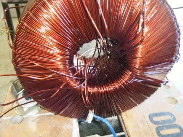

OK, time for an update to this thread I originally started.

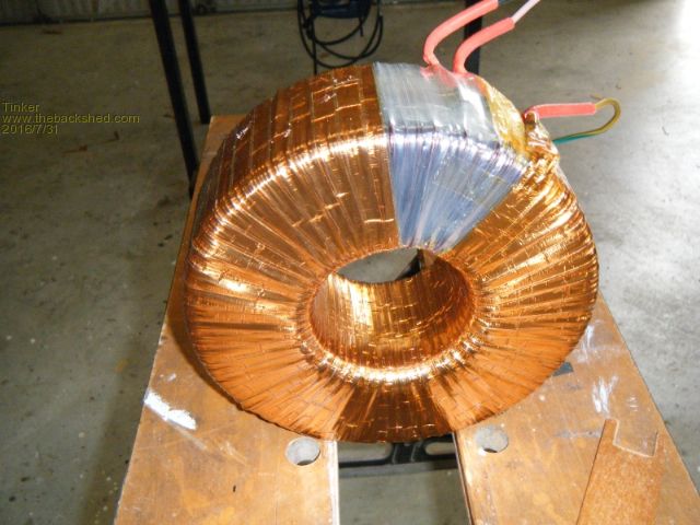

The electronics for this project have been finished for quite some time and my Aerosharp 3Kw toroid transformers were waiting patiently for me to tackle the rewinding.

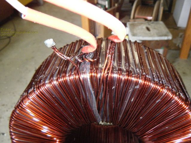

As soon as had I unwound the mylar film strip hiding the connections I started wishing that I had procrastinated a little longer.....

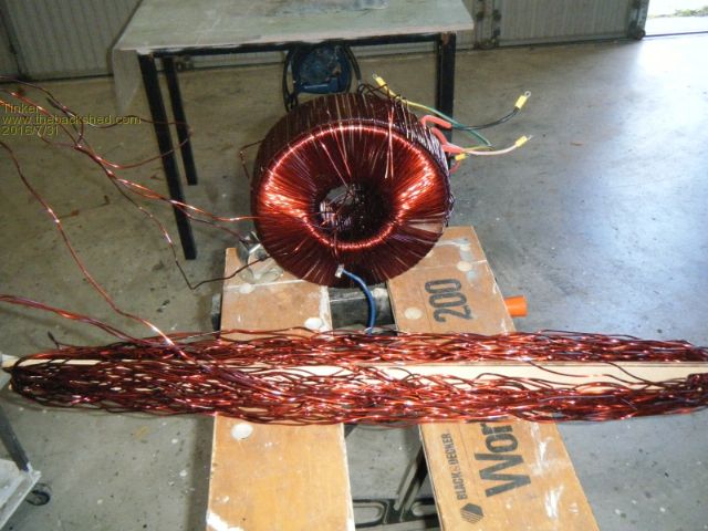

The top winding (250V) was wound 3 in hand with 1.8mm diameter wire, nothing unusual there. Only this time they wound the 'three in hand' literally. Yes, three wires side by side wound on at the same time.
Nothing like the 'wind one wire at a time and then connect them in parallel' idea I had faced with my first toroid conversion (tinker's inverter project).
So, off it had to come, all three wires were wound onto my shuttle at once.
This was about 10 times harder to do than the one wire at a time method. My shuttle was getting very full with all that extra wire. And just to give me more challenges they managed to sneak in the odd riding turn (one wire being trapped under a subsequent turn of the same wire)which is not easy to clear with three sets of wires adding to the confusion in the toroid hole.
Luckily they only wound on one layer then joined the wires for the next layer so I had a ready place to apply my side cutters.
There was no mylar tape at all wound on between the two layers, perhaps the factory had a tape shortage as I noticed later on the inner, 230V winding had only a non complete mylar tape covering.
Anyway, with half of the 250V winding now on my shuttle I had to carefully unwrap it along the floor of my garage and adjoining workshop, some 20m distance in total. The wire was longer than that.

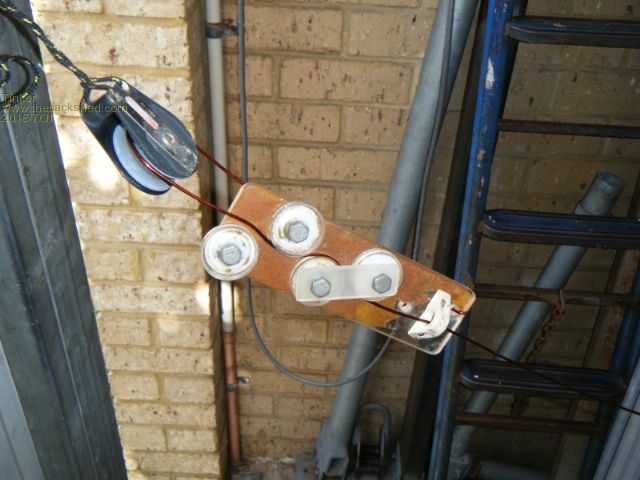

Now came the tedious task of separating the 3 wires which, naturally, were by now twisted around each other. Then I straightened each wire so it could be coiled for future re use.
I use this idea for wire straightening after first pulling the wire through the funnel like shape of a cartridge gun nozzle to remove the bigger kinks.
The wire is run through the sheave tied to the door frame. Its end is fastened to the straightener and thus I effectively could straighten wire twice as long as the 20m distance I had. Which was just as well as the rain outside did not encourage walking out the shed door pulling on the wire.
Then came a repeat of the above with the other half of the 250V winding.

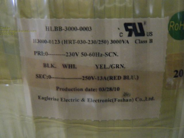

Surprisingly, when I compared the labels on my toroids (which were all made on the same day) the toroid windings were quite different from what madness posted on his toroids. All were made by the same manufacturer and mine only made a few days later of the same month and year.
