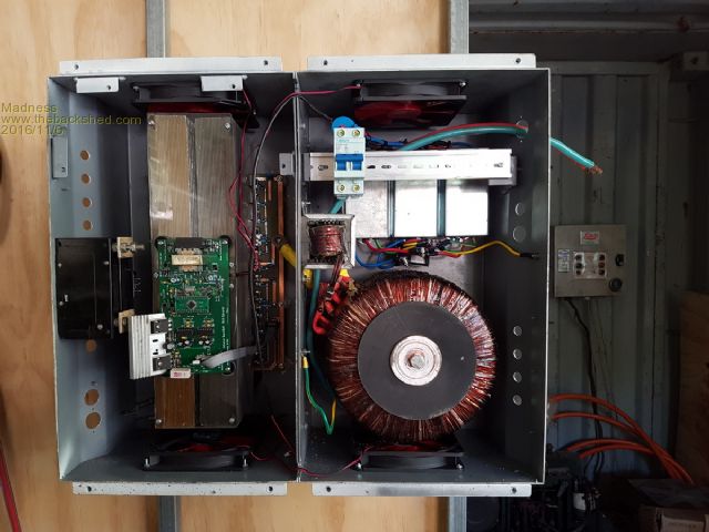

The Inverter is now on the wall, I figured it will be far easier to assemble it from here that way as there is no way I could lift it when finished.
The major parts are now in place, top right is 3 filters from output of Aero-sharps. There is a perspex panel to go on the top left that will have screen and buttons for Arduino based monitoring system I am working on as well. It will control fans as well as data logging temperatures, current and voltages, this will be accessible via ethernet and display current information on a 3.5" TFT LCD with touch screen.

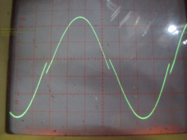

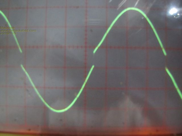

Big problem I have though is bad wave-form as shown below, something wrong the timing, have tried 3 different power board layouts, get the same result with all of them.I am going to try ordering components locally for the control board to see if that rectifies this. Images are with no load, adding up to 2.4 makes the wave blurred and lots os of squiggles in it, the toroid and choke make lots of horrible noises when this happens also.
These are from the the 2 sides of the secondary output.

Thanks to Tinkers tip of connecting the CRO across the AC out (did not do that due to my inexperience) I am getting a on a small test board with 4 FETs. Also, I get the same with the full-size power board with just 4 FETs. However, fully populating the board is a failure. Works with no load, although Sine wave has some distortion, running at 2400 watts causes the sine wave to be very distorted. Yet with just 4 FETs it will run the same load happily and the heat sink only rises 2 degrees above ambient.
Any suggestions welcome, what I am planning to do next is add FETs 4 at a time and then test with the same load to see when it starts to get pear shaped. Not sure if it could be some of the FETs are faulty, they all test fine at around 2 M ohm with the meter. Also, I wonder if it needs the complementary drive buffer as mentioned in the previous post.

Mad you have made some progress, you have discovered that the waveforms and power dissipation seem ok when just 4 fets are in the H Bridge, then get worse when fully populated.
If you are using the IRFB4110 fets then each has a gate cap of 9620pf multiplied by the number of fets in cct, perhaps your driver chips are running out of grunt to switch the mosfets cleanly when more are populated, or there is a higher resistance or bad connection in the ribbon cable between the control and power board.
I would put your scope probe between 0v and each of the mosfet gates to check that the gate drive signals are clean sharp steep sided transitions with no oscillations. Perhaps swap out the driver chips, one may be damaged from previous issues.

Thanks for the input, I actually have a very nice clean Sine Wave now thanks to your tip regarding connecting the CRO.
However still getting exploding FETs, had 4 FETs on the PCB today, ran it up to 2.2 KW for about 5 minutes running a fan heater, there was just a very tiny distortion at Zero crossing, similar to OZtules early results. Then I turned the heat off and just left the fan running, after about 45 minutes BANG. I need a blast shield for this #%^!@& thing. It ran perfectly for that 45 minutes, just a little buzz in the transformer, which I get in all 3 different transformers I have been using.
Postmortem I found 1 Fet with a large crater, 1 with a big crack and other 2 shorted to the gate. Chinese IF2110 that makes the SPWM was also dead.
I have replaced the 2 IF2110's with genuine ones I had on hand and replaced the FETs. I have had it running for about 30 minutes with 1200w load on 4 FETs since repairing it. Now going to try with 8 FETs.
