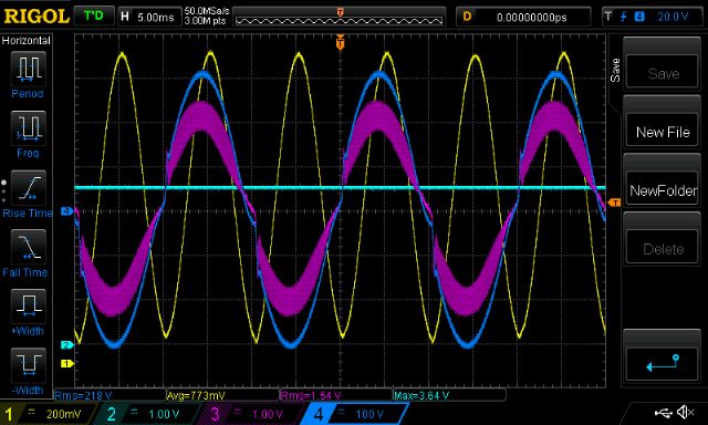

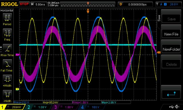

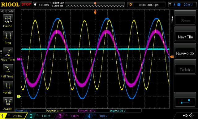

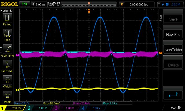

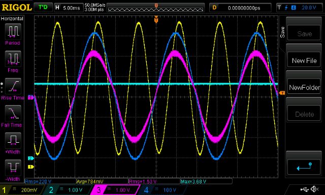

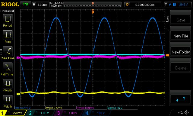

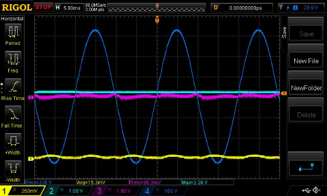

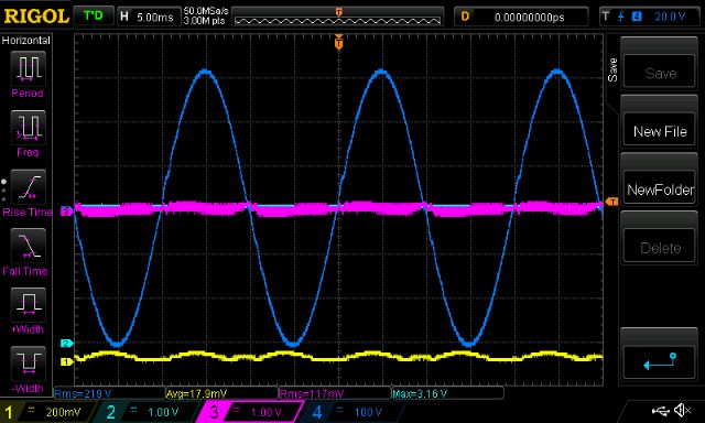

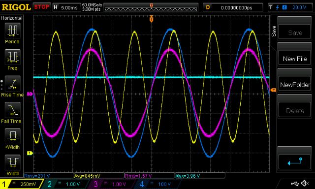

Part 7 Primary current waveforms with different inductors plus efficiency calculations
It is time to look at this inverter prototype under significant loads.
My test gear can provide a DC supply up to 10 Amps only.
So this means I have to use the 2 x 100A 12 Fiamm batteries to supply the required grunt.
Under load they run at about 25V so I removed turns from the primary (was 25 T at 0.7Vrms/turn) to now 19T.
Test conditions now are:
AC load 480Wrms and it’s a quartz halogen light so the power factor = 1.0
AC output 230Vrms
DC supply around 25.5V
I test 3 inductors.
2 turns in the ferrite E core (50uH)
7 turns in the laminated steel toroid (16uH)
13 turns in laminated steel toroid (50uh)
Yellow trace is DC bus current, 6.1 Amp/div.
Blue is AC output
Pink is primary winding current, 24.4 Amp/div.
The oscilloscope calculates the RMS voltage of this which I use later.
first is the E core at 50uH at idle
then under 480W load. Notice the large primary current swings from PWM.
This is still eliminated at the secondary winding though.
next is the 16uH steel toroid at idle. MORE PWM current swings than the 50uH E core
then under the same load. LESS PWM current swings than the 50uH E core.
hmm.
last is the 50uH steel toroid at idle. same low PWM current swings as the 50uH E core
and under load, we get the lowest PWM current swings of all.

Posted: 09:39am 05 May 2017
There will also be a constant added loss due to magnetizing and eddy current losses in the transformer toroidal core. That could be quite substantial, probably accounting for most of the missing 22 watts of loss. That should also show up as as parasitic idling power under no load.
The peak to peak PWM current will always be inversely proportional to the inductance of the primary choke, but this inductance is not going to stay constant.
The ferrite will very quickly saturate at only a very few amps. It should work well to reduce mosfet switching losses under no load idling conditions, but will do nothing at all to reduce the PWM current peaks at full output power.
A tape wound toroidal choke will take about four times the magnetic flux as ferrite before it saturates, and as it probably also has a much larger cross sectional area than the ferrite E cores, it adds even more to that. But it too will eventually saturate.
The way to do this is to use a laminated steel core, but with a large air gap. A grid tie choke will give us exactly that, a pair of C cores with an introduced air gap between the two halves. But do not expect a choke out of a 1.5 Kw grid tie to work in an 8Kw inverter at full flat out power. We are going to either have to string several re wound grid tie chokes together, or go to something similar but larger.
There is also no reason why we cannot use both a small ferrite choke in series with a much larger steel cored choke, although if the steel choke is well up to the job, it will probably be found to be all you need.
Conclusion.
Adding a choke to the primary is a very good way to reduce peak PWM current which will both reduce mosfet switching losses and improve reliability by reducing the stresses on the mosfets.
Any choke will eventually saturate if the ampere turns are too high for it.
More turns creates more inductance, but lowers the saturation threshold.
Once it has saturated, the inductance effectively falls to near zero.
Definitely not what you want to happen at peak output power.
There will be an optimum number of turns which gives the highest inductance, where it still has some safe margin below final saturation.

Posted: 01:08pm 05 May 2017
Warpspeed:
I like how the testing of the 3 inductors shows how things change as power is increased. When measuring their inductance, we test with a tiny current from the LCR meter. We need to test under realistic conditions to prevent saturation in the designs.
I plan to change the toroid over to the 3kW one and test at about 1500W to see how the last 50uH steel core choke goes than.
I find this result applicable to Tinker and Madness's problems with damaged fets.
They had issues when using the E core chokes and we all were wondering why.
Gate drive was proven to be good.
I now think the E core choke is likely the source of the problem.
I measured idle current with the above setup and it is about 0.27A at 27.3V DC
This is about 7.5W and I wonder if it is constant over all loads.
I need to read more on eddy current (and other) losses in the toroid.

Posted: 01:13am 07 May 2017

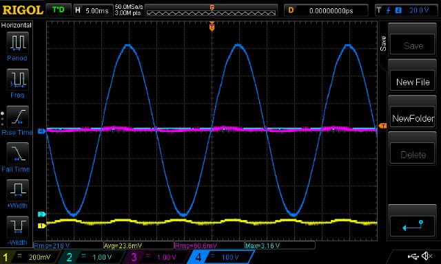

The inductor test circuit I used was based on that linked by Solar Mike.
http://www.thebackshed.com/forum/forum_posts.asp?TID=9409&PN=1&TPN=1
Instead of using a 555 based drive, I used an arduino.
I liked having complete control over the pulse width and repetition rate.
No fiddling with time constants and such.
I found that you can't ever have enough capacitor bulk charge. Small amounts of voltage sag during the ON pulse mean the calcs are not quite right. They require a constant voltage.
But saturation is a reality.
I tested today the large E core ferrite with 5 turns.
This adds up to about 182 uH
At idle we see a very smooth primary winding current. The 182uH smooths things out really well. Idle current is .27A (at 27.3V power is about 7W)
Yellow DC bus current, pink primary winding current (41mV/Amp both scales)
Blue is AC output, light blue is PWM duty %
its when a proper load appears we see the E core ferrite find it's all too much
and saturate.
This also has the output AC waveform fairly well distorted too.
The PWM current swing during peak AC voltage is about 700mV or 17 Amps.
Once a decent amount of current pre-exists in the inductor, any transient current sees a much less inductance.

Today I put the Ecore ferrite in the kitchen oven, baked at 200C to soften the epoxy keeping the two halves together and quiet.
Using the 4" grinder I added an air gap of about 1mm with rounded edges in the middle leg of the E.
Al = 7.9uH/T2 ungapped, with the roughly ground gap I have now, it's 0.56uH/T2
9 turns gives a measured 48uH.
The air gap means saturation will be at much higher currents.
Let's see how it goes.
(yellow is DC bus current, pink is primary current, blue is AC out, light blue PWM%)
this is at idle. not too bad PWM current swing. You can reduce this further with more inductance of course. See some of my previous posts on this subject. The same 7.5W idle power.
This under load. Note very similar PWM current swing with the higher amps.
No saturation now at 435W test load. And a nice looking AC output.
Efficiency now 90% (19.3 A, 27.35V gives 440W RMS)
Getting 9 turns of 50mm2 cable through this core will not be possible.
I found getting 9 turns of 6mm2 earth wire into it hard enough.
The slot dimension is 44 x 12mm
So the search for a simple and cheap 50uH choke good for 100 amps continues.

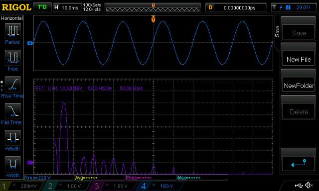

Time to look at waveform purity. I calculate the THD of this prototype inverter to be about 0.5% (50Hz 70db, 3rd 25db, 4th 25db, 5th 20db, 6th 20db) via the DSO's FFT.
Not too bad at all.
