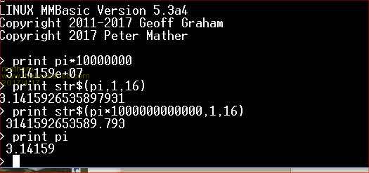

Please try this.
print 99999 + 0.1
print 100000 + 0.1
print 100001 - 0.1
print 99999 - 0.1
OUTPUT:
99999.1
100000
100001
99998.9
Thank you !
Wolfgang
Posts: 12244
Posted: 01:17am 22 Apr 2017
Try it on an ordinary Micromite and you will find the same. This is just the way that the Micromite code defaults output of floats. Use str$ to get more reolutionEdited by matherp 2017-04-23

  matherp said   Try it on an ordinary Micromite and you will find the same. This is just the way that the Micromite code defaults output of floats. Use str$ to get more reolution
All right, thank you !
