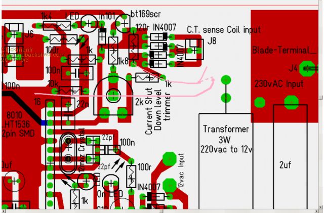

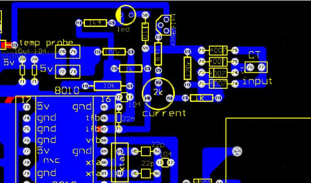

" What disturbs me is that it can not be reset without physically switching main power off. "
I just press the momentary reset. You don't need to power down. Shorting the 120r to ground zero's the 5v and everything else, releasing the switch, the 5v recovers very fast, the 8010 soft starts. It is designed to soft start from zero volts. The reset momentary switch has been triggered under all circumstances, and the result is the same.... perfect restart.
This chip is designed for this kind of nonsense, as it is after all designed to run on the tail end of a tl494 voltage step up system. It has no reset , as it was never intended to be anything other than slave driven by the availability of voltage or not from my reading of it.
Here is my board's current sensing part.
I'm not an electronics engineer, just the village idiot, and would not know what a ground plane was if it popped up in my porridge... but I can make most things work as a general rule.
...........oztulesEdited by oztules 2017-10-03

Thanks Oztools, looks like I have properly wired components around SCR.
And thanks for all explanations.
Have you measured what voltage is there on CT input at 9 or 10kW power ?

"Have you measured what voltage is there on CT input at 9 or 10kW power ?"
No I have not bothered to do so..... I am only interested in where it triggers, and that will be coil and shunt dependent..
At the moment I am using 2000t coil, which is way too big, but makes no difference with a shunt across it. If your coil has less turns, then the components may change if the trimmer is out of range. ( 120r may need to be bigger or smaller)
Minimum trigger is about 4kw and goes up from there with my coil and those component values.
You look close to success.

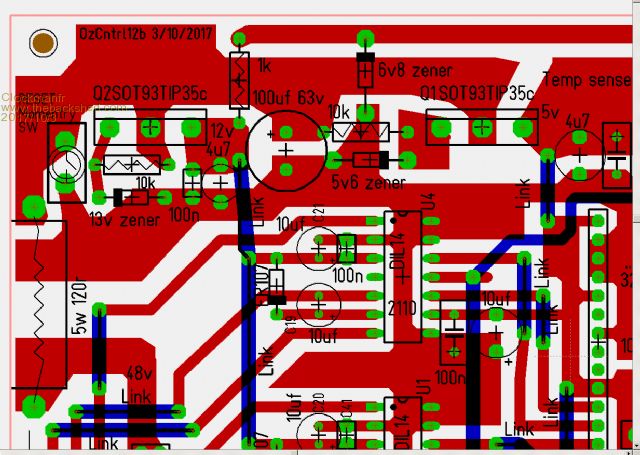

Hi Oztules, Reset momentary, .... something like this.
I think I have the right end of the 120r? 50/50 chance haha.

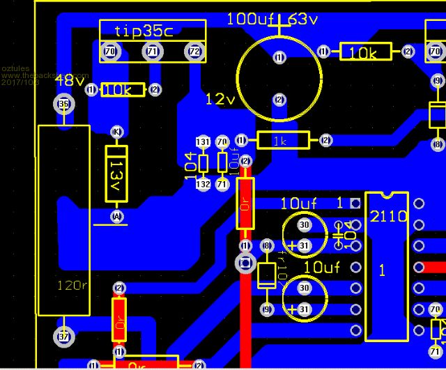

Posted: 10:12pm 02 Oct 2017
No Clockman... the 5w one on the input rail
If you look at pin labelled as 36, it is there I short to ground momentarily. It's a bit rough and ready, but gee it's effective.
Do NOT do it from 37.... thats a direct short to ground... not a good look.
It restarts immediately, but a very soft start is assured. It stops it hanging from slow charge up ( what I mostly use it for ) but also recovers from over current conditions perfectly. Even if you press it while running 6kw..... no problem, just restarts and drives the 6kw load as it comes on. It really is neat.
"I think I have the right end of the 120r? 50/50 chance haha."... not quite in the same post code... so no cigar
..........oztulesEdited by oztules 2017-10-04

oh crikey, totally wrong 120r.
I did wonder, why not on the 48v input, then as you say the 8010 takes some abuse, but not that much.
Okay, will add a small board mounted momentary switch at that pin 36 area.
Nice to have, That's if you think its worth the hassle?

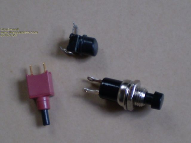

Clockman.... ... not really.....it is best to have a press button on the external surface of the box. Mine is under the unit ( wall hung ), so is not obvious, but easily available. This allows easy soft cap charge, and simple reset to start after that.
Ideally, you would have a two pin connector on the board..... I just solder a few wires on at the moment.
Once running will never be needed again, unless you overload extremely, then you want..... a reset button .
No Warp, it is not even remotely worthwhile complicating a simple system. A push button is all thats needed, and all the folks who have these things over here, probably don't know the switch is even there ( it is labeled as reset on bottom), but it will never probably be be required. The on/off is also on the bottom, but who wants to turn off their power ( other than experimenters)
Hanging is only probable if you don't want to splat the terminals on installation. After that, it is not likely to ever be required again except for current reset. In normal installations, the batteries are not disconnected again until refit.... once again a reset button is all thats needed.

Okay Oztules have amended latest board.
As you can see it gives the option of on the board Switch. keeps my little rascals from messing if its inside, or a 3 pin molex connector, just snip of the canter leg on the male molex pins.
Got lots of different small momentary switches.
