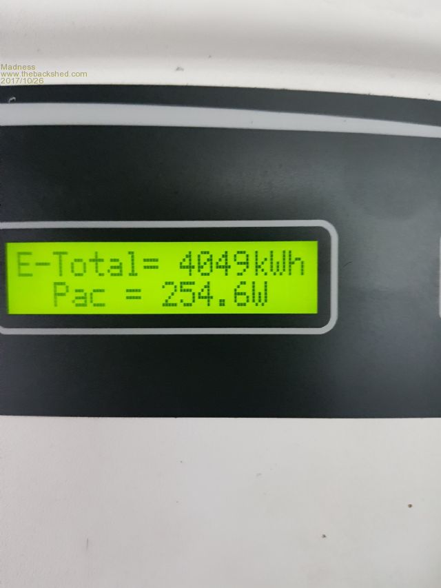

Had some brief periods of light cloud today and yesterday, this caused the off grid inverter to trip with overload. I have kept the setting quite low as I am running the OGI via a 100A breaker ATM till a bigger one arrives, I have increased it a little to prevent it tripping like that again. Also I changed the choke to a ring type with 3 turns on it today and that almost completely eliminated the small spikes on the waveform.
I did see it running today with the Aerosharp GTI in equilibrium with the house load, the wave was clean and smooth but at first I thought my contact lenses were playing up as I saw double. It had one wave just slightly offset with the other, just enough to give a very small gap between the 2. It did not seem to cause any fuss, if anything is a bit off in the waveform you can hear it in the Toroid, but it was just humming very softly.
There was a couple short periods where the regulation was kicking in but only briefly as I also had the hot water system on. Forecast is for some sun tomorrow and then back to rain again, anyone would think it is Melbourne.

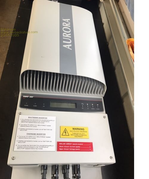

Bought this Aurora 5KW GTI today for not much money, has RISO LOW Error. After googling the error before buying it found lots of search results where it is a ground fault in the PV array or cables. It will not operate with less than 1 Megaohm to ground. However when I got it home and tried it the reading on the display is 0.00 M ohms. I removed the MOV's which a couple of them showed 0.3 M ohm, but without them installed still shows 0.00.
Has anyone else had on of these do the same?

Posted: 10:50pm 24 Oct 2017
you could hook it through a galvanically isolated transformer and it should run if the inverter itself is not faulty.
if the megohm meter is not reading anything it seems to suggest it is badly leaking to earth inside the inverter or the meter is not working. I have sent a couple of out of warranty ABB inverters back for repairs for a different fault, it cost about $300 to get them fixed by the company but that is a couple of years ago, things might have changed.
I think the inverters earth strap has to be installed before the complete DC circuit can be tested for leakage with a megger. maybe there is a poor earth to that board.Edited by yahoo2 2017-10-26

I have only had a very quick look at it so far, I think the fault is somewhere past the DC input relays.
I was testing with it connected to the grid with earth connected, I am very wary of connecting GTI's to my off grid inverter after the recent episode I had that killed several PCB's.

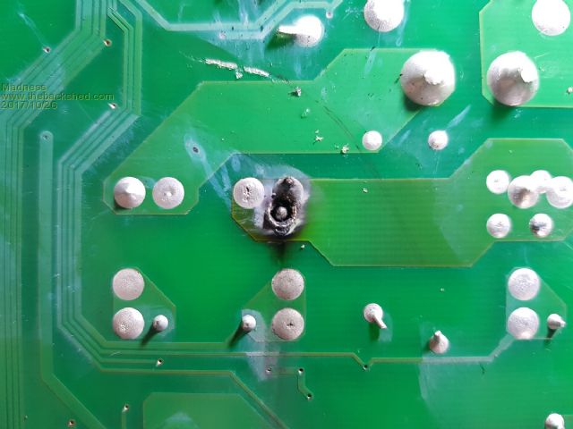

Update
Got the PCB out, there is a burnt connection on an AC relay, I repaired this but still no improvement looks like it might be going in the too hard basket.
