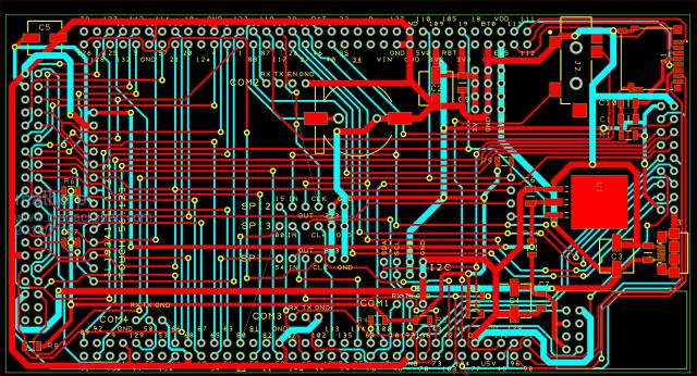

Daughter board ideas.
Grouped connections for SPI, I2C & COM ports, power as well. This way it's easier to add other types of serial boards and SPI devices.
For power maybe 2 rows of 10 pads, ground and 3v3.
Or/and add extra 35x2 connector pads, top and bottom, labeled for ad-hock wire connections. Or all the other pins that aren't SPI, I2C or Com?
A free pad area square for miscellaneous parts. Group by 2 pads with a route in between. Example:
O-OO-O
O-OO-O
O-OO-O
O-OO-O

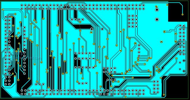

I've tried to incorporate the various suggestions for a daughter board. Here is the routed version and a view of the bottom showing the ground plane fill

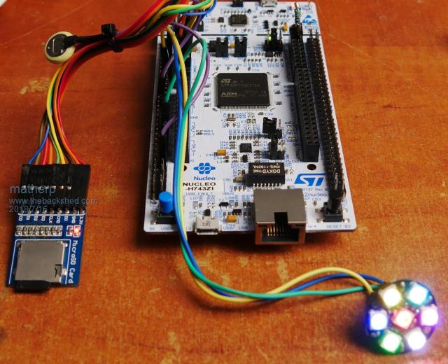

This version also includes a new command
WS2812 pinno, array_of_colours%()
This sends the correct pulses to light WS2812 leds. The array should be of the exact length of the number of LEDs. The pin needs to be set as an output.
So my test program for 7 LEDs is
Option explicit
option default NONE
dim b%(6)=(rgb(red), rgb(green), rgb(blue), rgb(Yellow), rgb(cyan), rgb(magenta), rgb(white))
setpin 1,dout
ws2812 1,b%()
Edited by matherp 2018-07-18

Posts: 11964
Posted: 05:39pm 16 Jul 2018
  Quote  What did you do?
The HAL definition for the F7 has one 32-bit register for the GPIO BSRR. Setting a bit in the top 16 bits sets the output to 0. Setting a pin in the bottom 16 bits sets the output to 1.
The H7 HAL has split this into two registers BSRRL and BSRRH and BSRR is no longer defined at all so making code conversion just a little harder
Now you might think that setting BSRRL (L=low?) clears the output and BSRRH (H=high?) sets the output - that would make sense to me but no.......
BSRRH means the high 16 bits which set the output to 0.
I'll post another update in a few mins that speeds up 8-bit as I hacked both versions to slow
