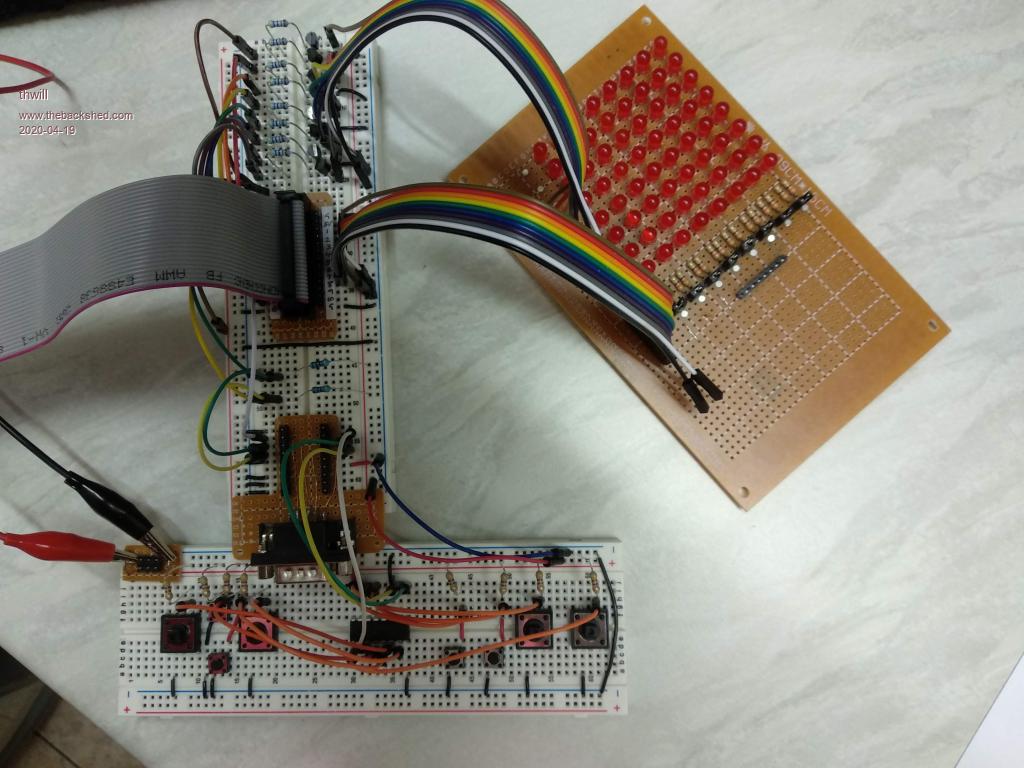

Latest update:
Well it didn't take long to knock up an "NES controller" on solderless breadboard and it worked first time!
Using 4k7 pull-ups throughout:
- It works with open collector and 5V Vcc, CLOCK and LATCH
- It works with open collector 3.3V Vcc, CLOCK and LATCH
- It works with normal digital output 3.3V Vcc, CLOCK and LATCH
I just hope I didn't fritz anything on my MM when I briefly had a 5V DATA line connected to a non-5V tolerant pin ... seems to be OK.
Glamour shot for posterity:
(Note that in the above the DB9 isn't connected, but its breakout board is connecting the lines across the central divide.)
As a sanity check I then attached the Famiclone controller and as previously reported it requires 1k pull-ups on CLOCK and LATCH to work.
I guess the only thing left would be to attach flying leads from the inside of the Famiclone controller to my breadboard "NES controller" and eliminate the lead as the problem ... I'm not sure I can be bothered going to the trouble.

  Quote  How would you feel it it was the cable after all this?
Because as it turns out IT IS THE CABLE.
I completely unsoldered the cable from the Famiclone controller and used it instead of the fly leads to connect the breadboard NES controller to the MM breadboard. The end result is a very similar error to that originally observed. With a 4k7 pull-up on the LATCH button A reads, and all other buttons read as RIGHT (bit 7) instead of not reading at all. Change to a 1k pull-up and it works fine.
It then occurred to me that my homemade DB-9 breakout board might be at fault, so I wired a female DB-9 connector to the breadboard NES controller with 4 cm fly leads and plugged it into the MM breadboard via the DB-9 breakout board. i.e. I replaced the cable with short fly leads but kept everything else the same. It worked just fine.
I think that means I've narrowed the cause of the problem down to the 5-core cable (or its molded female DB-9), not something I have a spare of. Does that give anyone a eureka moment as to why it works with normal digital input and not with an open collector?
Ultimately I put the Famiclone controller back together and tested it again and it still doesn't work with an open-collector CLOCK ... I had worried for a moment at about midday whether the whole problem might be down to 20 year old solder joints in the Famiclone controller and I had been wasting everybody's time with this little mystery, but it turns out not - phew!
