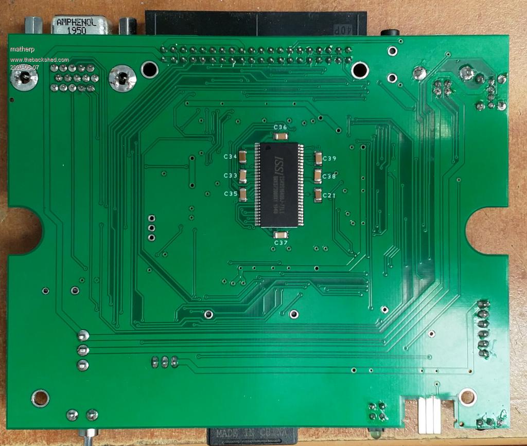

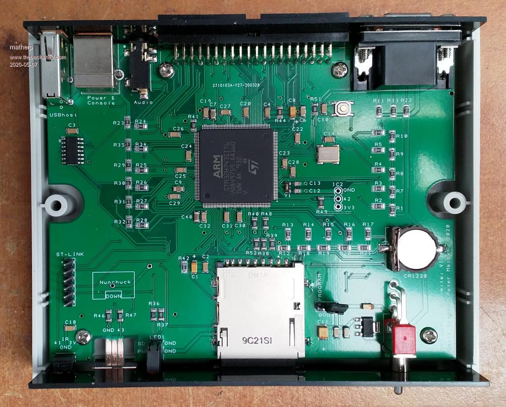

Posts: 12173
Posted: 07:09am 07 May 2020
  Quote  - would it be possible to add the 40 pin GPIO pin numbers?
I've done a single PCB version of the CMM2
This is the complete schematic
Motherboard - Project.pdf
There are also the gerbers, BOM and component placement files needed to get them manufactured by JLC. This is very cost effective but unfortunately they are currently out of stock of the processor which makes them manufacturing them rather pointless. They can only do surface mount on one side so you still have do solder the SDRAM and some capacitors on the bottom together with the various through-hole components.
The board can be hand-soldered if you are very confident with SMD. I've done 3 and WhiteWizzard has also completed one.
Edited 2020-05-07 17:14 by matherp
