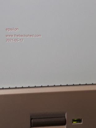

In the meantime I ran into another issue: I was experimenting with palette animation and noticed some flickering artifacts at the bottom of the screen:
Those evenly spaced dots at the bottom of the screen shouldn't be there, and they're flickering.
Here's some sample code to recreate the issue:
OPTION EXPLICIT
OPTION DEFAULT NONE
OPTION BASE 0
MODE 7,8
DIM ii%, jj%
DO
 FOR ii%=0 TO 255
   FOR jj%=0 TO 255
     MAP(jj%) = RGB(ii%,ii%,ii%)
   NEXT jj%
   MAP SET
 NEXT ii%
LOOP
END
This is 320x240 but I'm also seeing it with other screen resolutions.
The flickering dots appear on the last scanline, i.e. MM.VRES-1.
The manual says MAP SET takes effect during the frame blanking interval. Is it possible it starts one scan line too soon?
Epsilon CMM2 projects
Posts: 12176
Posted: 08:26am 12 May 2021
  Quote  The manual says MAP SET takes effect during the frame blanking interval. Is it possible it starts one scan line too soon?
Perfect diagnosis - will fix in next beta
