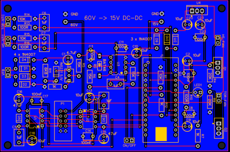

Posted: 12:26am 03 May 2021
Nicks: I reworked the picoverter PCB in accordance with your guidelines.
It made it a lot easier as things got more complex.
Also I think the board looks far less messy.
0.3mm tracks is more sensible too.

Joined: 02/02/2017
Posts: 1515
Posted: 04:12am 04 May 2021
Mike, latest schematic and pcb.
I completely overlooked the Battery voltage sample and filter which will be
needed for LV cut-off. So that's added too.
Schematic_picoverter_2021-05-04.pdf
PCB_PCB_picoverter 5_2021-05-04(1).pdf
How can I check this with fresh eyes? what is the secret?
turn it upside down or reverse left to right and then have yet another
look?
wiseguy
Joined: 21/06/2018
Posts: 1338
Posted: 06:14am 04 May 2021
look?
When I learnt PCB design, you either got a colleague to check your work or you get the PCB back with faults that annoy the crap out of you. With the cost & cycle time that we used to incur it taught you rather quickly to check and recheck. Then I started with a commercial company with deeper pockets, the engineering manager had a mantra of "if you got the PCB back with no errors you spent too much bloody time checking it". He believed there was always going to be something wrong or an unforeseen issue, or an addition of something to make it better, so get your prototype back fast get the bugs etc out of it and then send out a more serious version with most/all bugs ironed out.
Today, cycle times and cost are quite minor so the penalty for a mistake is relatively small. I cant see any drastic issues with the PCB or the schematic. You have a generous number of vias and track side changes that a lot could easily be eliminated but it is probably my old school thinking and of minor consequence.
What I would try to fix is the tracks that do not enter the component pad at right angles. The creation of sharp angles (less than 90) should be avoided if possible. I'm not familiar with EDA but usually when you set up a snap grid of 25mil and use "hotspot" connect, these off centre exits shouldn't occur ? I was always taught to not use 90 degree changes of direction when running tracks, and use slanting lines (like you have in some areas) again probably old school thinking.
Other than that it looks good to go.
Cheers Mike

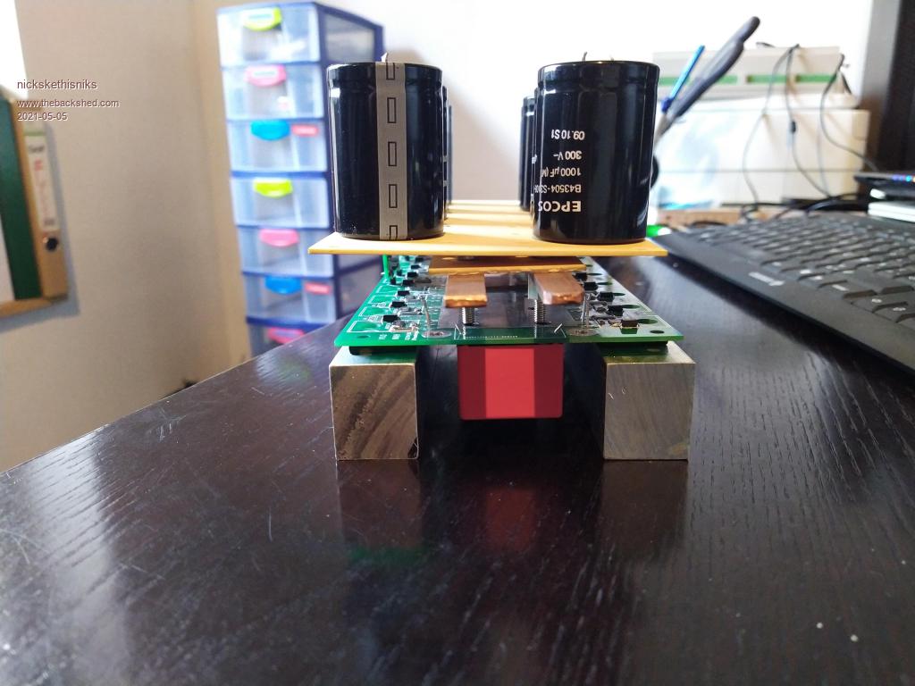

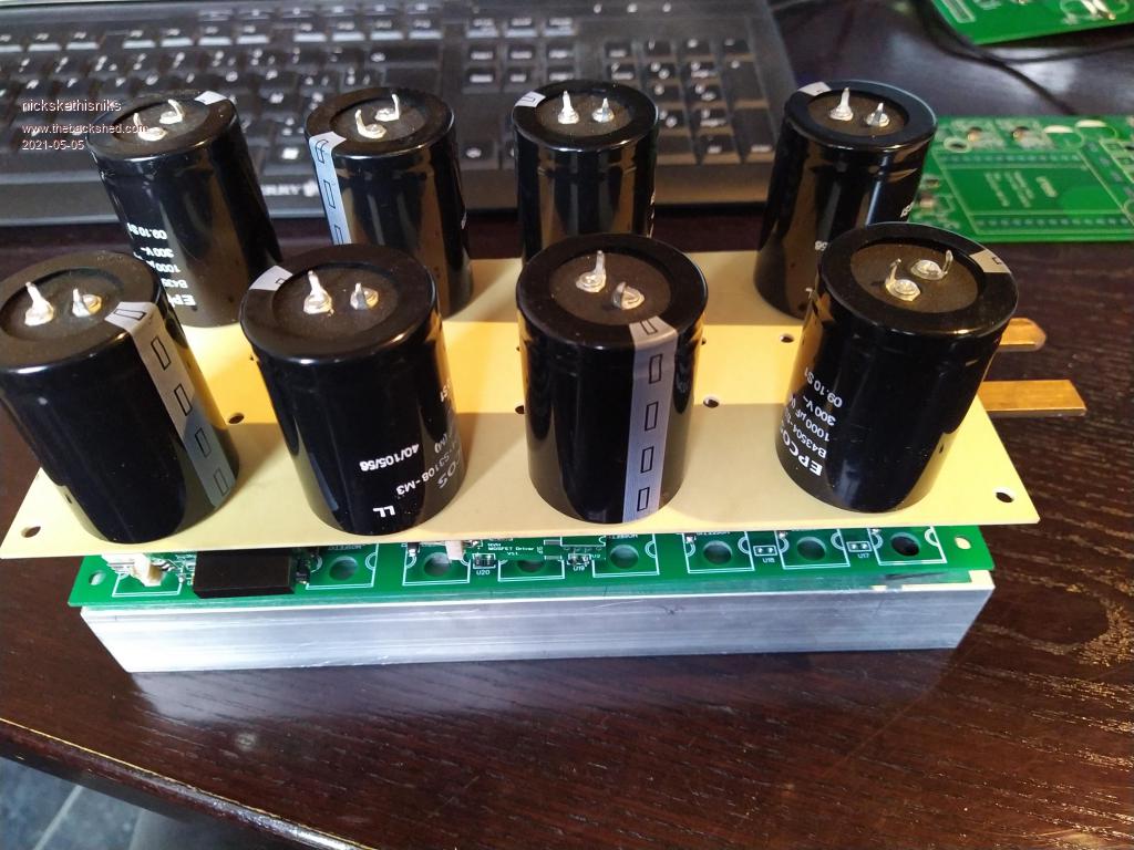

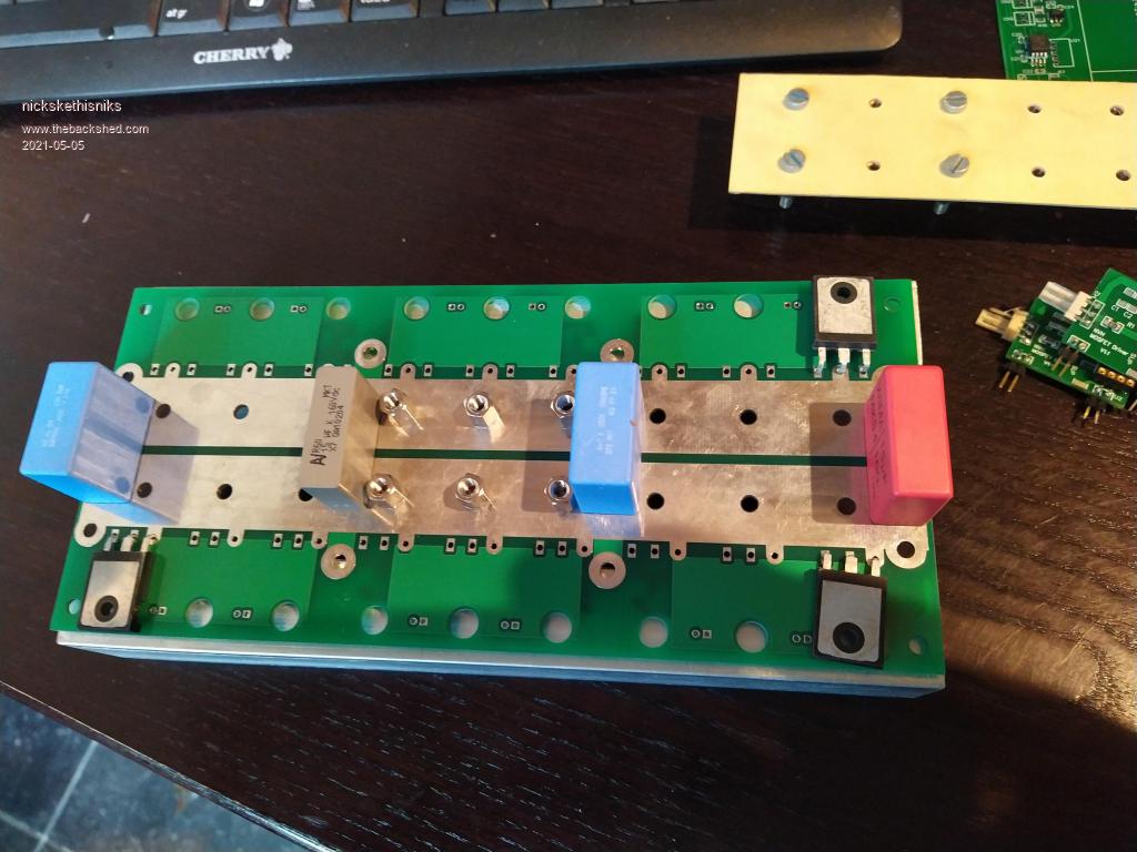

nickskethisniks
Joined: 17/10/2017
Location: Belgium
Posts: 499

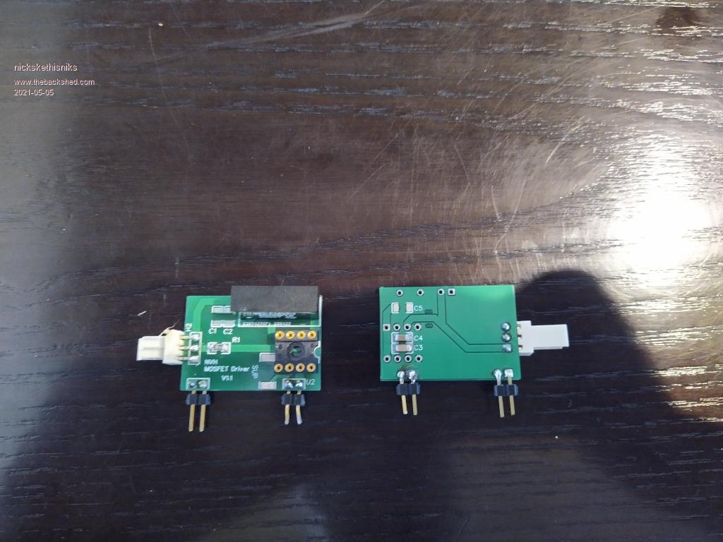

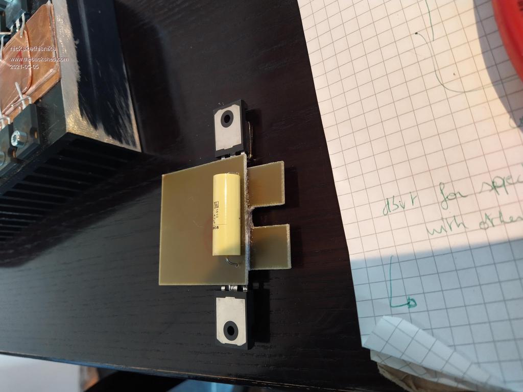

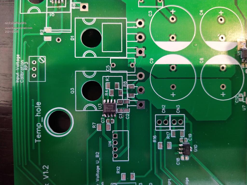

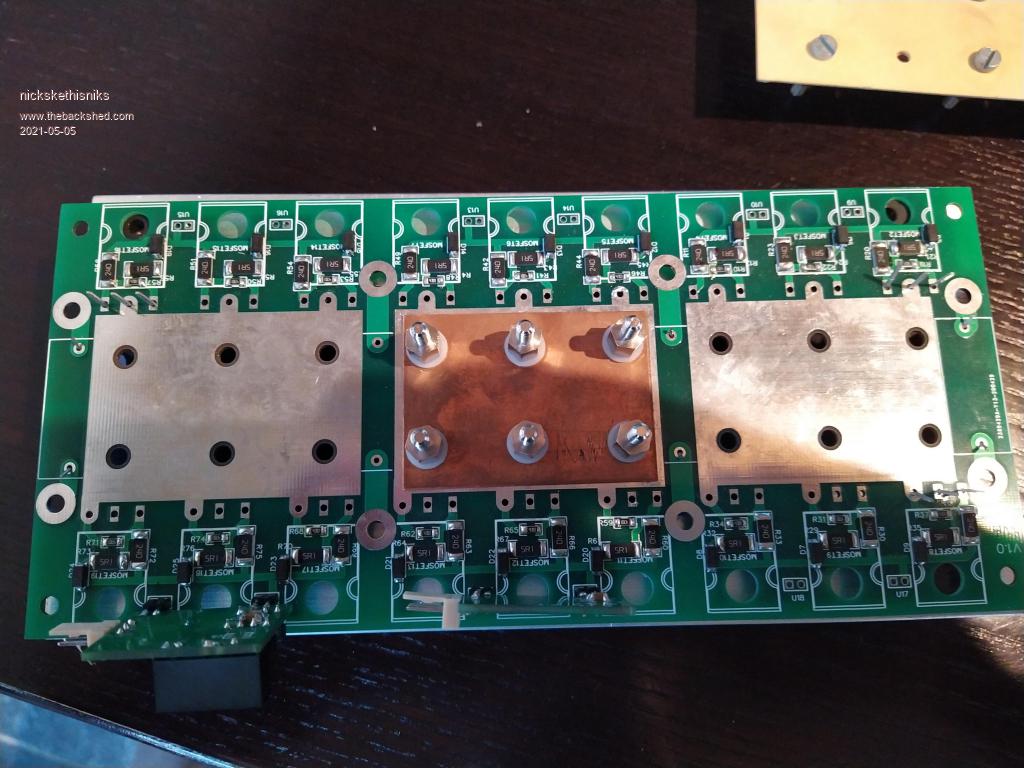

Posted: 09:17am 04 May 2021
I'm so glad you guys think the same about those "minor" mistakes.
Ok, first of all, excuse me if my English is not coming thru the way I actually want/think and so could misinterpreted, but I don't really want to use it as an excuse, this is the only place to practice my English. With 1000 pages I actually meant it's something interesting to discuss, the longer topics are mostly the interesting ones.
What I meant with higher energy is not so the energy needed from the power supply, but the energy needed to charge the gate to make the mosfet turn on or off. When you use a negative bias to hold the mosfet off, you will need to supply more energy to the gate to get the mosfet in on state again. Because you need to go from -5V to +/-4V to have the mosfet turned on, so it will take longer compared to going from 0V to 4V. Unless you use a different gate resistor. The same goes for 15V, if your gate is at 15V, it will take longer (compared to 12V) to have the mosfet in off state again. Of course that's only true if you keep using the same resistors.  It's just something to keep in mind.
In the last years there were a lot of designs created and a lot of new components and pcb layouts were introduced and used. We are at the stage where it gets very challenging for me to improve things without just copying things from others with consequences.  So more time spend on application notes, but also a bit of analyzing other pcb designs, wondering why they did it that way. Different components, for example igbt's and mosfets with their own character/catches, low and higher frequency stuff. Things are not so interchangeable anymore, if this weren't the case already.
I had a lot to read up, so I will try to give some interesting input.
If you have time to read this, it's an interesting discussion about the importance of a low inductance stage and as Wiseguy suggested, paralleling (with series inductor) different power stages to run 1 load, transformer, motor,.. is something discussed as well.
Link
I love this forum, but I sometimes go to the suggested forum, you can find a lot of discussion about (motor) inverter/pcb designs.

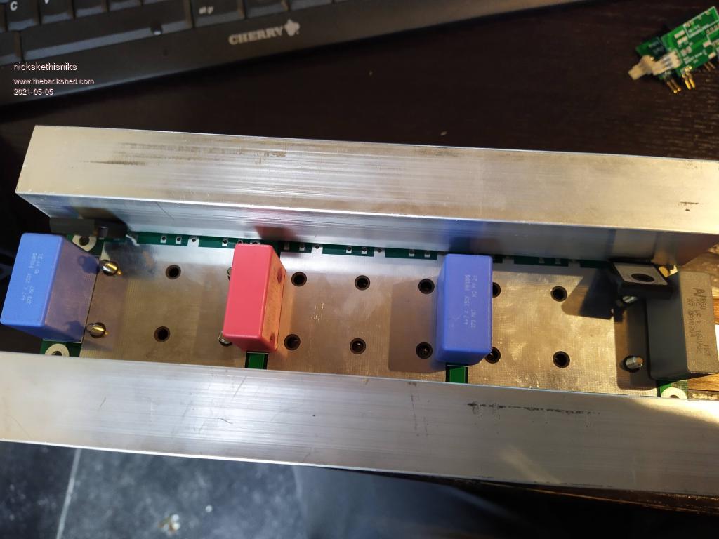

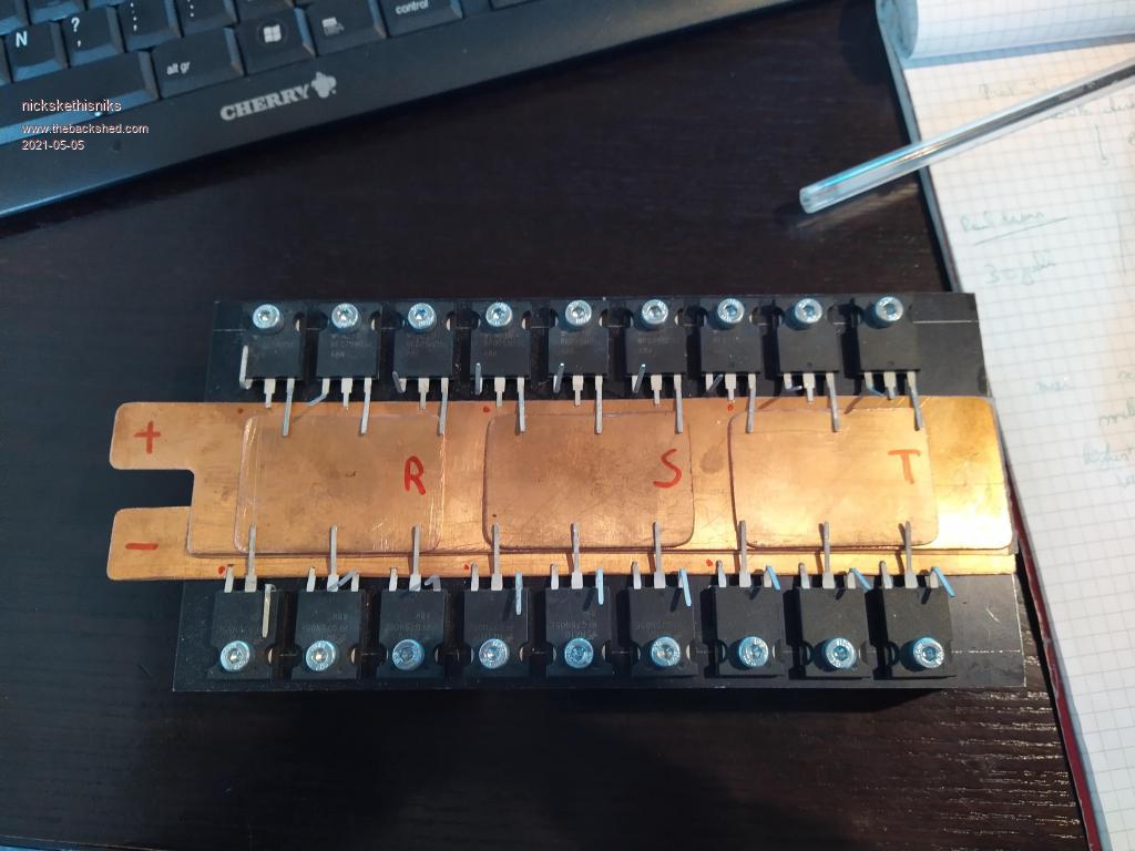

Another approach is having multiple synchronized power stages each with its transformer, and then connecting the secondaries in series. A bit like those cheap HF inverters stepping up the input voltage to a 350VDC bus. But then you come close to the warpverter topology.
Wiseguy you are totally right, I think I'm sometimes a bit fanatic if I'm discovering new insights, and sometimes it's just not necessary for example keeping the gate driver as close as possible to the mosfets. The ozzinverter/madpower board proves they don't need it, time will tell. You make very good arguments about the importance about those last nanoseconds, it all doesn't matter when di/dt is slow enough.
The Mad power board in combination with the nanoverter is probably the best choice for people that just need a proven design that works when finished. With tht components and simple mechanical structure. That is ok.
For me it's important to evolve to perfection although it's not really necessary, for example I want my inverter to start up automatically and displaying the fault or startup sequence . So my wife could use it when needed. That involves some pre charge circuit and output relais, something I want to implement this year, probably (hopefully) used ones in a lifetime.
Probably the same story with dedicated turn on/off resistors, it works like it is, so why changing, so sorry if sometimes I'm to pushy about something.
Wiseguy did a very beautiful compact layout with the nano power inverter, roll your own style. But I have a small problem with the gatedrive routing, it's running parallel to the battery busbar wich carries a lot of current. This is probably not an issue for his design parameters but when used under verry high load, you can have inductive coupling on the gatewires and potentially cause problems. There is also no separate return path either which is not ideally. But the area between the gate and return path is low, important to make no antenna.
Also the resistive path of the power conductors is not symmetric, the inner fets will have a higher current to carry because they are placed closest to the battery and AC terminals. The mosfets on the outside will carry less current. But then again perfectly for his design parameters. This could be easily solved when the ac output terminals were replaced to the outside of the board, this would create an equally path for each mosfet. Sometimes it's just not possible and designing is also looking for a trade of between different things.
Wiseguy I hope I didn't offend you.

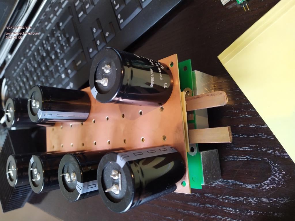

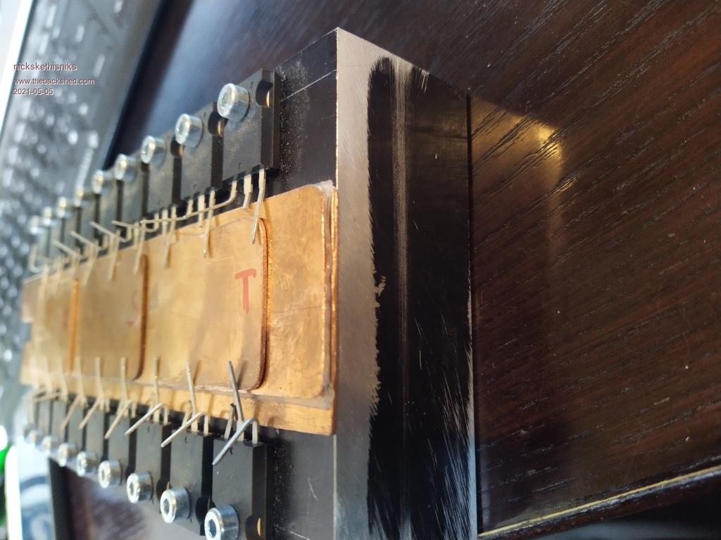

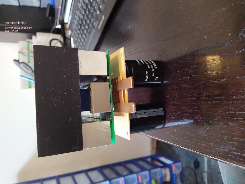

First were some designs I was playing with for a laminated busbar, caps with the right dimension could be placed under the busbar, if the mosfets were placed on an aluminium bar to allow space, like in a design further in this message. The copper could be glued with some solar eva foil, possible creepage issues when voltage to high. You can see a layer of EVA between the + and - plate. Not yet under the AC copper plate. Electrolytics could be placed on the input, compensating the wire between the battery and inverter, the pp should only be there to compensate the pcb inductance?
It's also possible with pcb material.
Then I wanted to make a pcb, but I made the mechanical part somewhat complex, if I just had swapped the AC side with the batteryside, it would've been so much easier.
I would like to develop a version with mosfets on the other side of the board. It's already some time ago but here are some examples I was (wanted) playing with. So in the meantime there are things to improve. I'm still searching, maybe we can find something togheter.
The same board but the fets on top:
This was the little driverboard: maybe that ground plane is not necessary, a separate driver board gives some space on the board itself, placed under 90degree with the power tracks should make it more immune against noise. And makes experimenting easy.
You can easily fit an totem pole drive on such a pcb.
Peter this is maybe how you could place the mosfetdriver, I could've used smaller resistors.
Edited 2021-05-05 01:10 by nickskethisniks

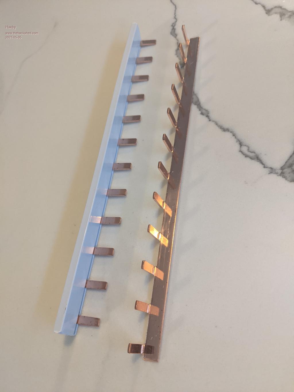

Haxby
Joined: 07/07/2008
Posts: 427
Posted: 09:53pm 04 May 2021
Good to see lots of people tackling the same problems in different ways. And it's good to see higher power automotive designs where all the nuances are amplified.
The Chinese boards use a piece of copper dipped in solder to create a PCB based bus bar. I tried that approach on my boards but wasn't very happy with it. Looks messy.
I like your stacked busbar design nickskethisniks.
If we design a board for other members to recreate, maybe basing the busbars on easy to get materials could be a focus.
I picked up some bus bars that are commonly available world-wide in the electrical trade.
These copper pre-cut and bent bars are marketed to connect multiples of single DIN rail modules (breakers) together quickly instead of wires.
They are rated at 63A for that purpose.
I'm contemplating a redesign of my power board to use these busbars and maybe others here could consider them to fortify their high current PCB tracks.

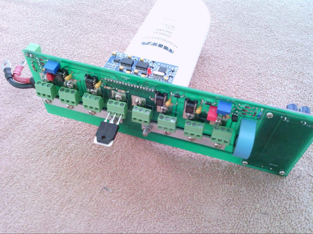

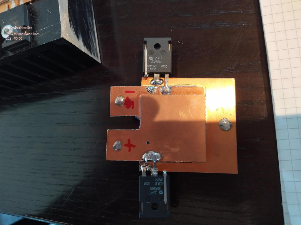

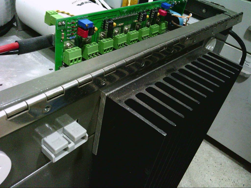

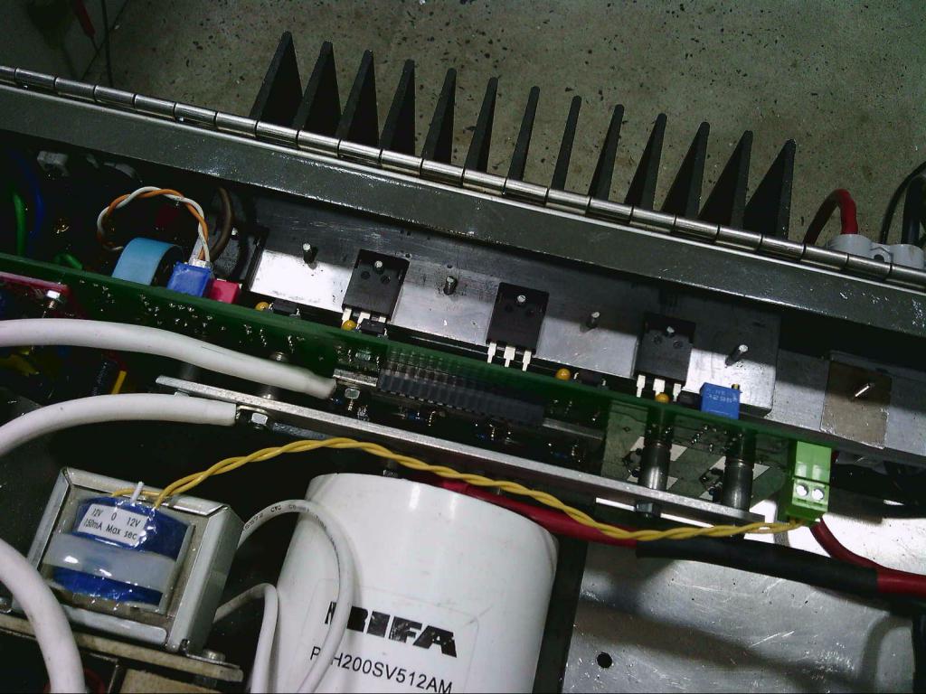

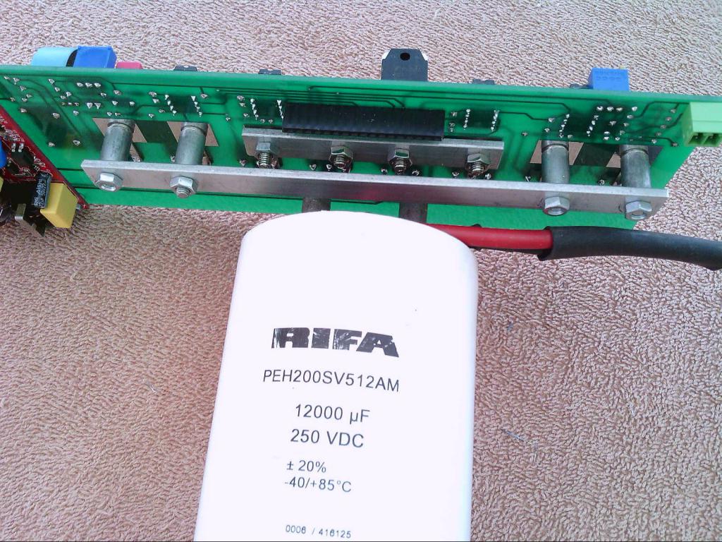

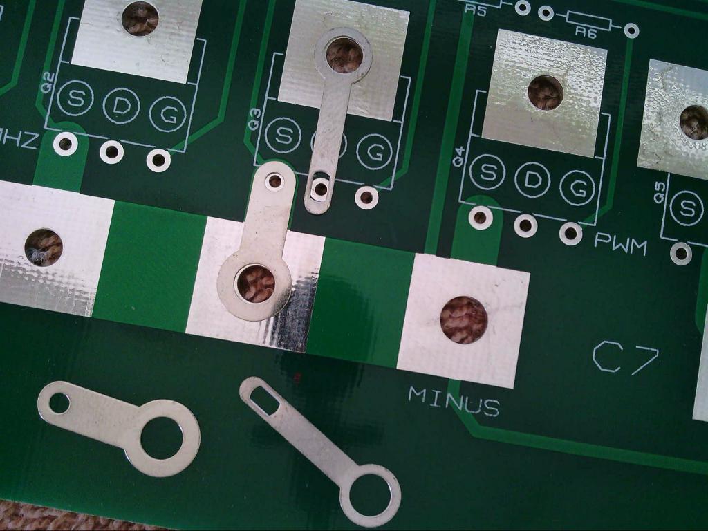

Posted: 12:00pm 08 May 2021
While we are kicking around a few ideas for hardware layout, this is the very last PWM inverter I built, just over three years ago.
Its now become a pretty dated design, in that it uses an old EGS board, but this was just a design exercise to try out a few different mechanical and thermal construction ideas.
It also uses four ten amp gate driver chips mounted up fairly close to each pair of mosfets. Each chip has short direct gate connections to each pair of mosfets in an attempt to get cleaner more direct gate drive signals as discussed in this thread.
It also bears a slight resemblance to Nicks laminated busbar idea. Not quite so neat, but it uses busbars bolted to the circuit board  to carry the heavy current.
This is the dc side with +ve and -ve busbars and the single low esr electrolytic.
The ac side busbars cross over.
Its only a one ounce board, but source and drain connections are reinforced with solder lugs, so that if it ever blows up the pcb tracks are just about indestructible
Installed in a metal enclosure with still only half the mosfets installed. The mosfets are inside, but the heatsink is outside the enclosure.
A large piece of 6mm thick L section conducts the heat to the outside heatsink. That seemed to work quite well.
I don't know if any of this is of any interest to anyone, or even relevant, but I thought it might spur a few ideas.
Solar Mike
Joined: 08/02/2015
Posts: 1255
Posted: 10:28pm 08 May 2021
Looks very professional, how well did those drivers (TC4452 comes to mind) work driving two mosfets.
Mike
Posted: 10:51pm 08 May 2021
Its not something I spent a lot of time looking at, but the gate waveforms looked fine from what I can remember.  Sorry, but I never recorded a picture of that.
