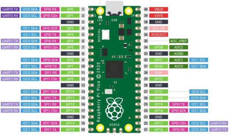

I've been away from this for a while due to health and stuff but I'm curious about the Pico
I've seen to many threads about this but I couldn't find a specific answer to this
Would it be possible to interface 2 X 7 segment displays directly to the pins on the picomite and drive them direct?
I also want a gps input which would be serial obviously
Are there any specific pins dedicated to specific functions like uart/serial input?
I can't find any specific mention of what pins are what when it comes to picomite
Nothing fancy, I just like the idea of a small double 7 segment display fed by a gps to display the speed in the car, powered by solar charged battery
Posts: 9329
Posted: 07:52pm 06 Sep 2021
You can drive displays like that, but be aware of the low current capability of the PicoMite. At most you can get 12mA sourced or sunk by a pin, but the total I/O current available is only 50mA shared between all the pins. There are no specific p1ns for 7-seg displays, but the PORT command is handy for driving the segments. You can help the current load by using a transistor/mosfet to drive the common side of the display rather than trying to source all the segments through one pin.
Serial pins are restricted. There's a fair bit of info that I compiled into the TINAM (This Is Not A Manual) document. Check out the "PicoMite V5.07.00b0 - beta firmware" thread. The latest version is 0827 on page 12. I've included info on specific pins in there.

This 6-digit HC595-driven module would probably not be too hard to control.
Do you have this pinout image:
You do have to do some work with the picomite to figure out which pins to use, which will depend on whether you roll your own or use one of the PCBs available.
Picomite on fruitoftheshed
(Link has stopped working for me with Chrome browser, but still works with Opera.)
It would also be easy to use a MCP23017 I2C port expander to directly drive 7-segment LEDs. One of the PCBs linked on the FruitOfTheShed page provides for a MCP23017.
