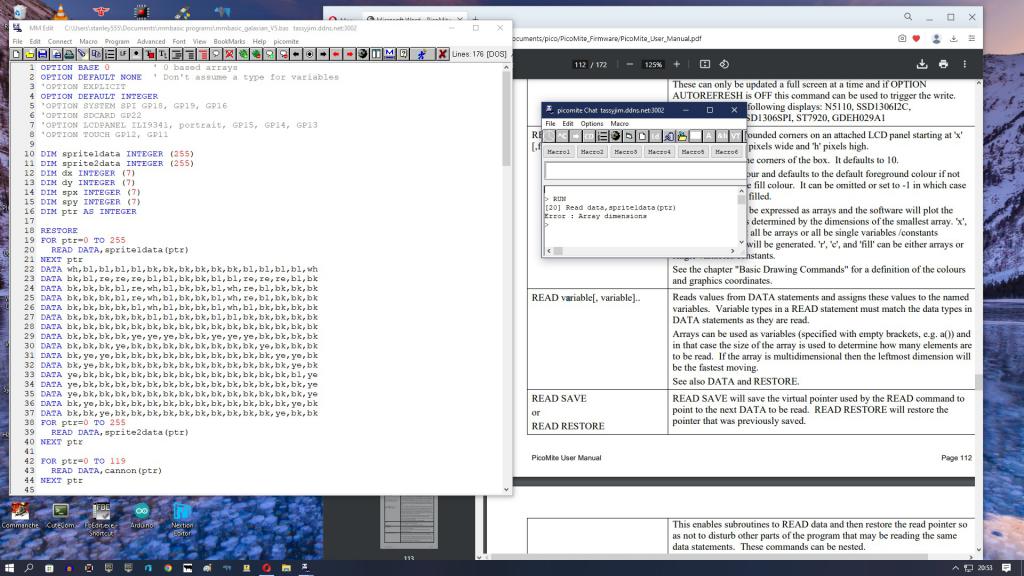

I tried running some code written in mmedit and click the running man and it saves and gives error messages which I've got to read data to array... it says - error array dimensions. I don't have a clue what's wrong.
Posts: 3891
Posted: 08:07pm 05 Aug 2022
cannon is not dimmed.
If you provide code with an error, please provide the line number of the error.
Edited 2022-08-06 06:09 by lizby

Posts: 2807
Posted: 08:50pm 05 Aug 2022
> RUN
[8] Read data,sp1(ptr)
Error : Array dimensions
OPTION BASE 0        ' 0 based arrays
OPTION DEFAULT NONE  ' Don't assume a type for variables

not a clu and amazed mmeditworked, well seems to.. running man button to save and run.
Posts: 3891
Posted: 09:02pm 05 Aug 2022
sp1 is not an array. You've defined an array named "integer".
Posts: 12270
Posted: 09:04pm 05 Aug 2022
  Quote  dim sp1 integer (255)
Read the manual for DIM. This is meaningless.

line 18 is read data,sp1(ptr)
I don't see my errors. it's annoying, hope it's not mmedit which I've not set up just clicked the running man to save and run.

Posts: 4405
Posted: 10:24pm 05 Aug 2022
It's not
READ DATA,...
but just
READ ...
Posts: 6643
Posted: 11:20pm 05 Aug 2022
If oyu insist on using MMEdit, use the help.
click in the READ word and "F1" for a short one line hint
Hold Shift while pressing F1 key and the full help for the READ command pops up.
The demo in that help should help.
