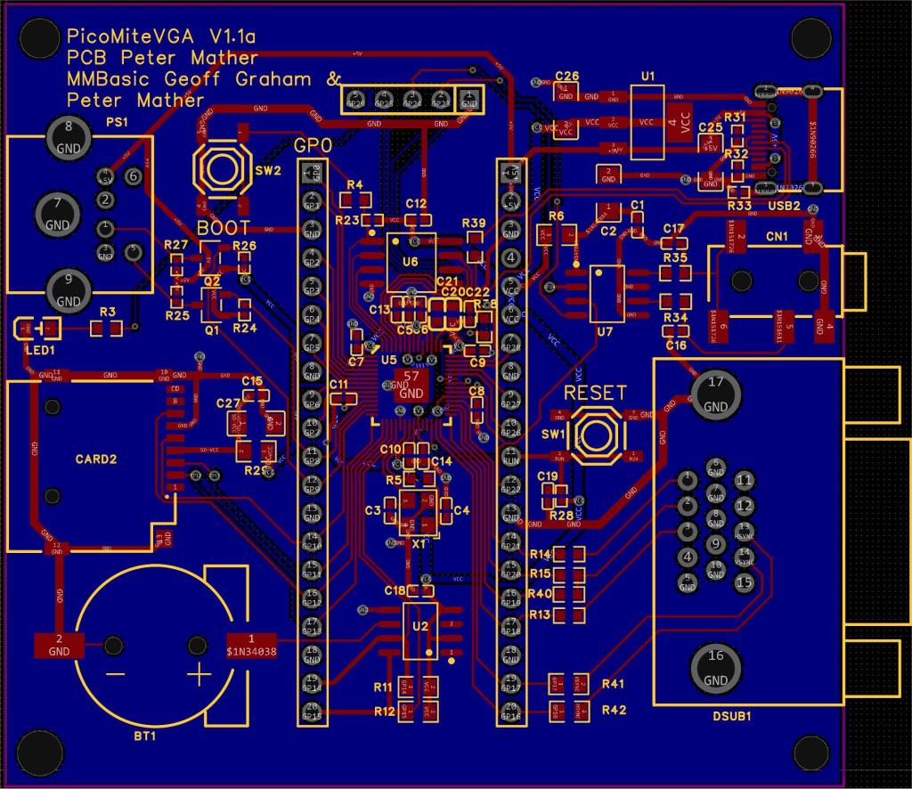

The latest versions of the gerbers etc. are here
Attached below for convenience
VGAboards.zip
V1.0a and V1.1a
V1.0a is the passive audio filter version
V1.1a uses the MCP4822 DAC
Changes from V1.0:
Fix misplaced silkscreen
Board now 75x70mm (was 75 x 67) to meet minimum 70mm width for JLC
Added 47 ohm resistors in HSync and VSync
When loading the files to JLC it is recommended to de-select headers J1, J2, and H1 to reduce cost
Edited 2023-06-15 19:43 by matherp

I just received my batch of 5 v1.0a today. All working to the point of installing version 5.07.07 running at least on serial. One tested on the VGA with overclocking to 378Mhz and sound, SD card etc working. JLCPCB were out of the DS3231 so these came without the clock chip. Price $120 USD delivered by UPS with a $10 reduction coupon. The downside is I am waiting for 5 DS3231 from LCSC for $19USD including shipping. I will have to solder them myself but it looks doable. The real downside is paying UPS another $32 CDN for their broker fee and GST. Next time take the slow boat and get it by mail.
So far I'm happy and I hope my grandson will be when I give him one to experience MMBasic. He just purchased a VIC20 with 5 K of memory so this should be a real step up for him. He has already had experience with Raspberry PI and python so he has now entered retro computing for real.
