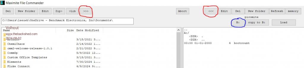

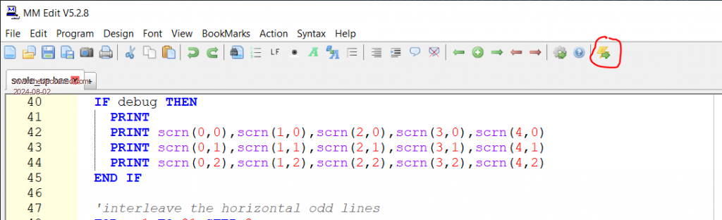

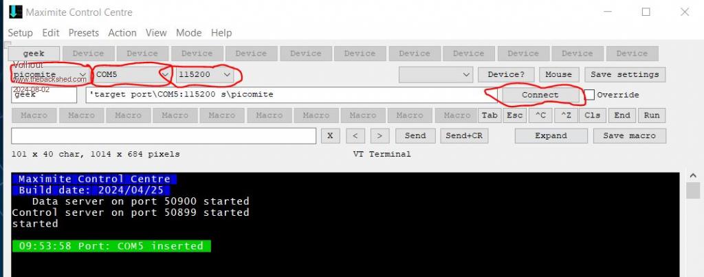

Posts: 6227
Posted: 08:05am 02 Aug 2024
Stan,
If you have either windows or linux, install MMEdit please.
MMEdit
You will be amazed what this can do. No more commands typing.
When you have installed:
- open MMCC
- select COM port
- Select PicoMiteVGA (or PicoMite)
- Press "CONNECT". In the text field a green message is shown that it is connected.
Then open the file manager
- press MODE
- select file manager
You can select files, and using the ">>>" and "<<<" buttons copy them. Change the drive with the blue button (A or B on PicoMite) Right side is the PicoMite, left side is the PC.
When done, close the file manager.
You can save the configuration with "SAVE settings". Note that my MMCC has the GEEK stored as one default.
If you want to modify or create a program you can open MMEDIT, the opening, editting and closing of files is very intuitive. To run the program on a connected PicoMite, you press the rightmost icon. And it is automatically copied to the Mite (using MMCC) and run.
Edited 2024-08-02 18:13 by Volhout
Posts: 2807
Posted: 02:38pm 02 Aug 2024
Thank you Hans,phil99,Volhout for replying.
I copied RISsound to sd card in win then B: enter on pico and got sound effects. nice.
I've always used mmedit but didn't know about mode so will retry transfer RIS to pico a:
