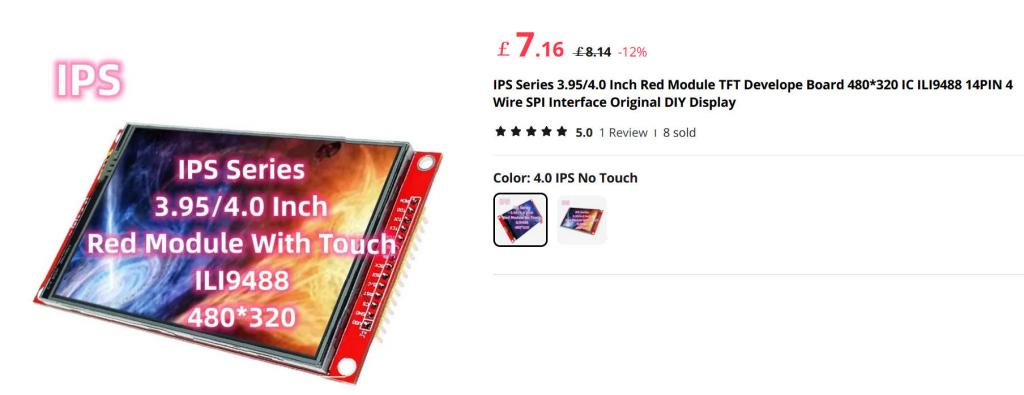

For info, I bought this display
Works nicely, very bright and clear (and cheap), but the colours are inverted. I'll put a switch in the setup command to cater for it. Also I can confirm that like all ILI9488 it needs the resistor/diode mod to be compatible with an sdcard even without a touch chip

More info on the 4" IPS panel
Just received a "standard" 4" ILI9488 and the image quality on the IPS version is MASSIVELY better. If you want a display as a console I can strongly recommend this over the standard

Hi Peter,
On your recommendation ;-) I've just ordered a touch 4" IPS, are you powering it from 5V or 3.3V? I've now got my non IPS working from a back pack, display only so far, I'm waiting for other bits, but it will become a USB console Picomite, so I might as well have the best screen for it. :-)

Posts: 2807
Posted: 04:24pm 26 Mar 2024
what's the difference between the ips 4" and "standard" 4" ili9488 please?
Posts: 9202
Posted: 06:07pm 26 Mar 2024
It's the type of LCD used. "In-Plane Switching". You get richer colours and better viewing angles.
Posts: 2807
Posted: 06:54pm 26 Mar 2024
is it a drop in replacement for standard ili9488, which has narrow viewing angle?
there's a 3.5" version with capacitive touch it says for £6 odd
Posts: 9202
Posted: 08:07pm 26 Mar 2024
The LCD is almost certainly a direct replacement, but MMBasic  doesn't support any capacitive touch chips AFAIK.
