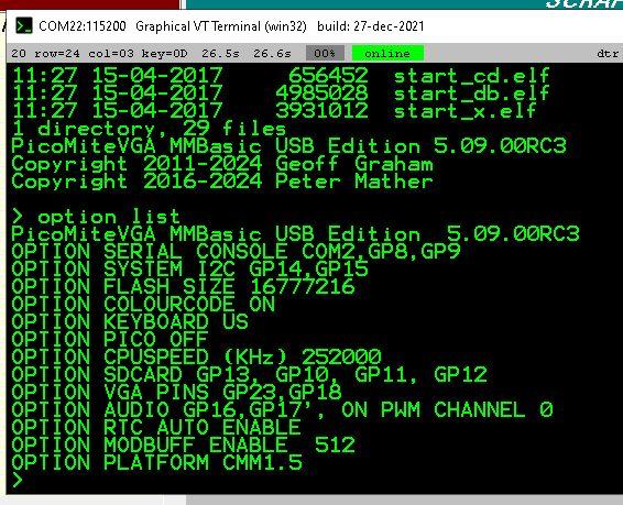

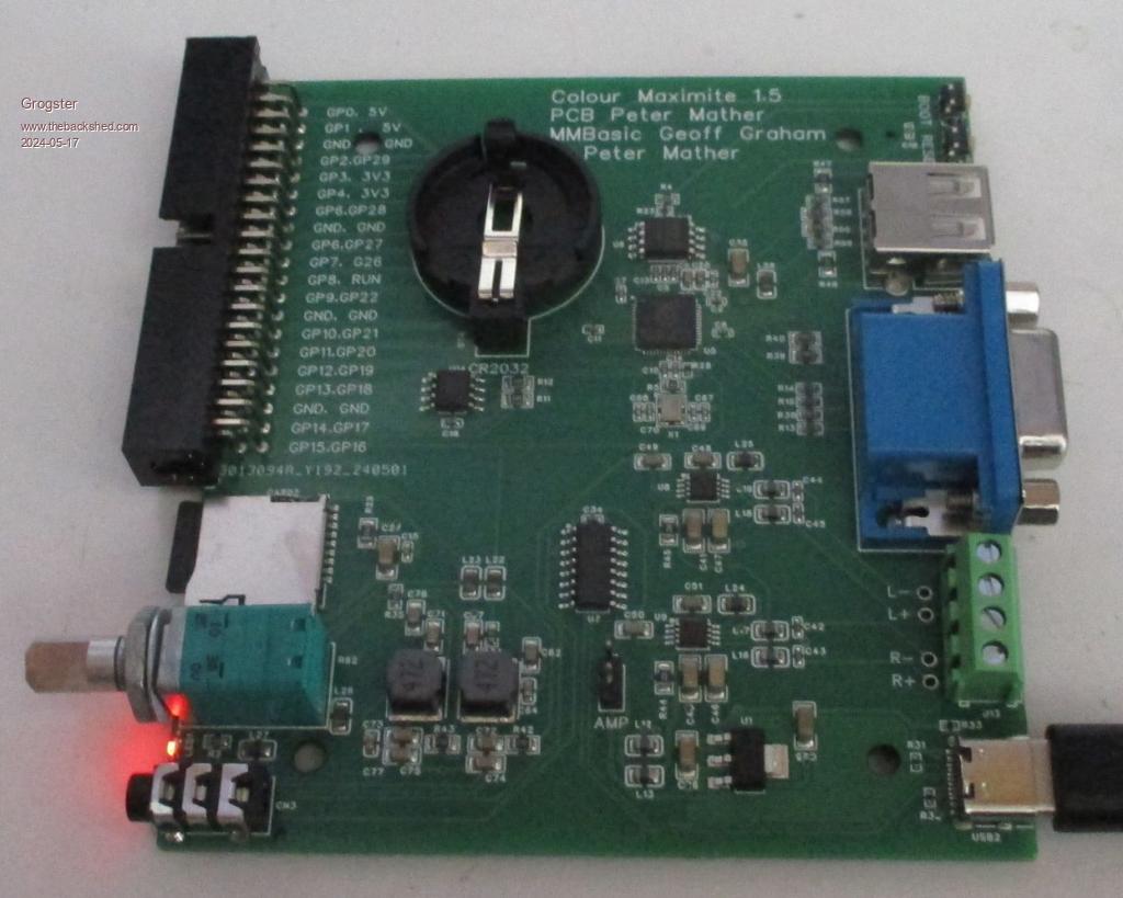

Finally got a chance to play with the boards that arrived from JLC.
I REALLY love the OPTION RESET thing, that puts all the options in for the new board.
Turns entering in all the options manually from about five minutes, to about ten seconds with just the one command.
I see jobs for this board in the future, where you need basic VGA and KB/mouse support, but don't need the advanced special features of the CMM2.
Just have to program the other four boards I got, but if it was as easy as this one.....bliss.
One thing about MMBASIC that was STARTING to niggle at me, was having to enter in all the options one by one.  Not that that was any real pain, but to have a quicker method is brilliant.
I also note we have a lovely big QSPI EEPROM chip on this unit, allowing for a large A: drive.  Very nice indeed.
I have also got the new CMM2 layout(all-in-one assembled from JLC), and I will play with them next.
Posts: 6289
Posted: 06:46am 17 May 2024
Grogster,
It is designed to go in a box, so this may be a product for you to sell also. Like the CMM2's.
I noticed you have the RTC on this board, which is not on your CMM2 builds.
Posts: 12272
Posted: 07:12am 17 May 2024
Have you tried connecting (dumb) speakers yet? I'm really pleased with the sound quality on this layout. I separated the digital and analogue grounds and put in lots of filtering and this has reduced the noise floor dramatically.
Posts: 10147
Posted: 08:20am 17 May 2024
No, but NOW your comment has made me HAVE to have a listen!
I'll post back later.
EDIT: Superb....
On the 1.5 PCB, the volume control is reversed.
IE: Once you switch on, the amps are at 100% volume.
Fully anti-clockwise is maximum volume, in other words, and fully-clockwise is minimum.  Still a pop at the end of playback, but playback is sensational audio quality wise.
I'm going back to the music now!!!!
Edited 2024-05-17 18:59 by Grogster

please could you check the gerbers you used are the same as the ones in the link. I thought I had fixed the potentiometer turning the wrong way. Should be clockwise for full volume when viewed with the pot at the front
Posts: 10147
Posted: 11:20pm 19 May 2024
Currently full-volume is anti-clockwise, minimum is fully clockwise, viewed with the pot in front.  It does not bother me, I was just curious about it.
If you have an updated gerber set, please can you upload it here, as you can now download zips from all over the forum and also Geoff's site, so I want to be sure I have the ones you are happy are the final(in terms of PCB layout), and it saves me having to hunt through threads and compare multiple downloads etc.
I can then save that in my "FINALS" folder for all these various ports of MMBASIC!
